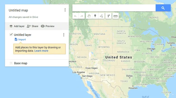

I was looking for any easy/free way to get trail coordinates on the infotainment system. With Google Maps now available on CarPlay with the iOS12 update, it is reasonably straight forward. There is probably a better way, but here's what I've done:
1. Go to Trailsoffroad.com and select your favorite trail
2. On a PC, click GPX download and save the file to your hard drive
3. Create a Google account if you do not already have one
4. In Google Maps on a PC go to the Menu -> Your places
5. Click on Maps and Create a new Map. It should look like this. (I renamed mine to Offroad trails)

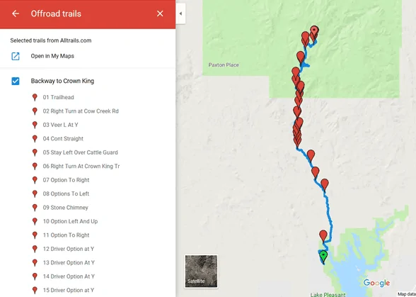

6. Click on Import and select the GFX file you saved from Trailsoffroad.com. You’ll get to something like this:
Jeep Wrangler JL GPS coordinates on Navigation System upload_2018-9-24_12-40-58

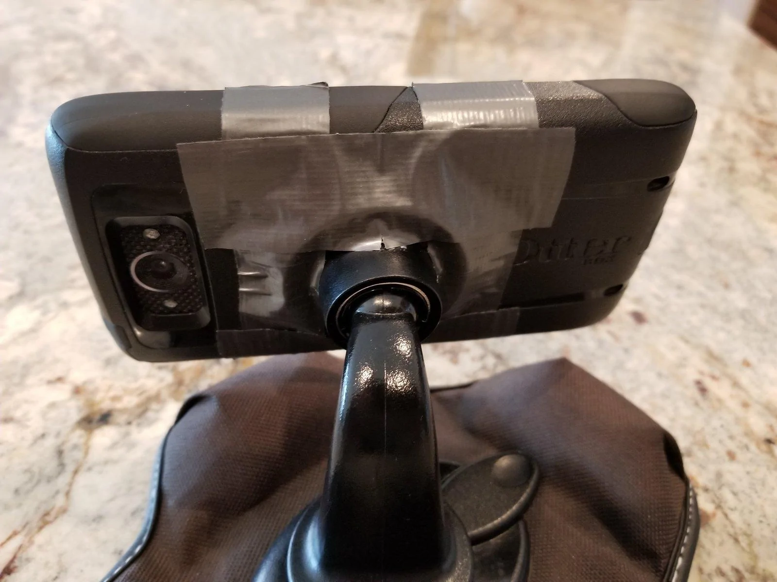

I worded "line of sight" a little poorly. What I meant is that the screen is small enough that it needs to be close to see the detail. While experimenting with it, this is the "patent pending" mounting system I'm using ... my Nuvi mount and duct tape ... it works:

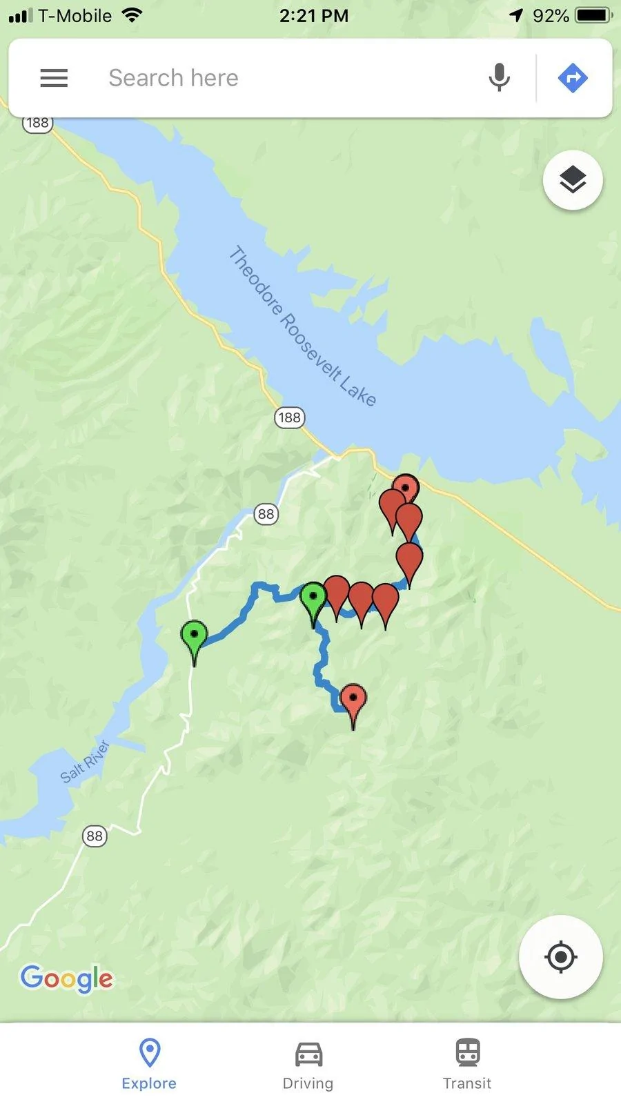

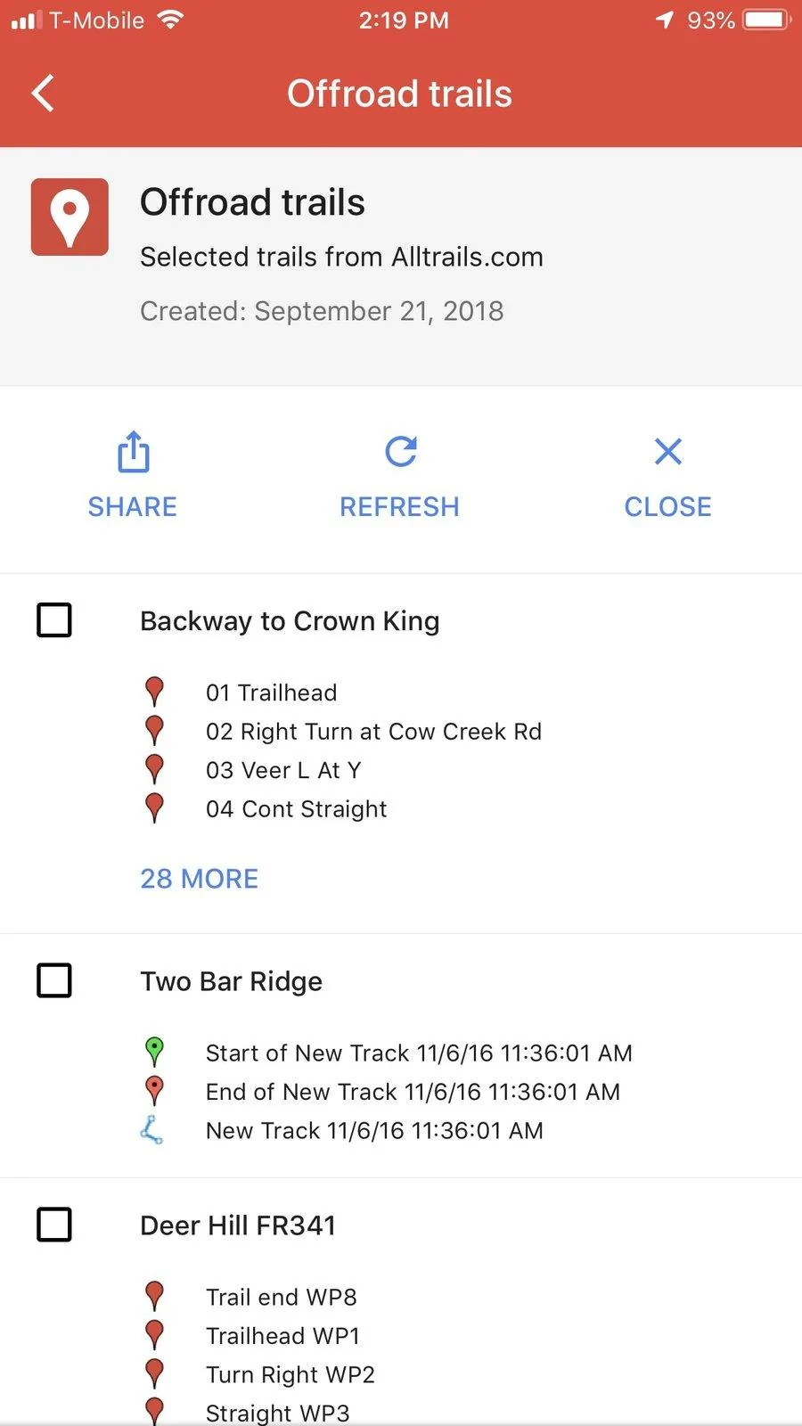

1) I couldn't get more than one imported map to show on the screen at one time. Would like not only the main trail, but a secondary trail also.
If I imported multiple files and I go to Menu -> Your places -> Maps -> My Selected Map, I get the screen below - I could then select multiple trails. 2nd image below show Two Bar Ridge and Deer Hill on the same map.
