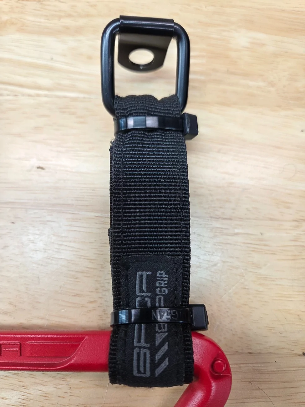

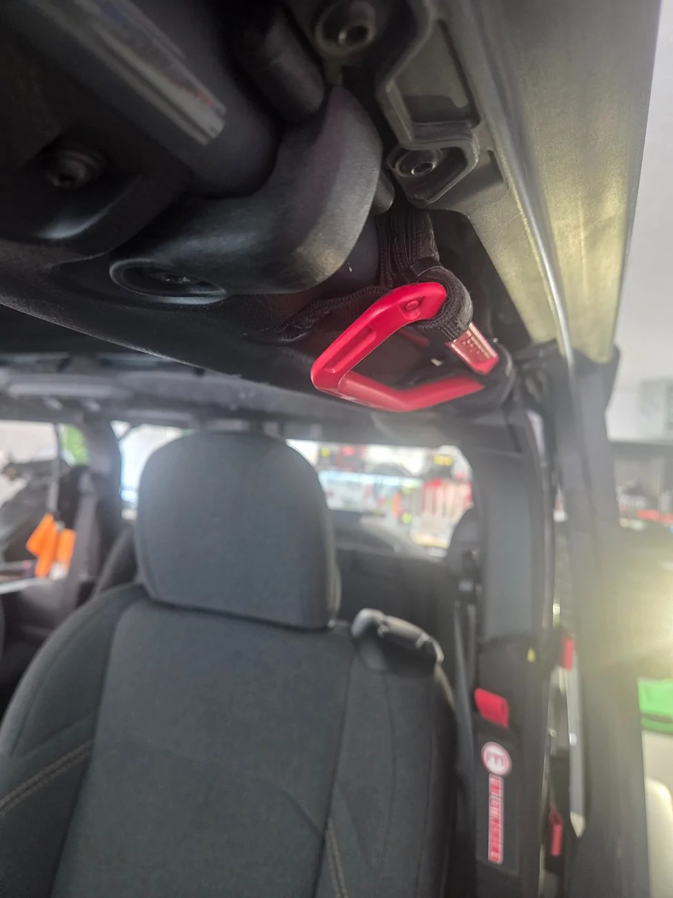

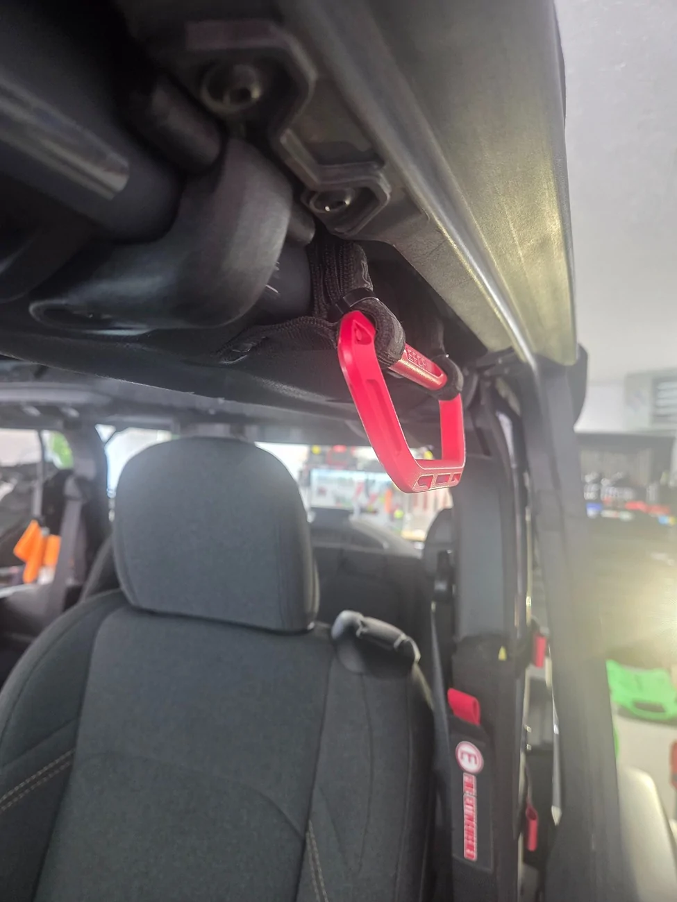

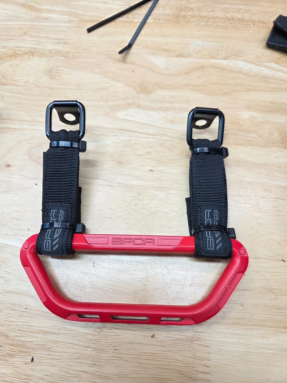

Purchased these about a year ago, installed them per the instructions. After about a week, the handle fold up feature stopped working. I adjusted and readjusted the Velcro straps 6 times over the next month, got frustrated, pulled them off and tossed them on the floor in a far corner of my shop, near the trash can. Fast forward several months and I discovered a fix that works. Zip ties, right up there with duct tape IMO. The fix works great, gald I missed the trash can. Wanted to share it with anyone else interested.
