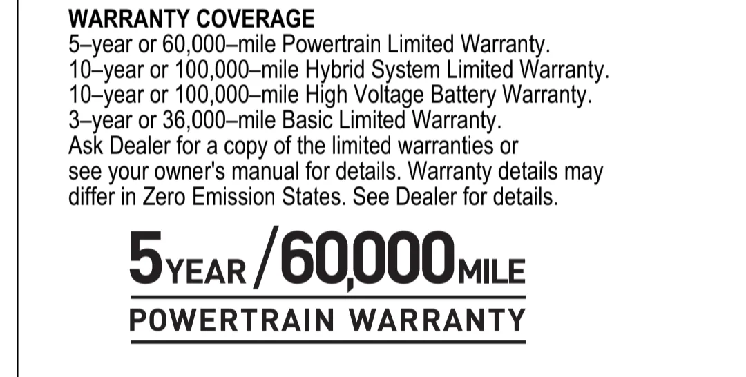

The 2022+ 4xe have a 8 year 100,000 mile high voltage warranty, the 2021 is 10 year.
3 year is bumper to bumper.
There is also a 5 year powertrain warranty, and 5 year corrosion warranty.
Sometimes the dealership might try to pull a fast one and want you to pay for πŸ’© covered under the warranty, that happened to me twice.
There was someone on the 4xe forum where the dealership had them pay $1,000+ for work that's covered under the HV warranty.
