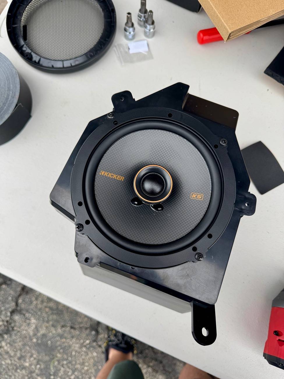

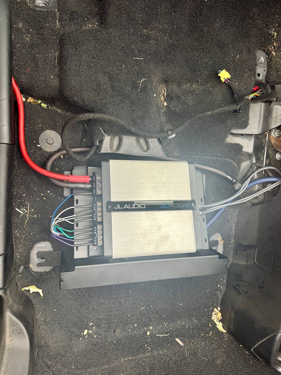

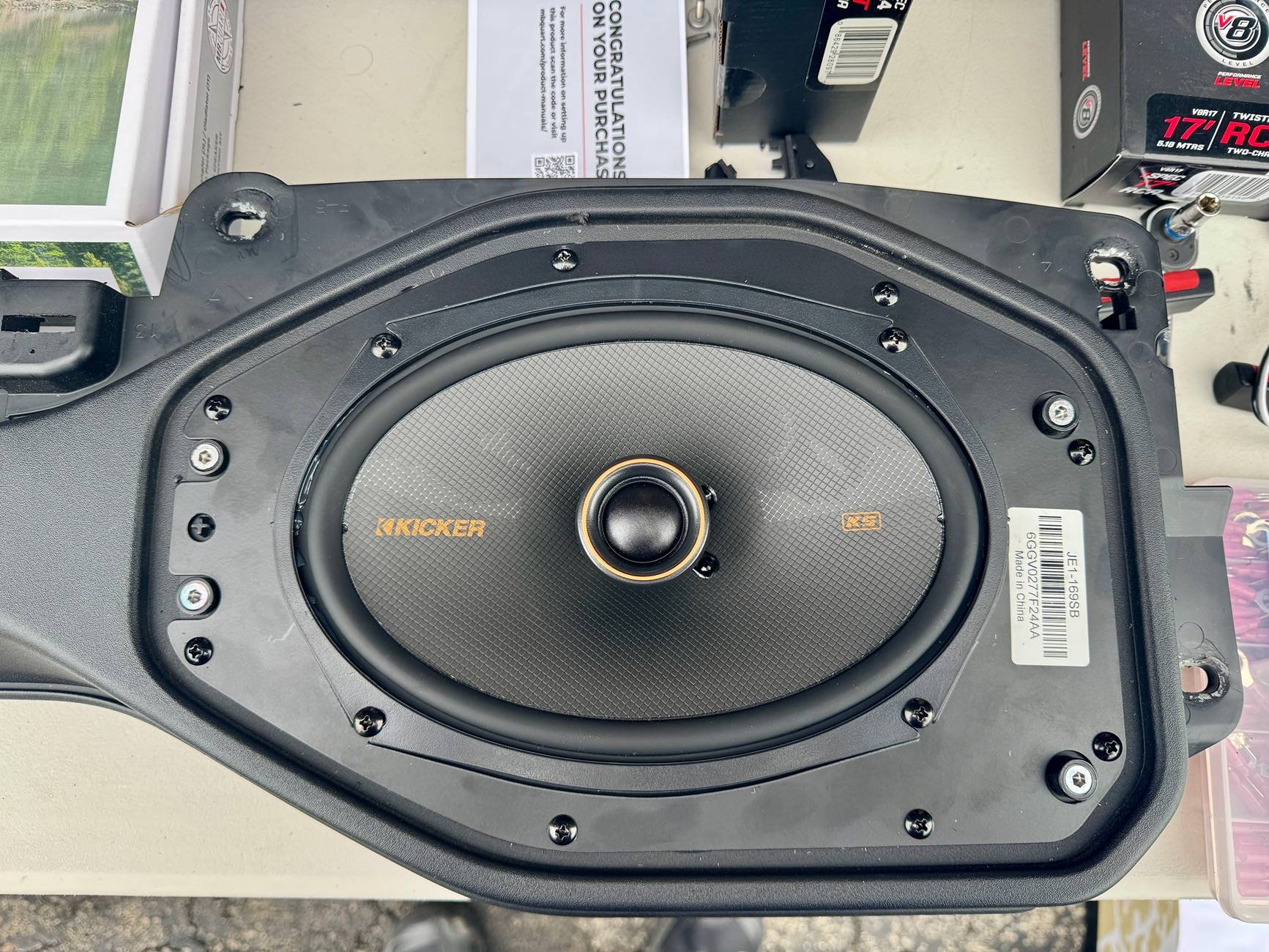

Took about nine hours. Still need to dial in the gains but its a massive improvement. Crystal clear at all volumes and it gets incredibly loud when you crank it.

1. Underseat amp brackets work just fine in two doors
2. Take the doors off to install the knee pods, I didn't feel like getting my door cart out and it would have made getting the side screws in/out less of a pain if I had
3. Use short RCA cables, the amp power kit I bought came with 17' cables and there's about 10' coiled up behind my glovebox

Is that the JL audio 5 channel amp?

The AmpPro makes sense, didn't think of that.
Extra line outs to easily add a sub. I had an AmpPro with the stage 6 Quart kit and replaced it with a Fosgate DSR-1. Still haven’t scratched the surface of what it’ll do.
