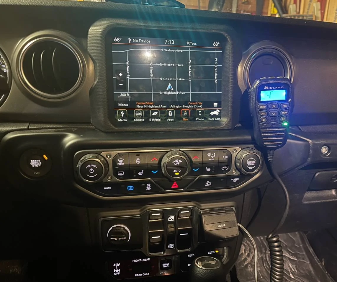

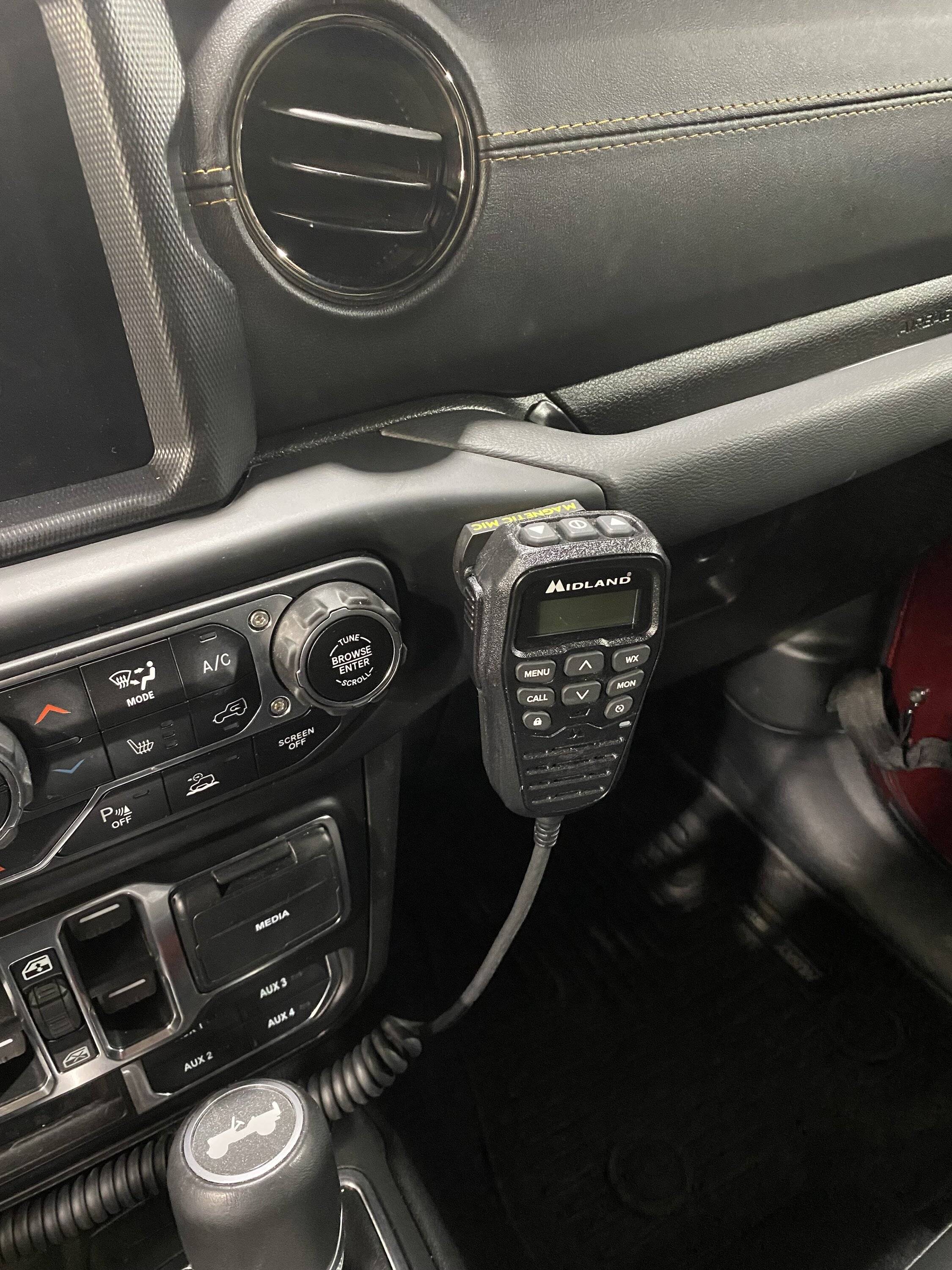

I mount my gmrs radio at passenger side under dash with no dollar spend. I use Midland mount works well.

Most of the models have the speaker on the handset. I hang mine on the dash like s2k’s above. Loud and clear.

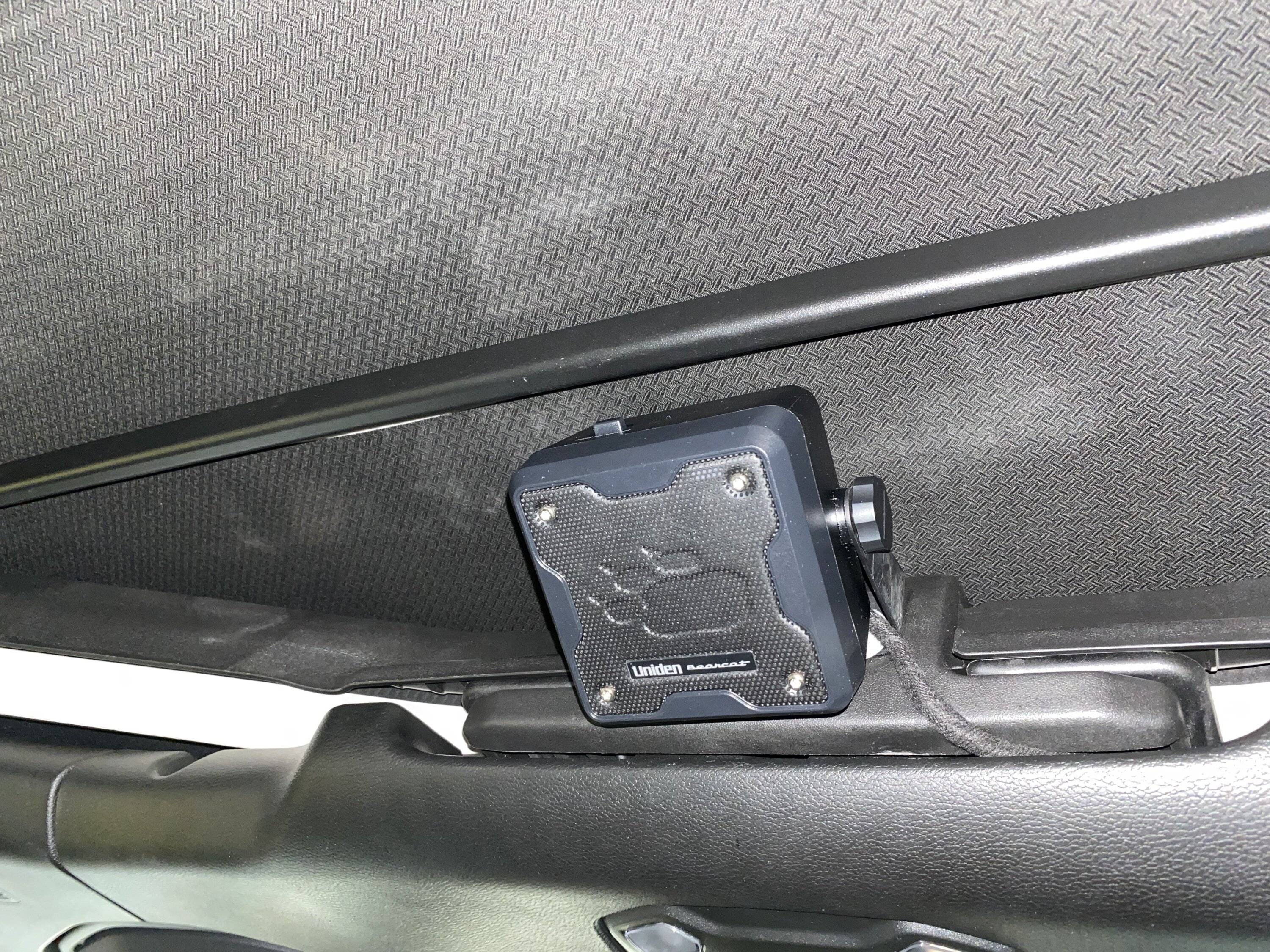

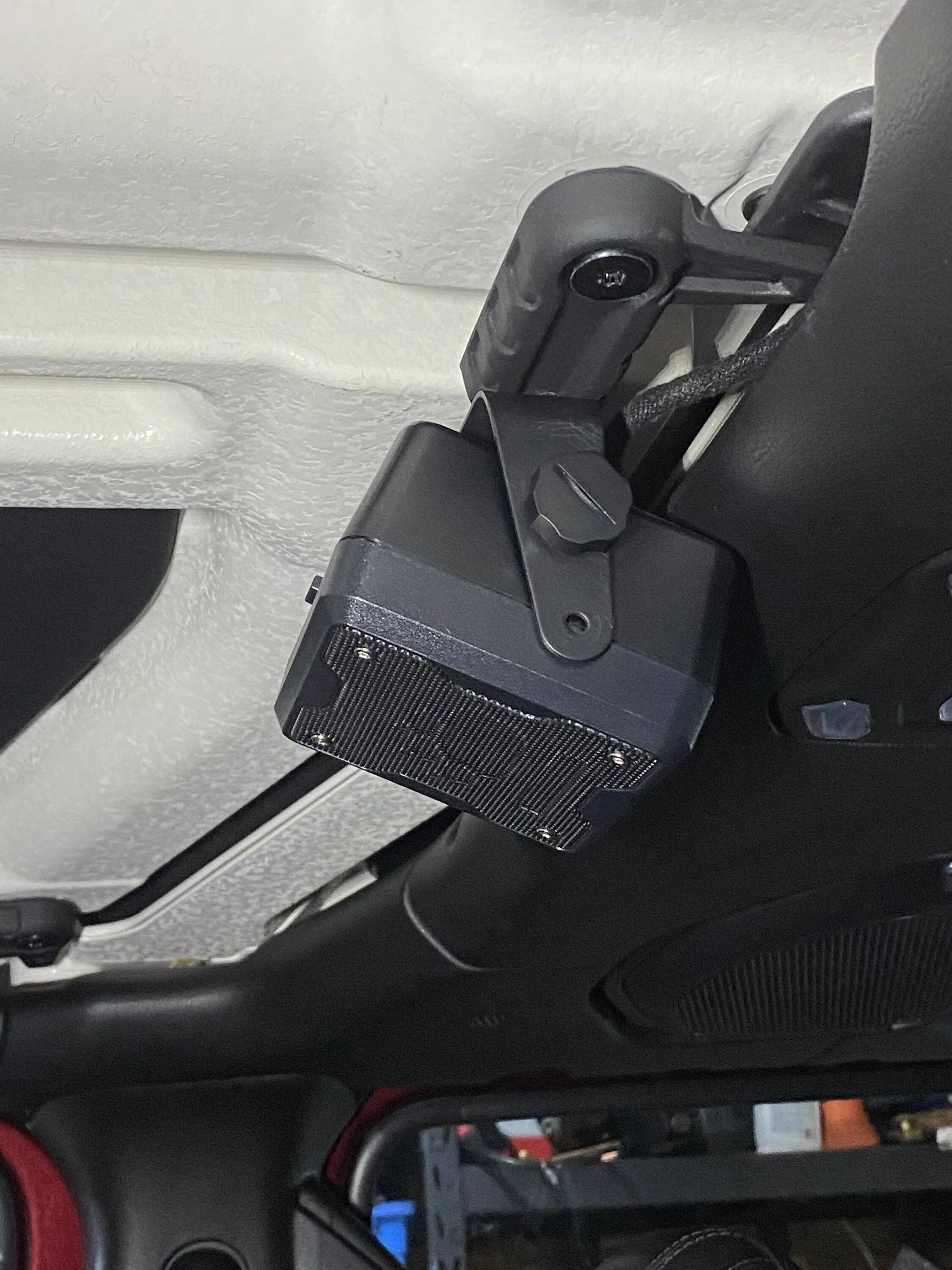

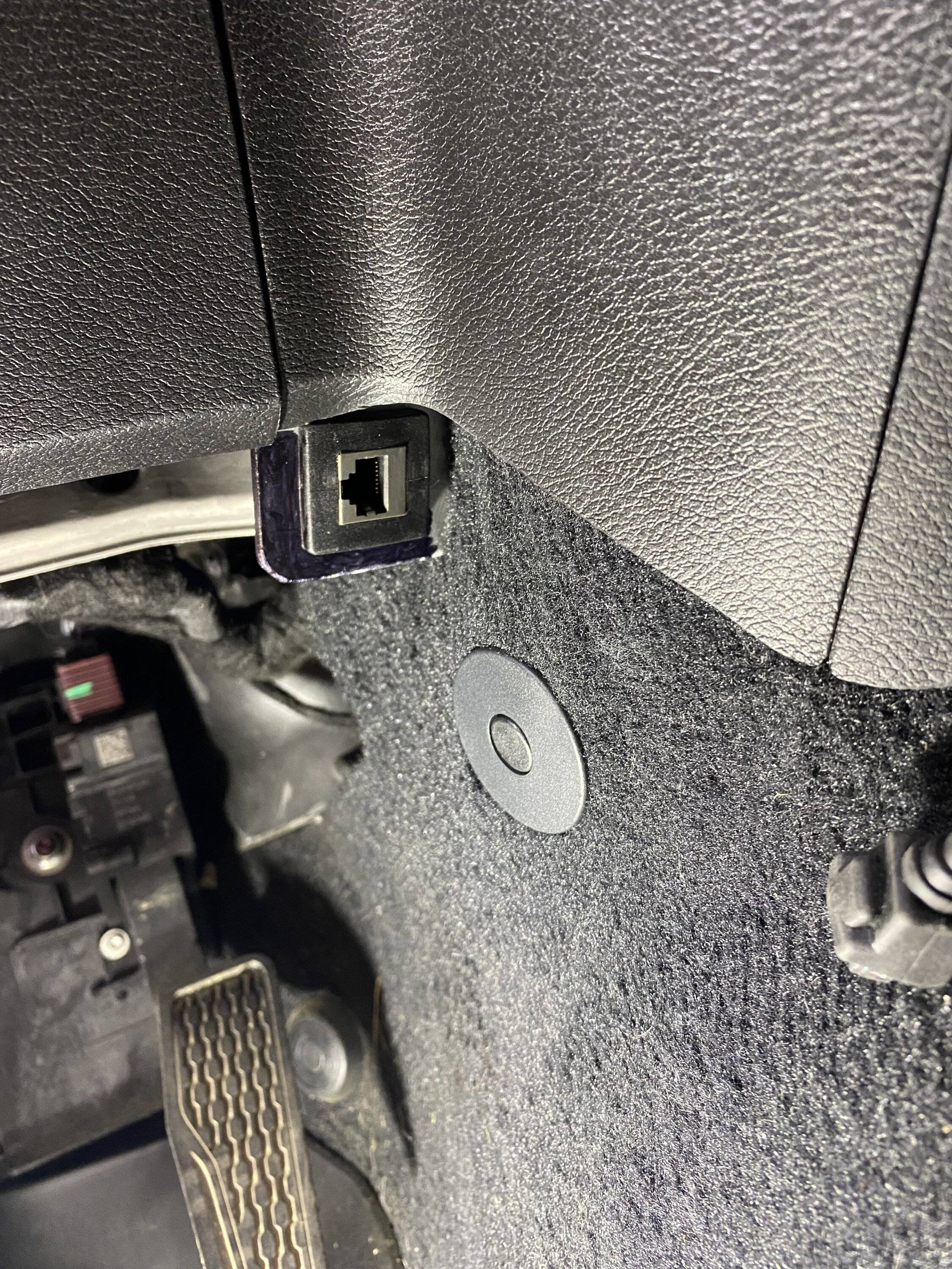

I’m hearing impaired and use hearing aids(only when I’m with company other than family) and couldn’t hear the handset much at all. So I mounted an overhead speaker that works with the freedom panels and the sunrider top. The head unit is under the seat with a Cat 6 extension for the hand unit.

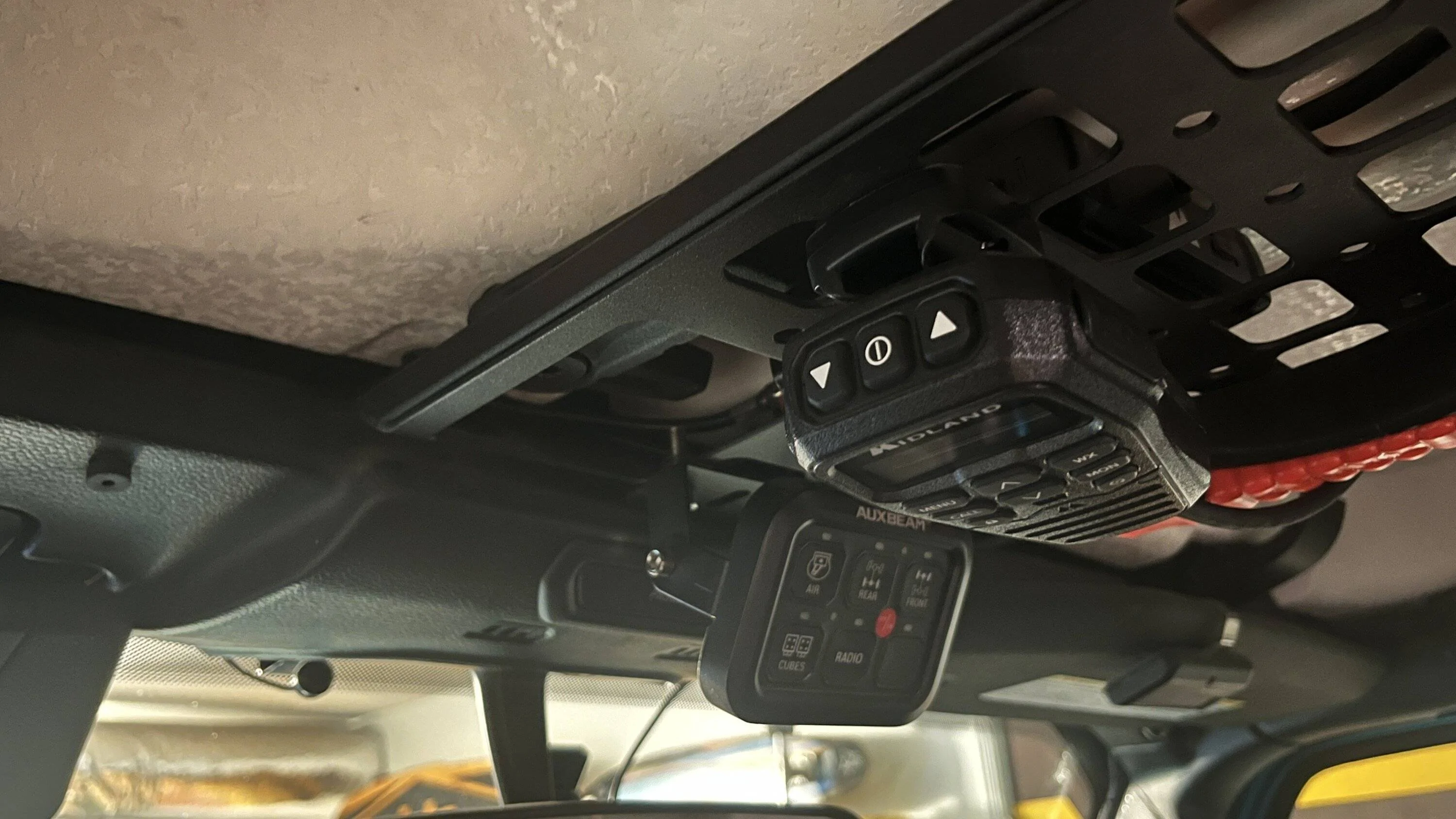

I have mine mounted to the overhead molle panel but that was also about $160. There's a piece of trim just above the windshield that I imagine you could drill into though to mount a handset.
I think it's worth the extra money though for a molle panel. That way you can mount the radio and the headset in the same place.

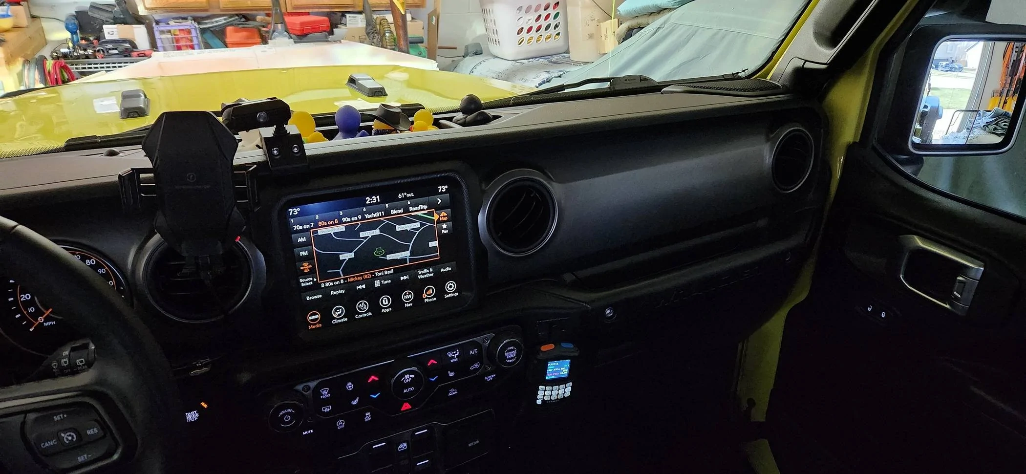

Here's an option till I get a better set-up. A handheld 8W Baofeng UV8R with a battery eliminator and a handheld mic. Mounts are from bulletpoint. The radio is a dual band Ham radio that also covers GMRS frequencies. Yes, I have both my Ham and GMRS licenses.

Nice. I found something on Amazon. KNAWIER Hard Top Molle Panel Compatible with 2018-2023 Jeep Wrangler JL JLU&2020-2023 Jeep Gladiator JT,Overhead Molle Panel,Storage Rack,Molle Rack,Textured Black Powder,No Drilling. https://a.co/d/dXxTDX1

This is similar to my mount, although I do plan to move the radio to under my driver's seat and leave just the handset and faceplate up there. See this thread for more info:
https://www.jlwranglerforums.com/fo...ou-do-to-your-jeep-jl-today.3033/post-2368483

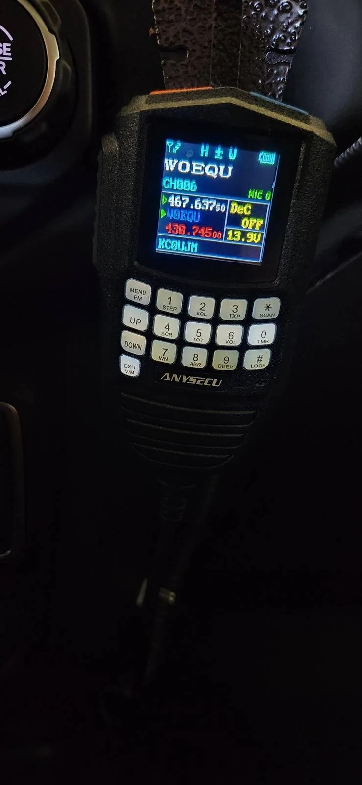

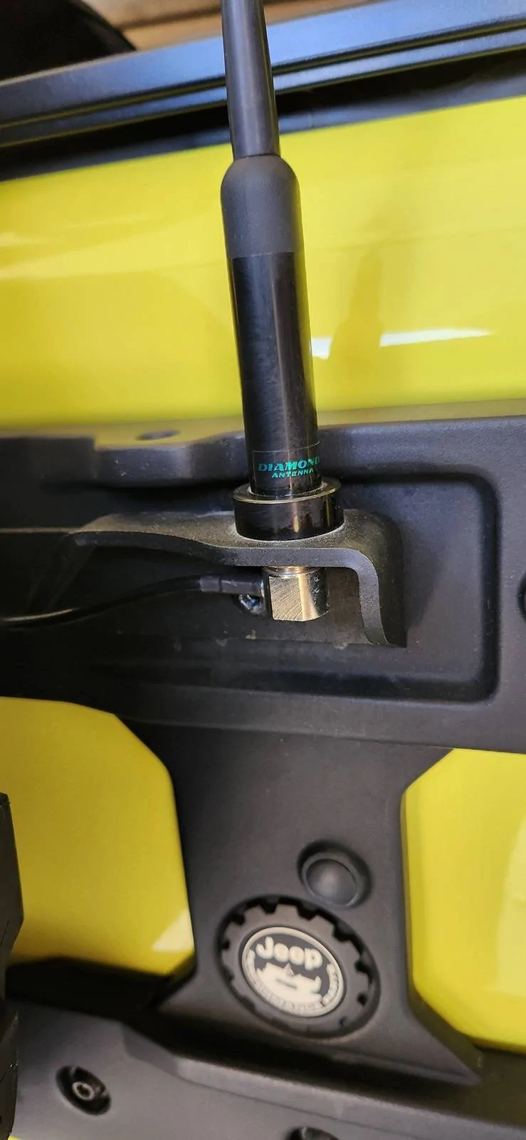

This is my setup. I use a AnySecu WP-9000 ($110 on amazon) radio that has the screen and speaker in the mic. I mounted the main unit in my glove box (its really tiny and doesn't get very warm) and used the mic mount that comes with the radio and has double stick tape, then run the mic cord out the glove box. I got this mount (Rugged Ridge | CB Antenna Mount | 11503.97 | Fits 2018-2024 Jeep Wrangler JL) about $34 on Amazon. I drilled the mount out to accept a NMO mount. I used a right angle NMO roof mount

(https://www.amazon.com/gp/product/B00LNE2ZSC/ref=ppx_yo_dt_b_search_asin_title?ie=UTF8&psc=1) and ran the coax thru the access hole behind the spare to the front. Antenna is a shorter Diamond so it does not bang when I go in and out of the garage. When on the trails or traveling, I have longer higher gain antenna's that I use. The radio is only 25 watts but seems to do pretty well. Works great on trails with others that are using GMRS.

Which bulletpoint mount are you using for the Mic? Looks like one of the phone mounts?
