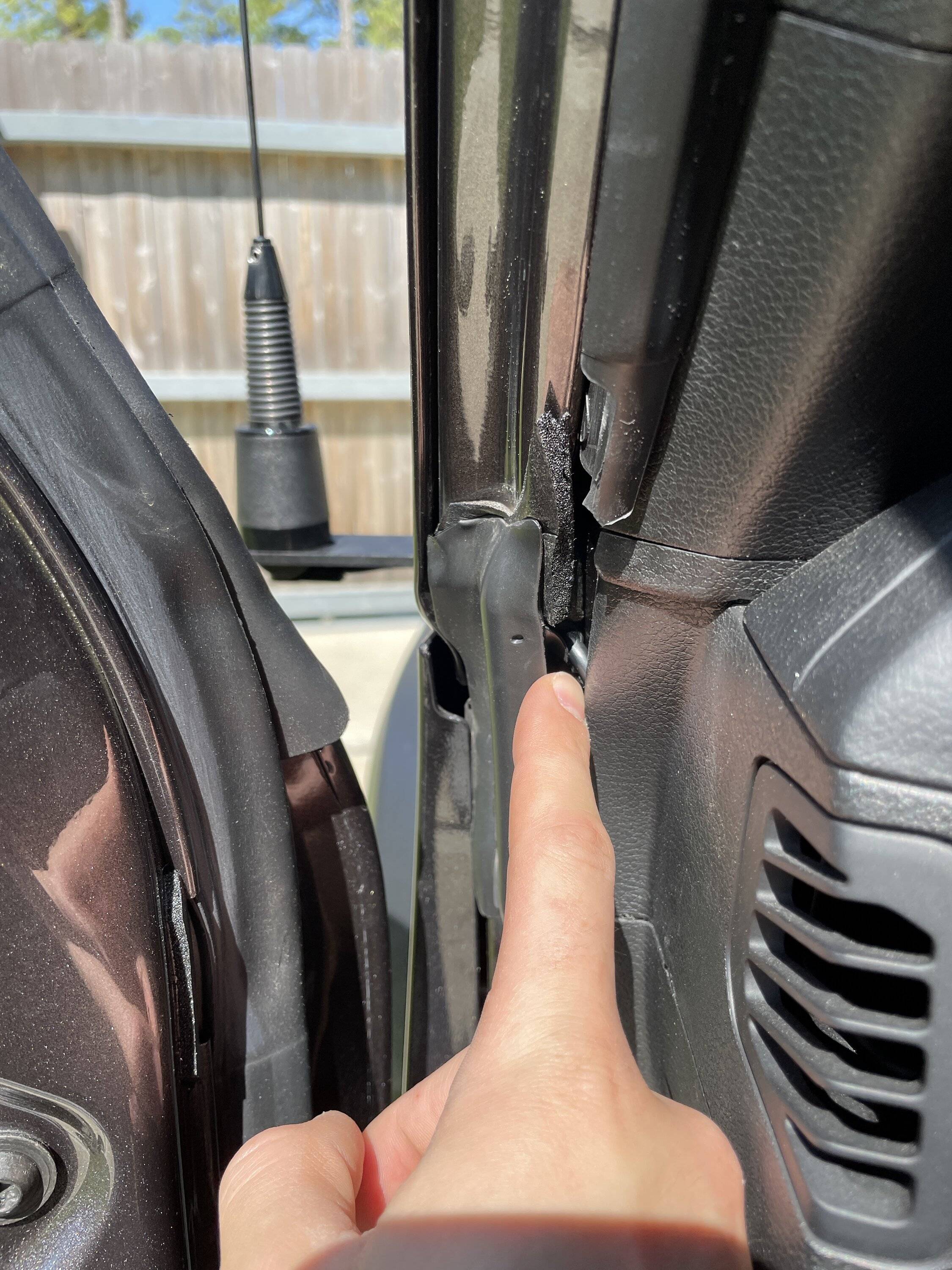

I’m writing today as a last ditch effort to solve a problem seeming to palgue me alone.
I installed a Midland MXT275 about six months ago, and have yet to use it. Not because I haven’t had anybody to talk with, but because it hasn’t worked one day.
NOAA transmissions come in crystal clear on the mobile radio while the my midland handheld struggles. The interesting part is when I am driving, transmissions from one handheld driving a little ways ahead of me sounds super garbled and unintelligible, but the handheld I have in the Jeep sounds perfectly fine…
Additionally, when I turn on the radio in the jeep while the vehicle is off, monitoring any channel is as clear as it gets. But as soon as I so much as even open a door (which turns the computer on I guess), the mobile radio shows two little lines which means it’s picking up more signal than it’s programmed base line minimum we would call zero. It goes away when the computer turns completely off again. You can hear alternator or spark plug whine when the engine is running and it’s receiving any transmission, but as soon as I start driving it’s all gone. Range stationary is no better than half a mile. I swear I know how to not break stuff, but maybe I’m lying to myself. I have one antenna cable ran to the swing gate in the rear following existing wiring and another cable ran underneath the dashboard and steering wheel to the driver side cowl. The only time the cable is outside the cab is when it exits at the cowl. I’ll attach a pic of that. I also have a video of when the handheld picks up that interference and another of the monitoring sound when the computer turns off. If there is anything for me to do I’ll do it. I don’t think it’s an SWR issue because the antennas pre-tuned and the same issue persists on the dinky little magnetic antenna that came with it. The radio is hardwired to the battery’s positive and it’s own frame ground. The antenna itself isn’t grounded to the frame but I have done that and it does not effect the stationary or driving interference. However, interestingly enough, when I hold the base of the antenna with my hand while it’s on the Jeep, the extra static goes away…
I’m lost. We’ve been through two radios and two antennas and two cables. What’s next? Two Jeeps? ?
