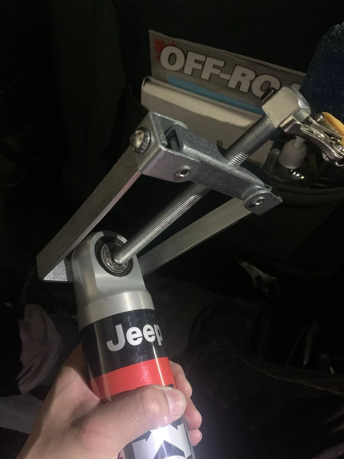

Finally got the rear ones on. Had to macgyver the shit out of those bushings to get them out. Had to cut some of the rubber lip so that my gear puller could bite onto the eyelet.
level of difficulty without proper tools: insane
Used a cheap gear puller and a quarter lol. The need for steady hands is an understatement.
Had no way to lift the Jeep from where I was so I had to compress the shocks by hand just to get them on. Should be worth it!
thanks for all the tips on this thread!

What bushings did you replace them with?
