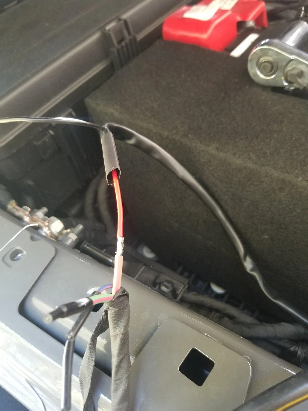

Jeep Wrangler JL Ghost build 20190324_153955
wiring for front lights super easy thanks to factory aux switches.
