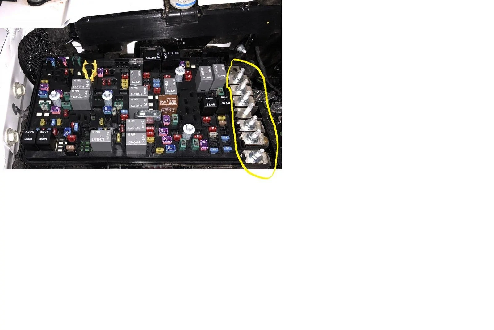

In my opinion it can be hard to get the plastic cover to the 3.6L JL's Power Distribution Center (PDC) (as you face the engine in the upper left corner)
Jeep Wrangler JL Getting Power Distribution Center Cover Back On 142832-a945979e866e8abec866dacb185ae6b7
back on properly, once removed, and after having made connections to the Hi Order Fuses in the PDC's rightmost area, as circled in yellow below.
Jeep Wrangler JL Getting Power Distribution Center Cover Back On 142839-f0adf338fe82dae76fd3610be5275d3a
I am trying to use a hack developed by Mr. @Jebiruph to connect two of the terminals circled, closest to the bottom of the picture: N1 and N2, to have a safety against a dead ESS battery preventing the 3.L JL from cranking--long story posted elsewhere.
I find it hard to sit any electrical connection below the factory wires that connect to each of these terminals because all of these connection are made by the factory at 90 degrees (the wire drops down.) Sit them above, especially if not also dropping down 90 degres and the PDC cover seems difficult to lock back on.
I've had two ideas to help this: one involves separating the nut from the factory 90 degree eyelet that attaches to it--which isn't hard to do. This would allow me to connect my own wires with eyelet terminal connectors above the factory ones, and use the factory nut to secure both wires down.
Another idea might involve putting a second nut (wing or standard) on top of the factory one to secure my electrical additions.
But in either case the wires from my connections make getting the PDC cover back on completely, difficult to impossible--at least me.

You should be able to drop the jumper connector over the N1 and just use a nut to secure the cable right over top of the nut that is there. You would do the same with the N2. Than just lay the jumper wire with fuse down into the box and put the PDC cover back on. Yes, I know the PDC cover does not secure well, even with nothing additional under it.

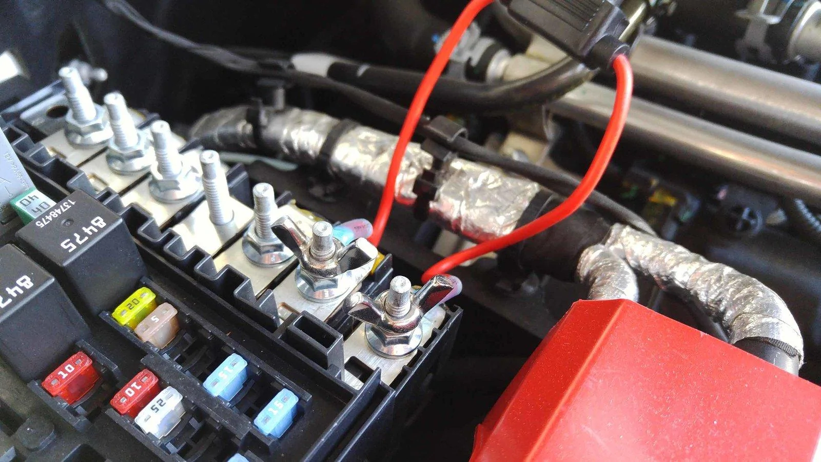

You guys made me go out in 8 degree weather to get some pics, but that's just how dedicated to the team I am. :like:
Here's mine installed with wingnuts. I installed the first wingnut tight, then backed it off so it didn't interfere with the second wingnut. Once the second wingnut was on tight, I re-tightened the first one.

Disregard what I said in this post about my not going to use wing nuts for N1 and N2. Today, I found wing nuts with smaller wings that work well . Got them at Lowe's.

The ones I got for N1 and N2 also have small wings and you can easily spin on both without touching each other
