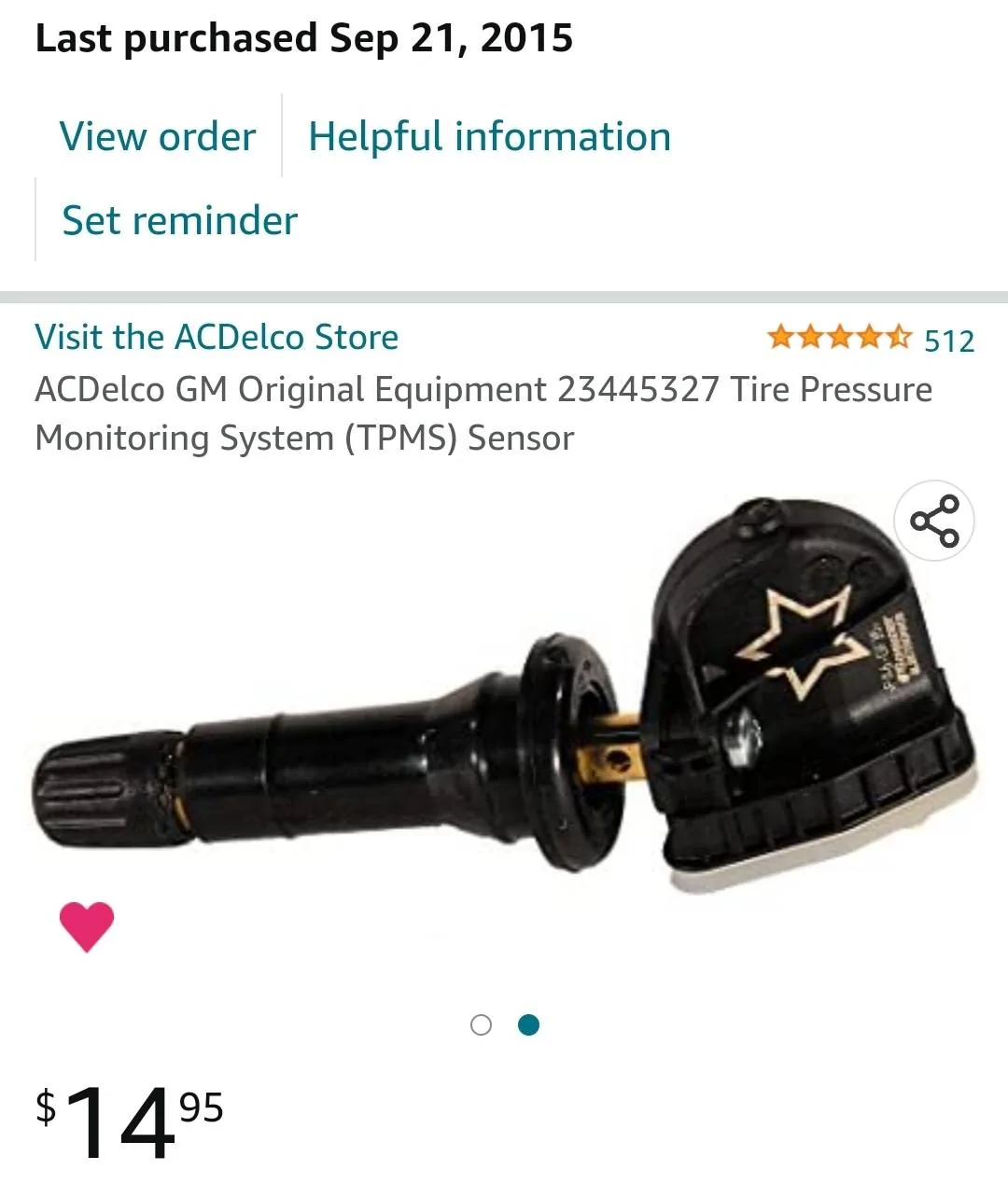

It's more about time than mileage.
There is a lithium battery in each one.
I got my last set for my truck off Amazon.
A fraction of the locals price. I paid $26/each so they have went down...
