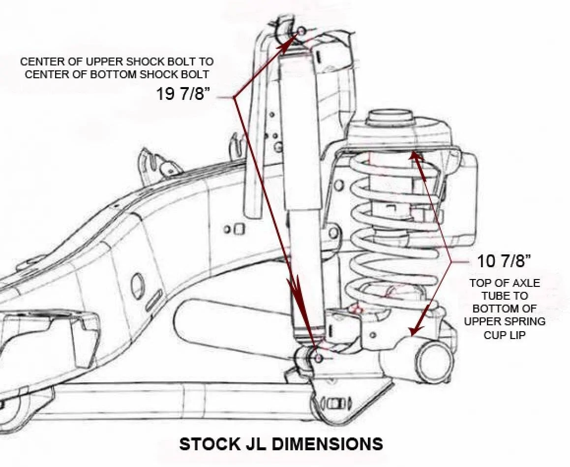

how much actual lift do you have using this diagram?
Bolt to bolt, little over 21”
Tube to cup lip, slightly over 12.5”

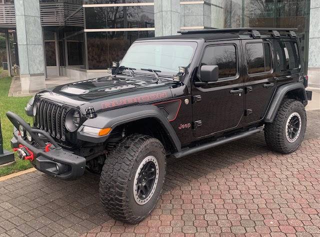

I'm looking at your profile pic. What size tires do you have?
jadmt
jeff
May 19, 2020
78
5,121
9,750
montana
255/85-17 ie 35x10 pizza cutters. mickey thompson baja at's
