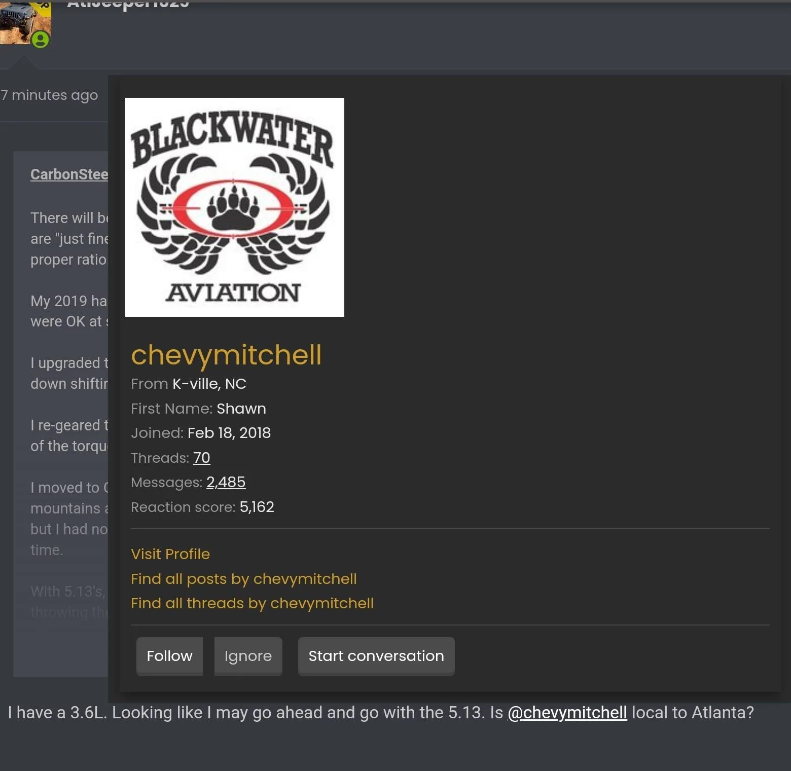

I have a 3.6L. Looking like I may go ahead and go with the 5.13. Is @chevymitchell local to Atlanta?

Hey... that's me. ^
I'm out in Kernersville, NC. Right up 85 from the Varsity.
