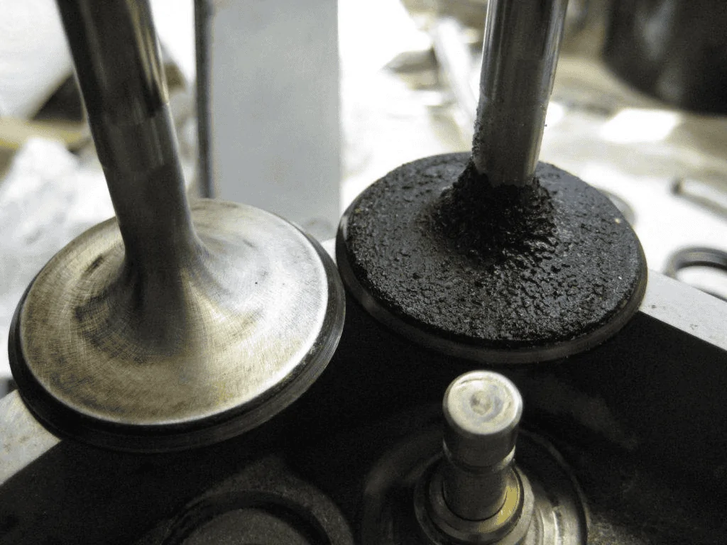

To put it nicely, I don’t think he knows what he’s talking about. Or he misunderstood. The problem with carbon building on DI was always the intake valves since the fuel is no longer spraying on them. This is well documented and there are 1000’s of examples.
Sea foam in the gas does nothing for this.
I'd have to agree with this, as (my guess) any fuel additive will never see that back of the intake valves in a gas direct injection engine.

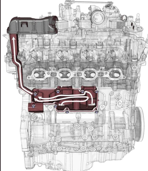

This is consistent with what I have seen as well from these engines. Do note that if you are using the mishimoto can, you are only trapping the vapor from the CCV side of the engine which is only active under boost. On regular cruising without boost, your CCV side does not flow and all crank-case vapors are re-circulated via the PCV side of your engine. Unless you drive it like a hot rod, i don't see much benefit of a CCV only can.
If you look at some of the schematic diagrams for the GME engine, you'll see that the engine itself already has a pretty robustly designed oil separator built into the engine.
See below for the baffles which makes up the oil separator on our engines. The labyrinth design of the oil separator cause the oil to condense and drop back into the crank-case. This is essentially like a giant oil catch can.
Jeep Wrangler JL Gasoline Direct injection -- valve deposits Screen Shot 2022-12-05 at 1.46.43 PM
On the Giulia forums, Alfa techs have torn apart these engines at 80k+ and found no carbon buildups on the valves. The alfa version of this engine has a different valve-train but share the same oil separator design.
Our 2.0s run pretty clean.
