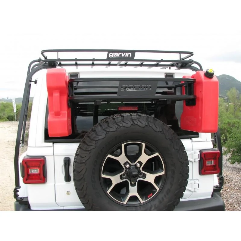

I've considered it and posted about it before, but in the end it's a $500 hitch basket that will overload the tailgate's 80 lb total weight capacity. If you have a bumper mounted tire carrier that takes the tire weight off the tailgate this would probably be fine.
This is overloaded with just the full fuel cans and nothing in the rack. no tailgate reinforcement, no bumper mounted tire carrier. Probably fine for street use but I wouldn't trust it offroad:

I was estimating that the two 3 gallon fuel tanks shown weigh about 50 of the 75 pounds the rack is rated at.

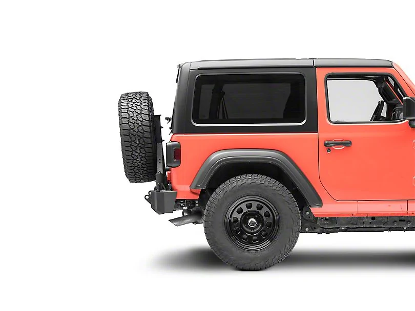

a few lightweight items shouldn't be a problem, but loaded to it's "rating" it's like strapping an extra spare tire on the tailgate. I know I wouldn't be comfortable putting two tires on the stock tailgate.
I run a tailgate basket for our hunting trips when I need some extra room, but would love to get back that ground clearance I just haven't found a good solution besides spending thousands on a bumper/swingaway tire carrier/basket combo. Something simple like this and then a Garvin-style rack on the tailgate would be perfect but doesn't exist for the JL.
Jeep Wrangler JL Garvin Trail Rack 2000? J20852_alt9?wid=810&hei=608&op_usm=0

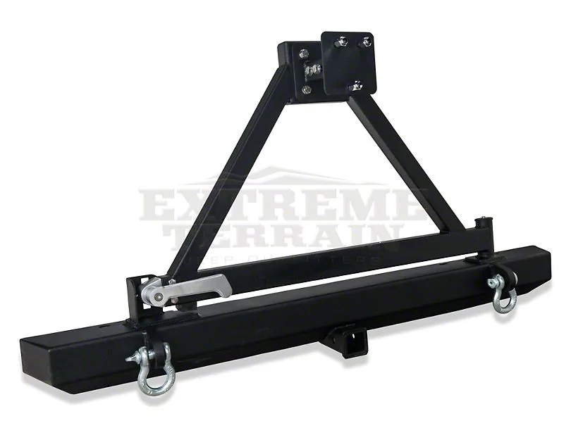

EDIT: I know Barricade makes a similar bumper for the JL, but it doesn't have a provision for the tow hitch and this manufacturer picture doesn't exactly inspire a lot of confidence:

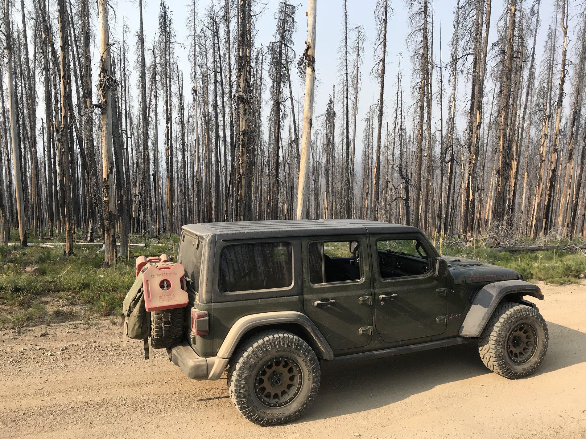

FWIW, I ran a ~5500 mile on and off-road trek from Texas to Montana, Idaho, Oregon, California, Nevada, Arizona, and back to Texas recently with a pair of 3gal Rotopax hanging off the spare tire (not apples to apples comparison but similar weight distribution to this rack). With the Rotopax full, i could tell the tailgate was sagging about 1/4" or so; it wasn't enough to keep it from latching or anything, but I could feel the slight sag when opening and closing the tailgate. While on the Magruder Corridor (the only place I might've gotten into a pinch for fuel), I emptied both Rotopax into the Jeep as quickly as I could to reduce the wear on the tailgate hinges.
I wasn't worried about the weight while they were on there, but did decide it was better to err on the side of caution and run them empty as much as possible. I'll continue to run this mount for the rare trips where I feel the need for the extra fuel, but as soon as I mount a roof rack on the Jeep, the fuel cans will be relocated. For the long term, I wouldn't want that additional weight hanging off the tailgate.

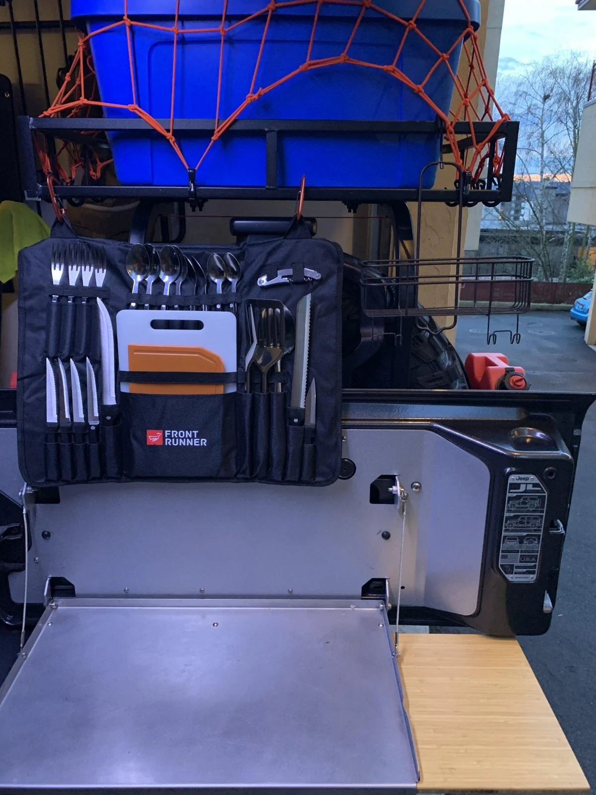

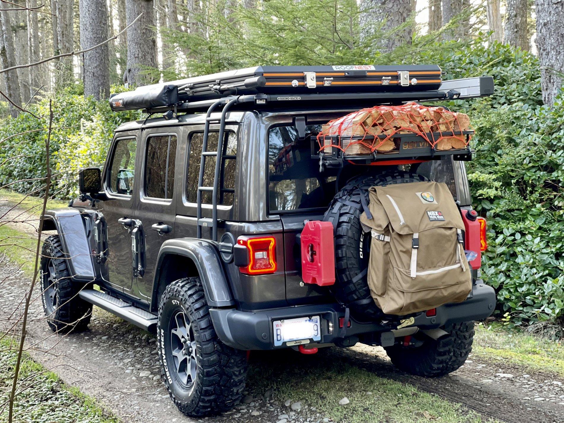

I just added the Garvin Trail Rack to my JLU that has tailgate reinforcement from factory. This is a great rack! It is really well built and it serves so many purposes. In addition to carrying stuff and side Rotopax mounts... it’s a great place to hang the Front Runner Camp utensils kit and I also hung a shower caddy to hold spices, olive oil etc... this rack has made my Outback table on the tailgate into a full kitchen setup. Also perfect for holding our diesel heater at camp. We love it!

Your jeep is so nice. I am trying to build mine similar to yours. I think the rear basket is perfect for wet fly fishing gear after my trips.
