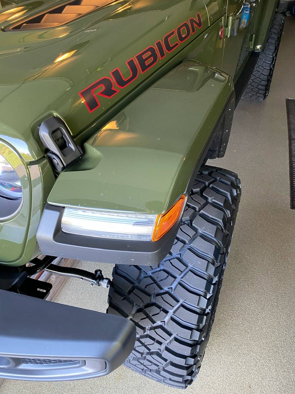

To give you an idea here’s -19mm :involve: (4.75” backspacing) on a 10” wheel on a Rubicon axle (I’ve heard they are a bit longer?)….
Jeep Wrangler JL Fuel 18's +20 offset FC3285FD-D5ED-405E-A99C-DE7341C29126

I believe all the diesels have the longer axles, though I'm not totally possitive.
