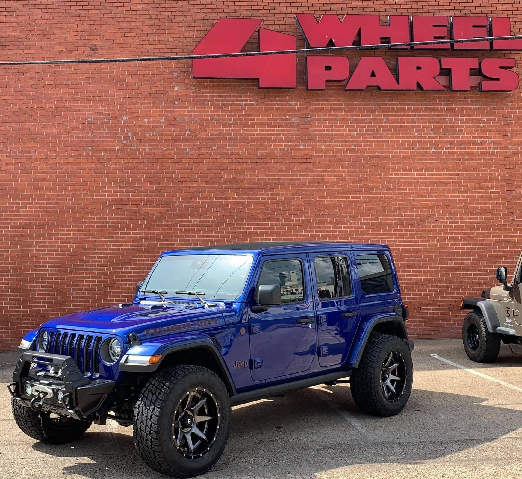

RubiBlu19
C
Jul 3, 2019
Dallas
2019 JLR 2018 X5
20x12 -19
35” Nitto Terra
No rubbing at all Stock height.
Jeep Wrangler JL 20x10 -18 offset 1159D207-D694-4695-BBBD-59DCC0A79F70
