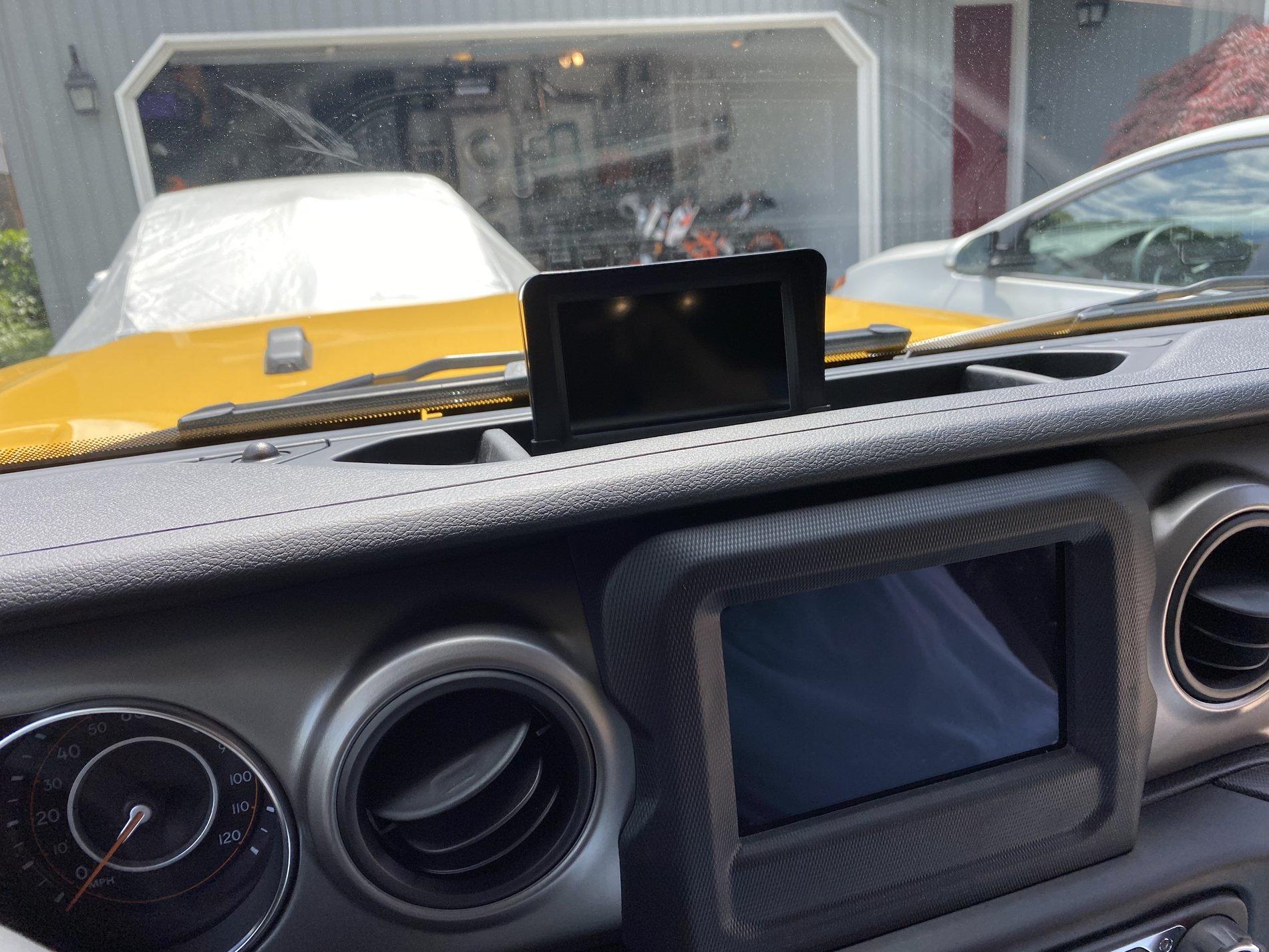

You mind sharing the deets on what camera and monitor you are using?
This is the camera kit I bought: camera kit
I mounted the monitor on top of the dash, in the cell phone tray on top of the radio:
Jeep Wrangler JL Front Trail Camera IMG_3213

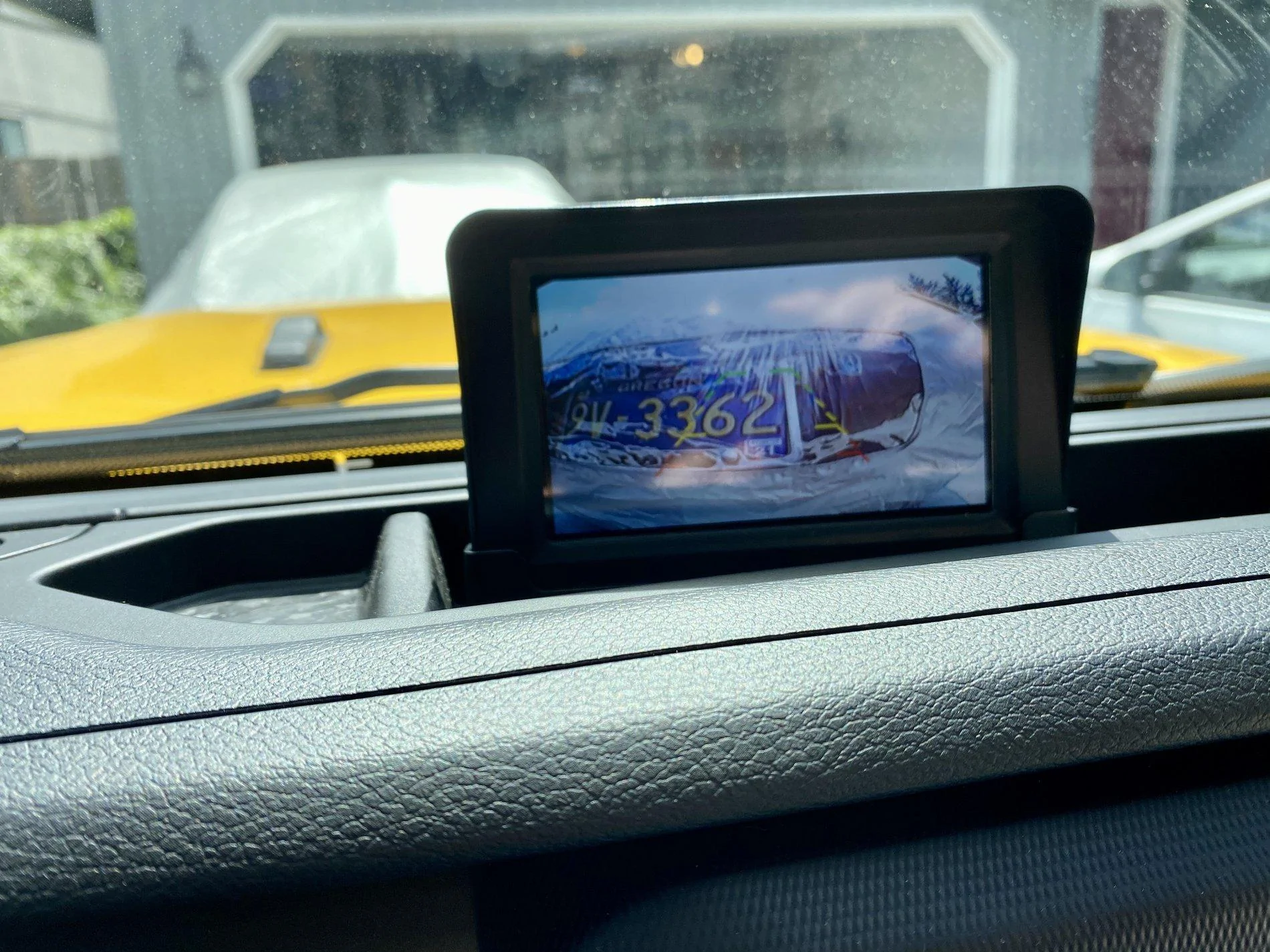

And this is the picture quality:
Jeep Wrangler JL Front Trail Camera IMG_3214
It's not the best quality, but I wanted it for a tight end-to-end parking space, so I could get within an inch of the car in front of me without having to get out to look. I'm not sure how it would be for off-road application.
