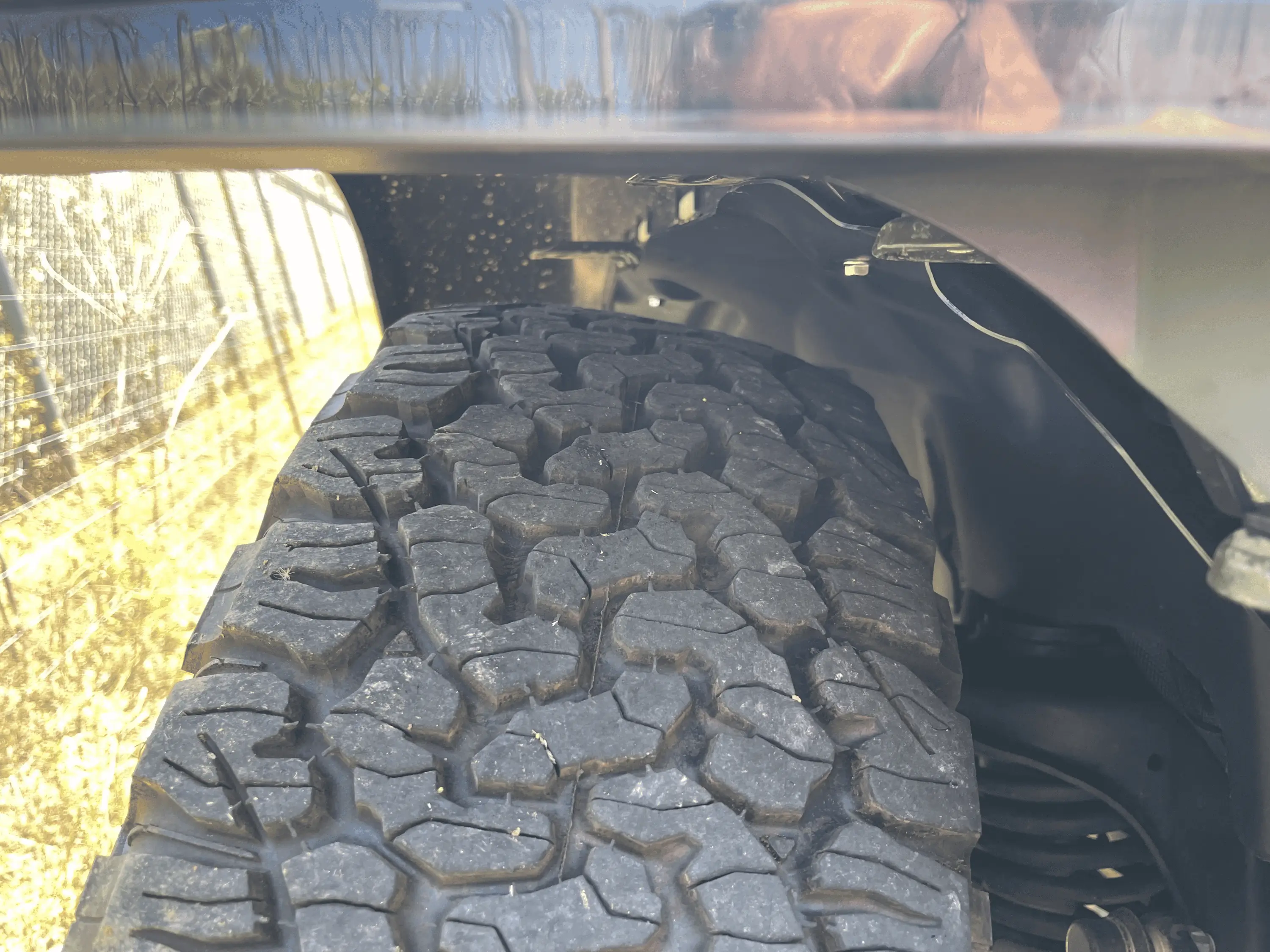

I cut my liners while I figure out which aftermarket ones I want to go with and it does give you a little more clearance over stock but obviously you still are going to run into some stuff with the factory liners there.
This is on the bump stop up front on stock Rubi wheels/tires with the Quake chop.

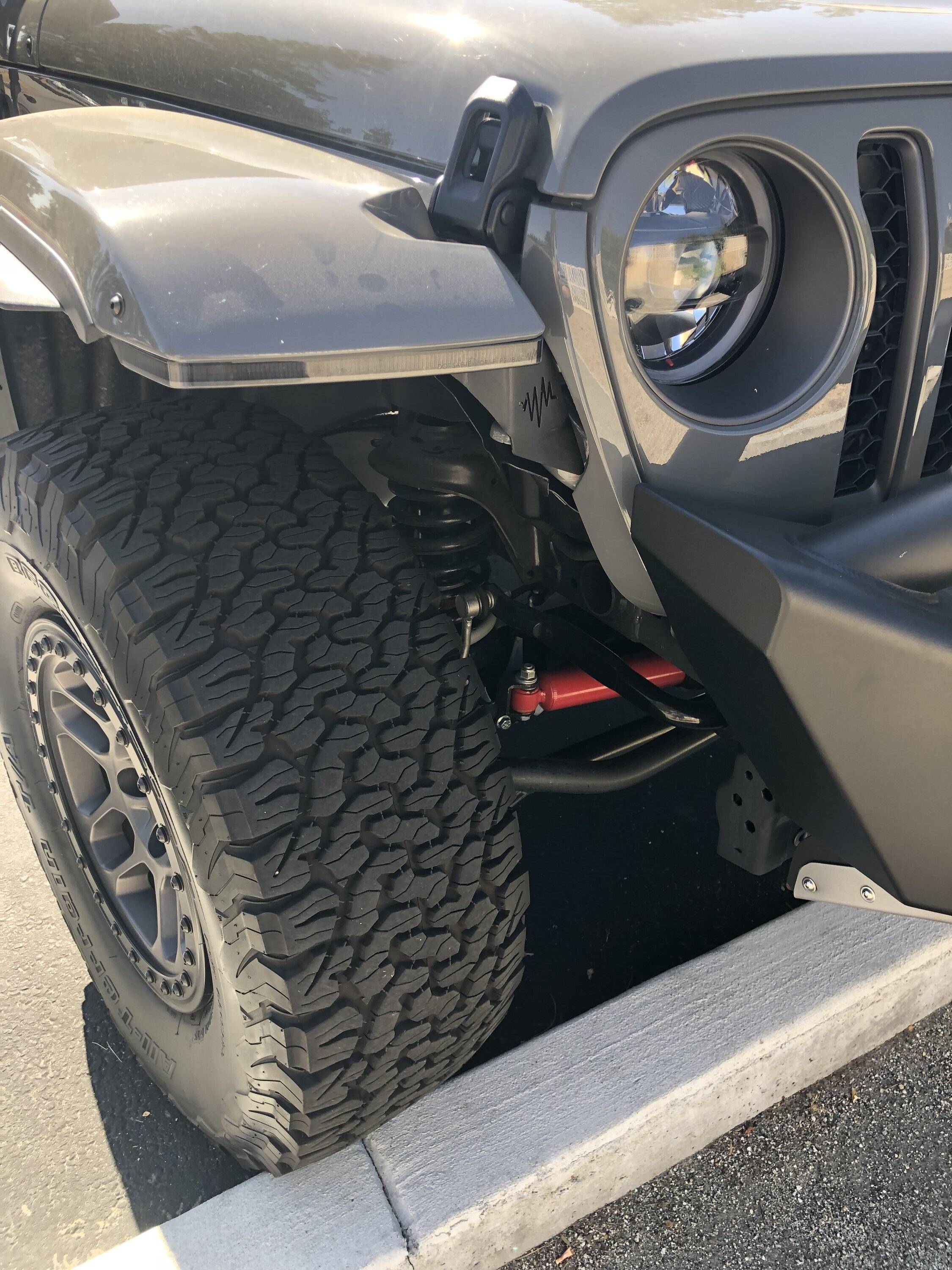

Thanks for the replies everyone, it looks like most of these methods keep the liner which doesn't really gain that much clearance?
I will admit I did it just for aesthetics for now. I think it looks better especially with a stubby bumper. I plan to do a fender split and AAL inner fender liners at some point.

Yeah, that looks great! that is definitely part of why I am thinking about doing this as well. Also, you do gain a little bit of clearance where the light used to hang down. I actually did almost take that light out on a tree last year while wheeling.
I agree they look great with stubby bumpers which is what I have too.
