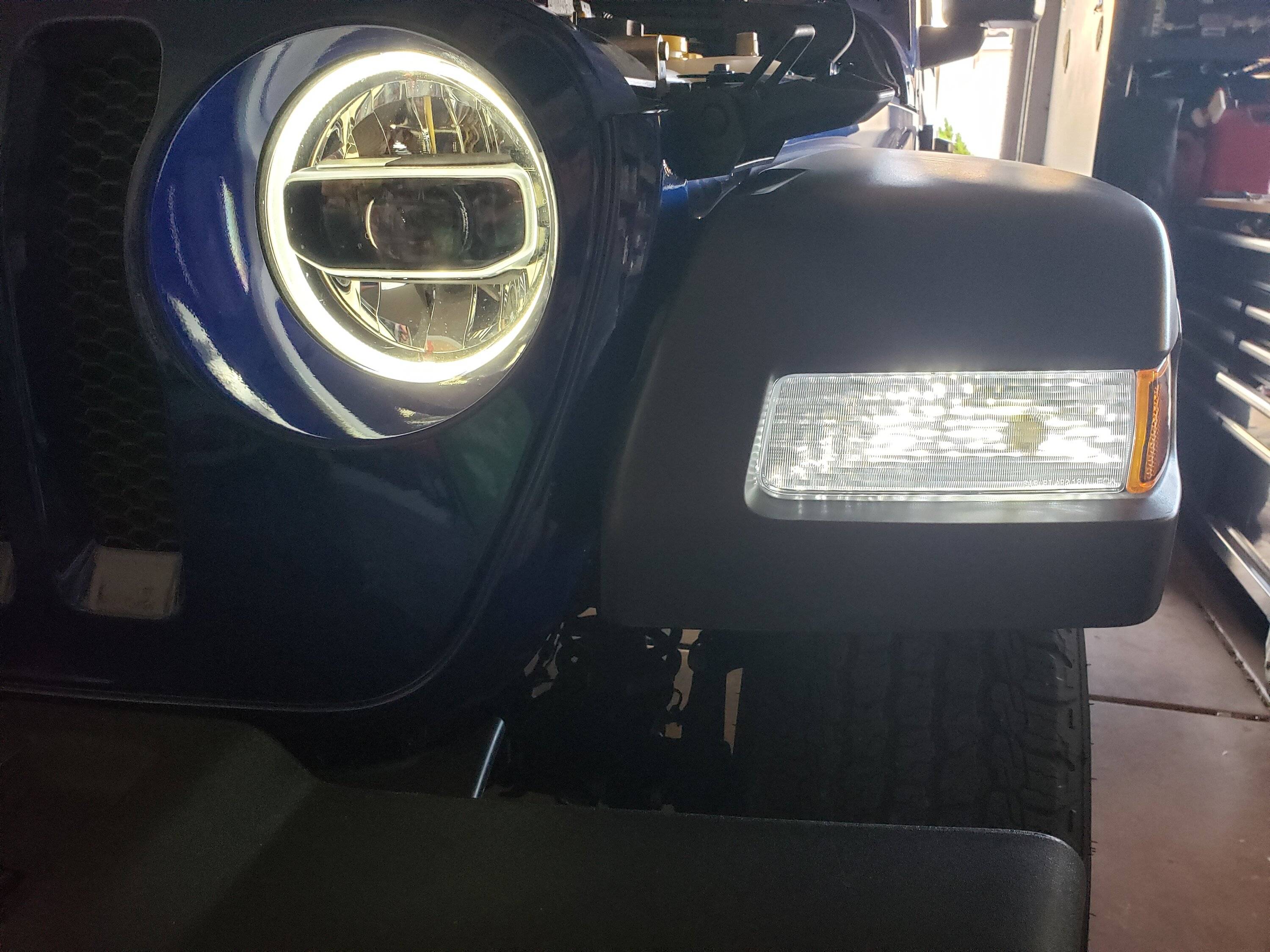

Installed these on my '20 sport s (with the LED headlights) almost three years ago, and they still work perfectly. One of the firs mods on my Jeep and I still love the look of it.

If you have the LED headlughts with the halo, there's a wiring 'shortcut' on page ten of that thread. You can tap straight into the halo power line - instead of running wires back to the fuse box - and all your DLR lighting will be on the same circuit.

Tapping the harness should not cause a CEL for any reason. All the CANbus is looking for in the lighting system is a specified voltage drop in the loop. The programed specs are based on 'traditional' bulbs that have a much higher resistance then LED's. CANbus compatible LED's have a built in resistor so the system reads the proper voltage drop. This is why you have to add an inline resistor to non CANbus LED's.
Tapping the 5 wire has no effect on the halo resistance as the switchback has its own neg line back to the the system. They complete seperate curcuits, with the resistance read on the 'return line' for each seperatly.
If your friend is getting a cel CANbus error, it is most likely a issue with equipment they used. It could be pulling more voltage then expected. I've read of JK owners getting cel's from led's with a malfunctioning anti flicker harness causing random voltage spikes.

Does he have the factory LED headlights? The 5 wire I tapped powers the factory halo and is only on the harness with factory LED's.
Sounds like when they tapped his they shorted something that is still isn't fixed. Wrong resistance (to high) would simply show a bulb out on his display. To get a CEL, something is pulling extra voltage or amps via a short.
I'd splice in a new harness in before where they tapped the lines and see if it cleared the issue. They did something funky, thats for sure.
