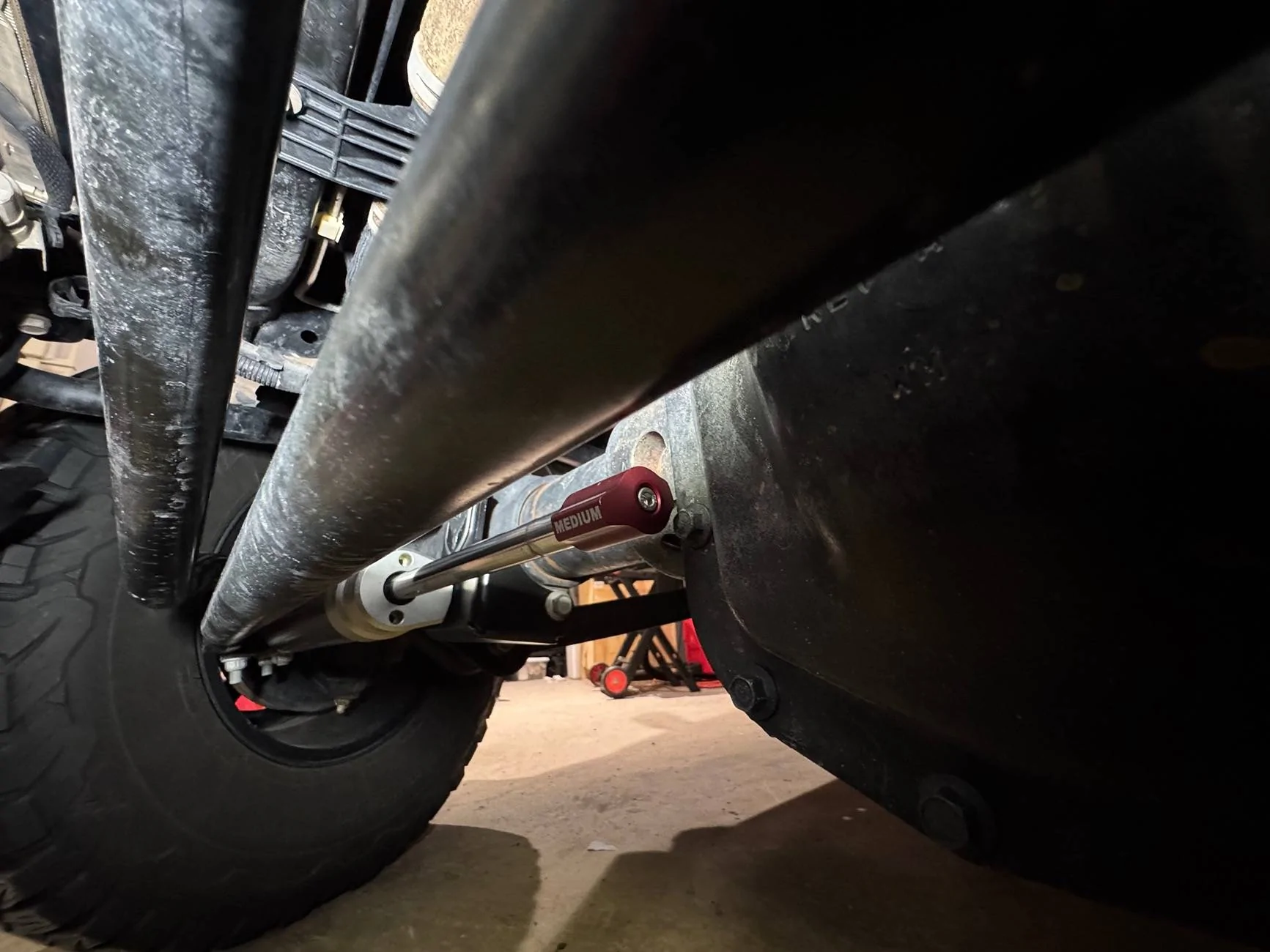

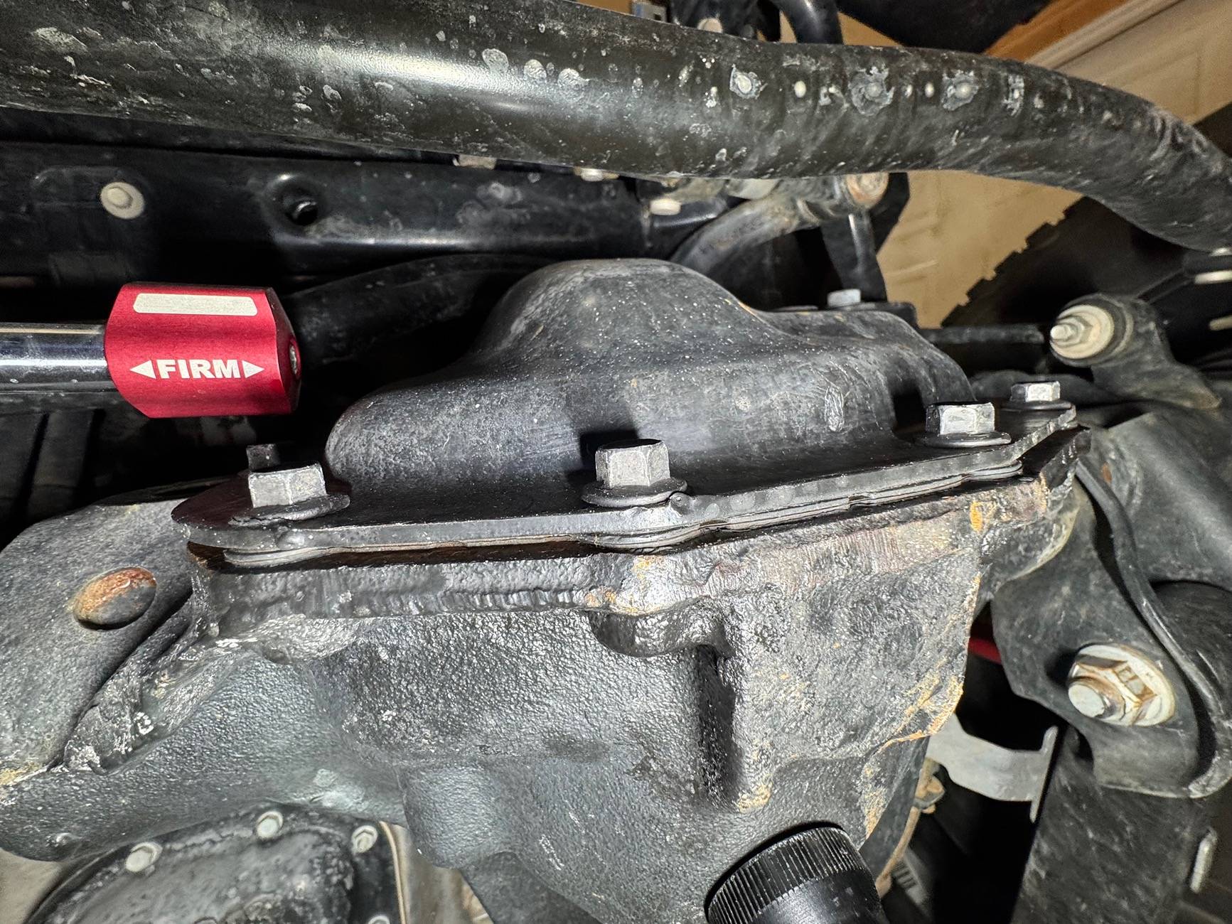

I’m looking to protect my front differential and considering the Next Venture diff skid. Would this be sufficient for tackling more challenging trails? I’d appreciate any feedback from those with experience on tough terrain. Also, is an aftermarket diff cover necessary? I currently have a Falcon 2.2 steering stabilizer, so I’m concerned there may be clearance issues if I try to run both.

My Falcon 2 ran into my Rancho dif skid (with the stock dif cover) and broke the stabilizer bracket so, yes, a thicker cover and/or a dif skid that attaches to the front of the cover is something to watch out for. As far needing both, IMO they serve similar purposes and having both is a little overkill.

if i’m understanding these pictures correctly, i’d be more concerned about relocating that Steering Stabilizer up out of harms way before worrying about dif skids or covers.

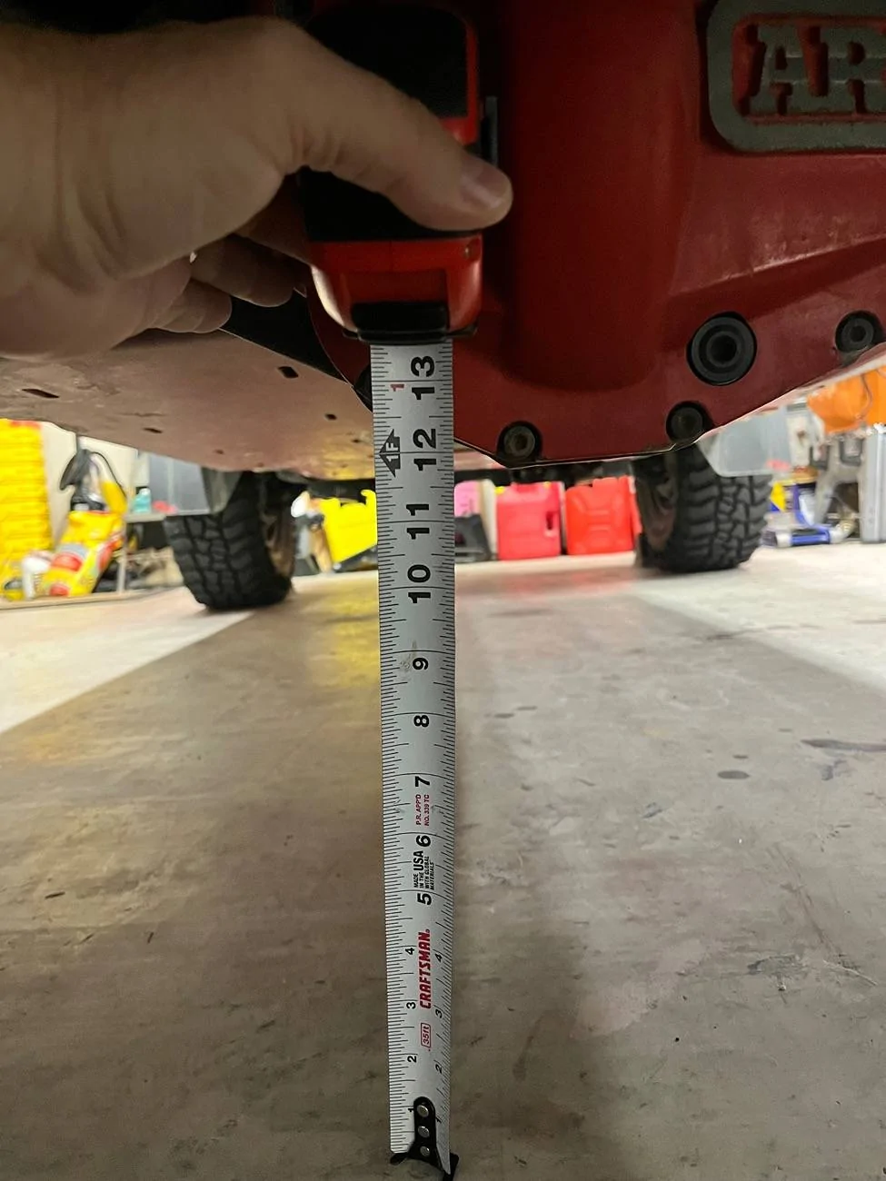

For the OP - I put ARB diff covers on because I'd rather have the protection and not need it than need it and not have it. My reasoning was - I think the diff housing is strong enough for what I'm doing. A skid can both make sliding over things easier and cause you to catch on something you otherwise may not.
