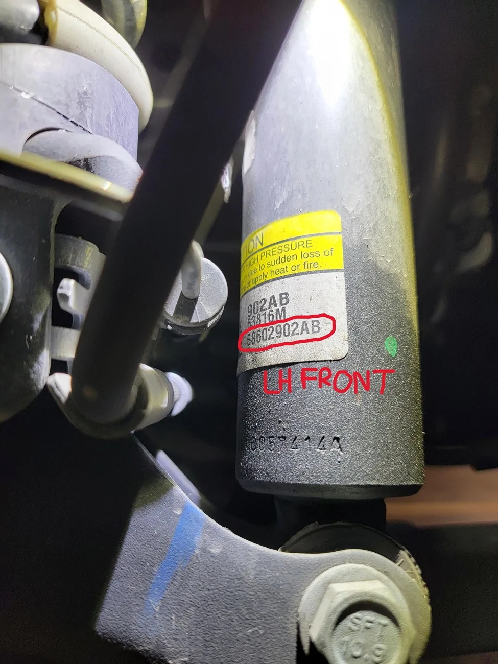

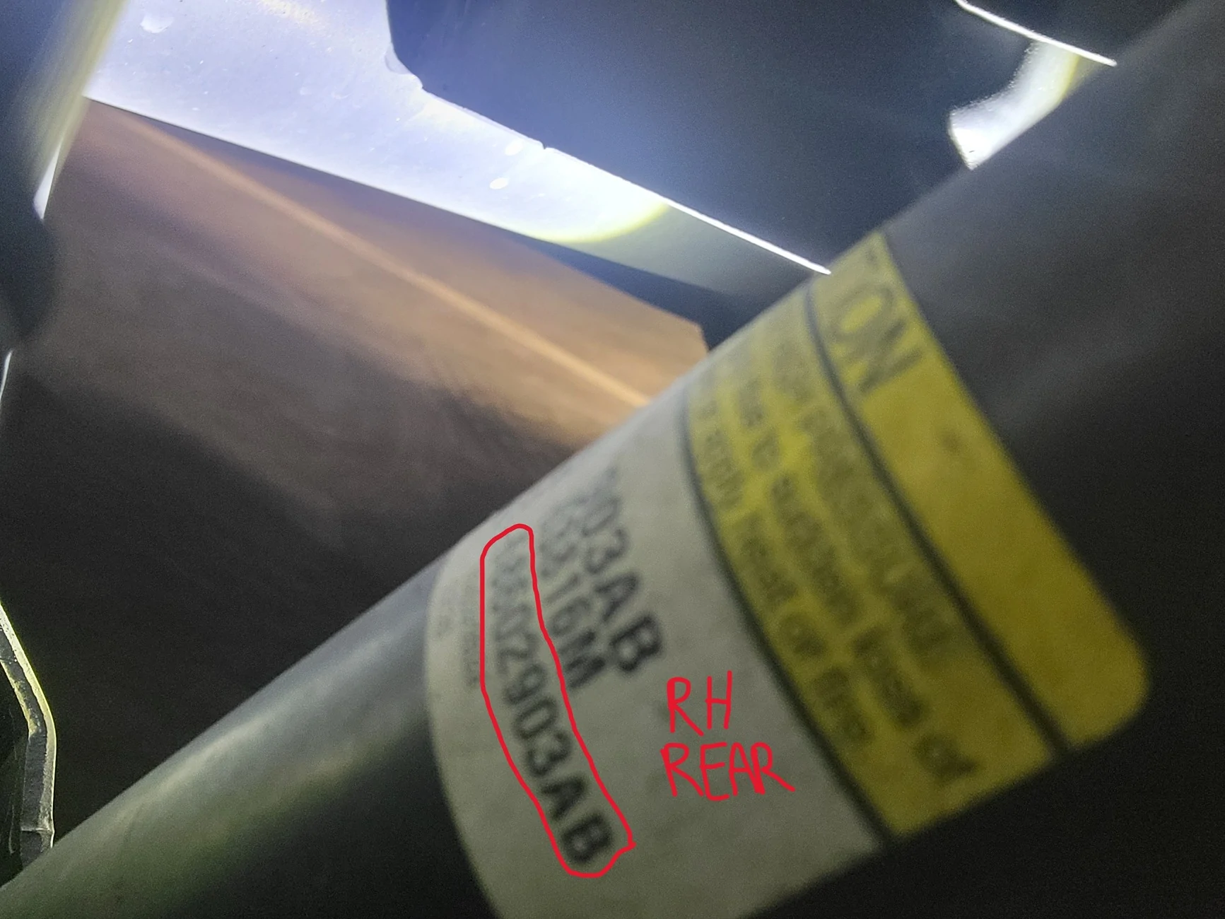

Hey All,
Brought my 2024 JLU Sport S (16,500ish miles) to the dealer for its final free tire rotation and oil service and a leaking front left shock I observed. Dealer said they would only be able to cover that one leaking shock under warranty even though I asked to replace both front shocks as a pair. I asked for a quote to replace the non-leaking shock, but at the same time I took the PN from the label on the factory front shock 68602902AB and searched online to see what it would cost me. Everything online says this PN is for a factory rear shock, not a factory front shock. I got home and pulled the PN from the label on the factory rear shocks 68602903AB and everything online says that PN is for a factory front shock, not a factory rear shock.
1) Does anyone know if 68602902AB is for the front or the rear? and same for the 68602903AB, front or rear?
2) Has anyone else come across this on their jeeps?
3) Is possible that Jeep installed the fronts in the rear and the rears in the front at the factory?
4) Would the condition in (3) above cause the shocks to become damaged and leak?
In the end, the dealer found the right rear shock leaking as well, and signs of early leakage on the right front and left rear as well. All 4 will be replaced.
Thanks for your thoughts and comments!
-Karl-

That’s wild. I’d think if they’re all the same, they’d have the same part number so a dealer wouldn’t have to carry duplicate stock.
Because they’re identified as different via the part number, I’d hinge a bet they’re different. It could be something externally measurable like stroke, diameter, mount or gas pressure or it could look and behave identical but have different seal composition for the shocks closer the the engine.
Good catch! You have me curious as well!

they are different the rear ones are longer by about 2.5" extended and maybe 1.2 compressed.
This the rear shocks are longer.
Take a tape measurer and check the lengths, the exposed shaft length (Giggity), etc.

Yes, just got them swapped out yesterday! I checked everything but to my surprise the new fronts are still PN 68602902AB and the new rears are still PN 68602903AB which is contrary to any internet search for those PNs.
The kit PNs that Jeep ordered were 68638502AA for the fronts and 68638597AA for the rears and if you search online for those kit numbers, they are described as the front and rear respectively.
I'm still unclear on which PNs go were because the internet searches say conflicting things, but previous commenters mentioned the rears should be longer than the fronts. So I'm going to verify that when I get home today.
