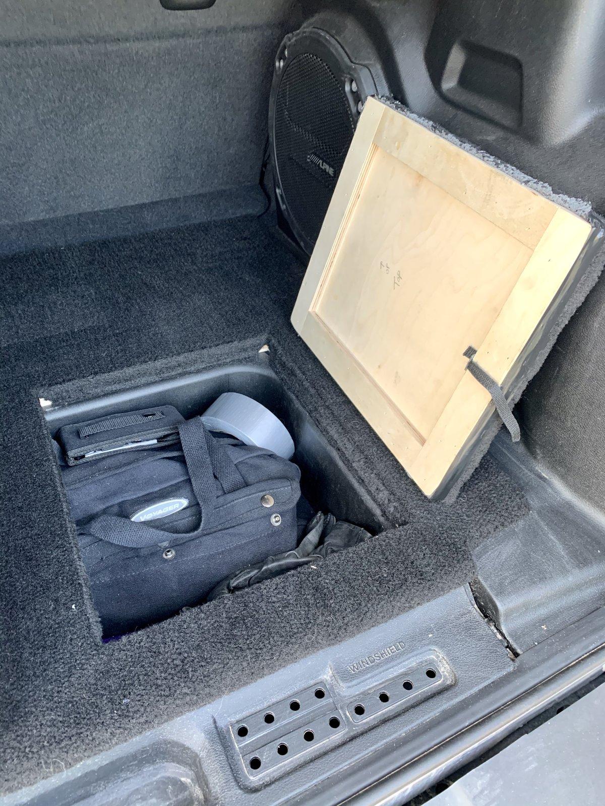

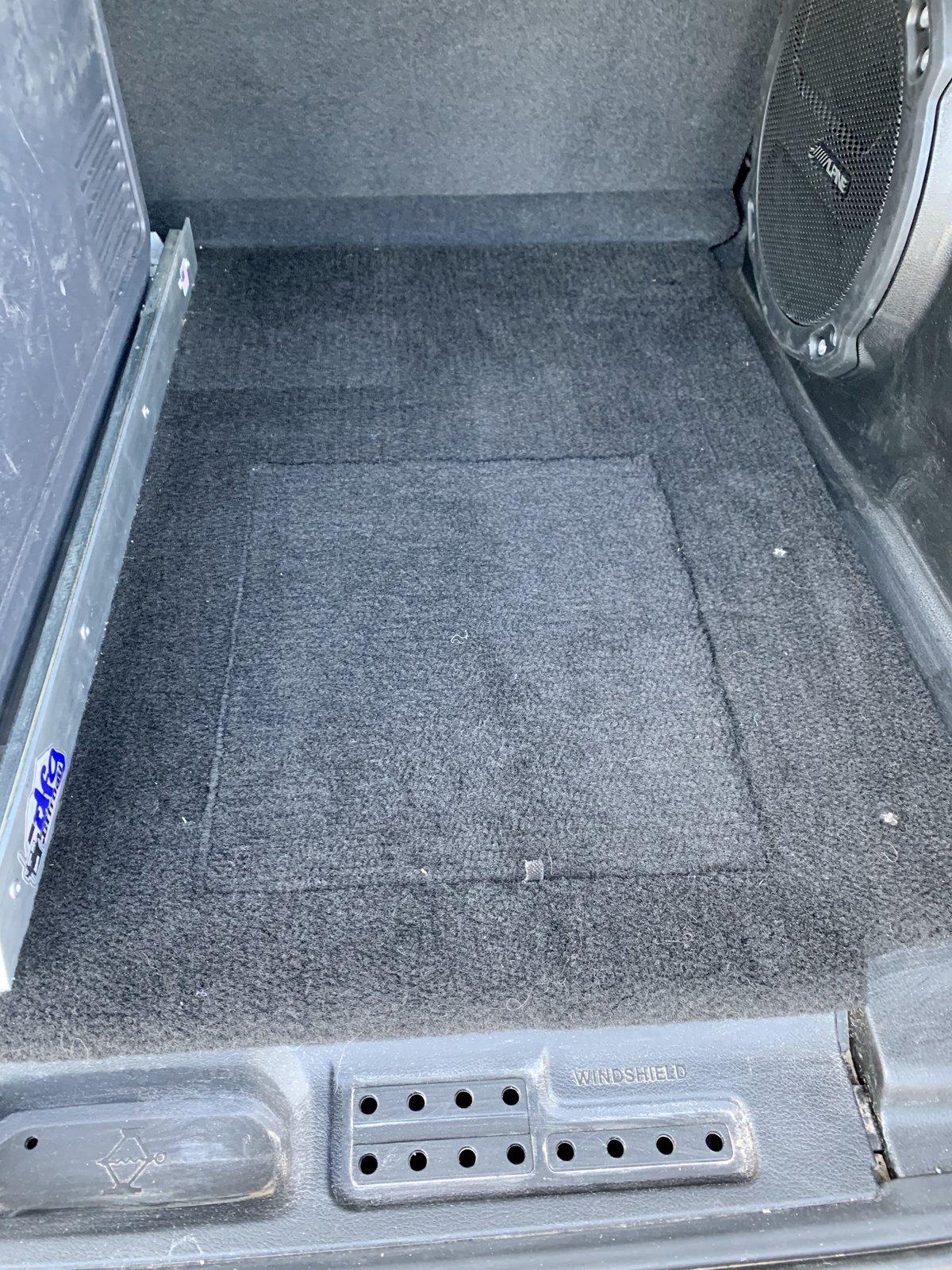

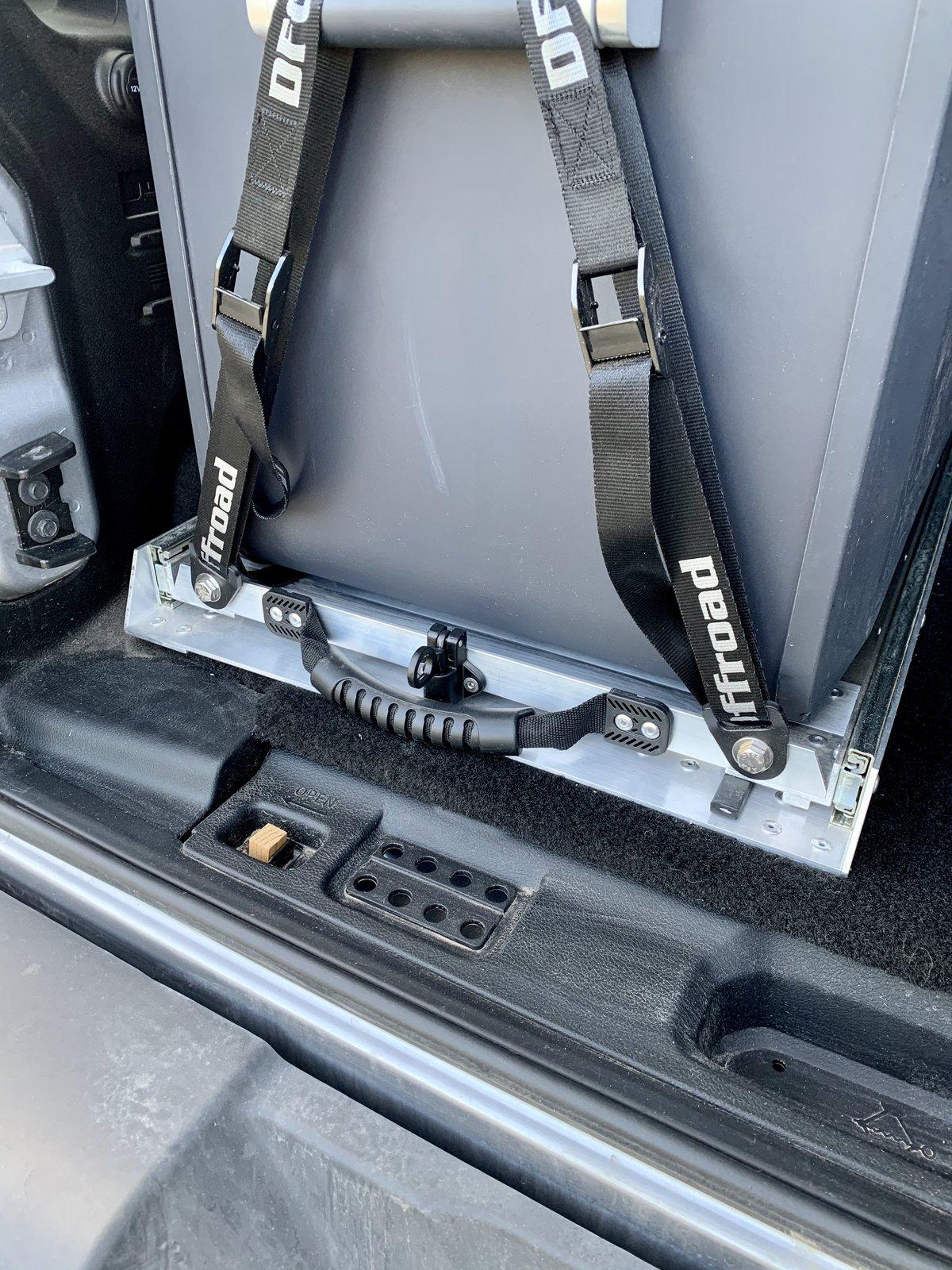

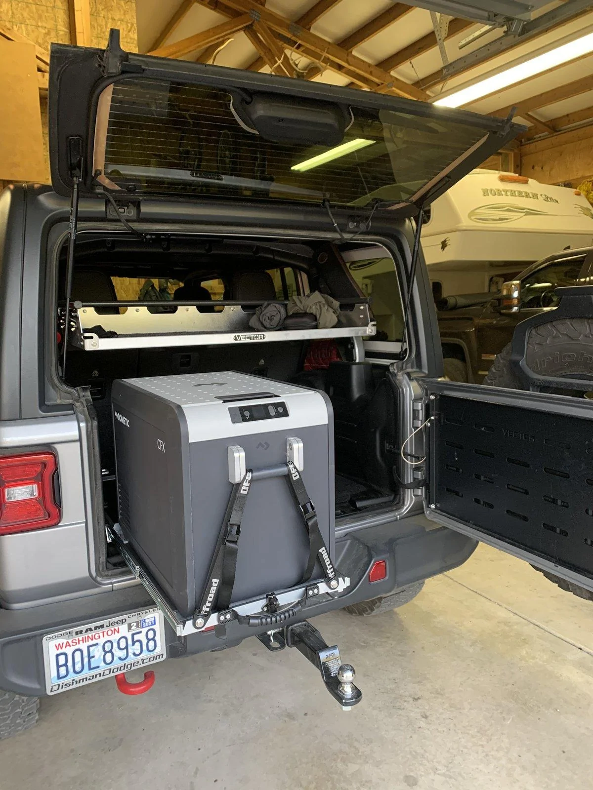

I mounted the slide to the floor. I took out the factory floor, cut a piece of 1/2” Baltic plywood to the shape needed, used the 6 metric hole locations that the tie down brackets used. Picked up a piece of black automotive carpet at Lowe’s and put a door access to the under floor storage. The DFG slide came with 6 screws that were too long. I picked up a 3/4” version of the same screw at my ace hardware. Just screwed to plywood with pre-drilled holes in slide. The floor replacement took a few hours, but the slide install was less than 30 minutes. It took more time centering the slide so fridge wouldn’t rub on seat and tailgate. Luckily, it all worked.
So it looks like you replaced the whole floor, even the sides with the tie downs and not just the middle section. Is that right?

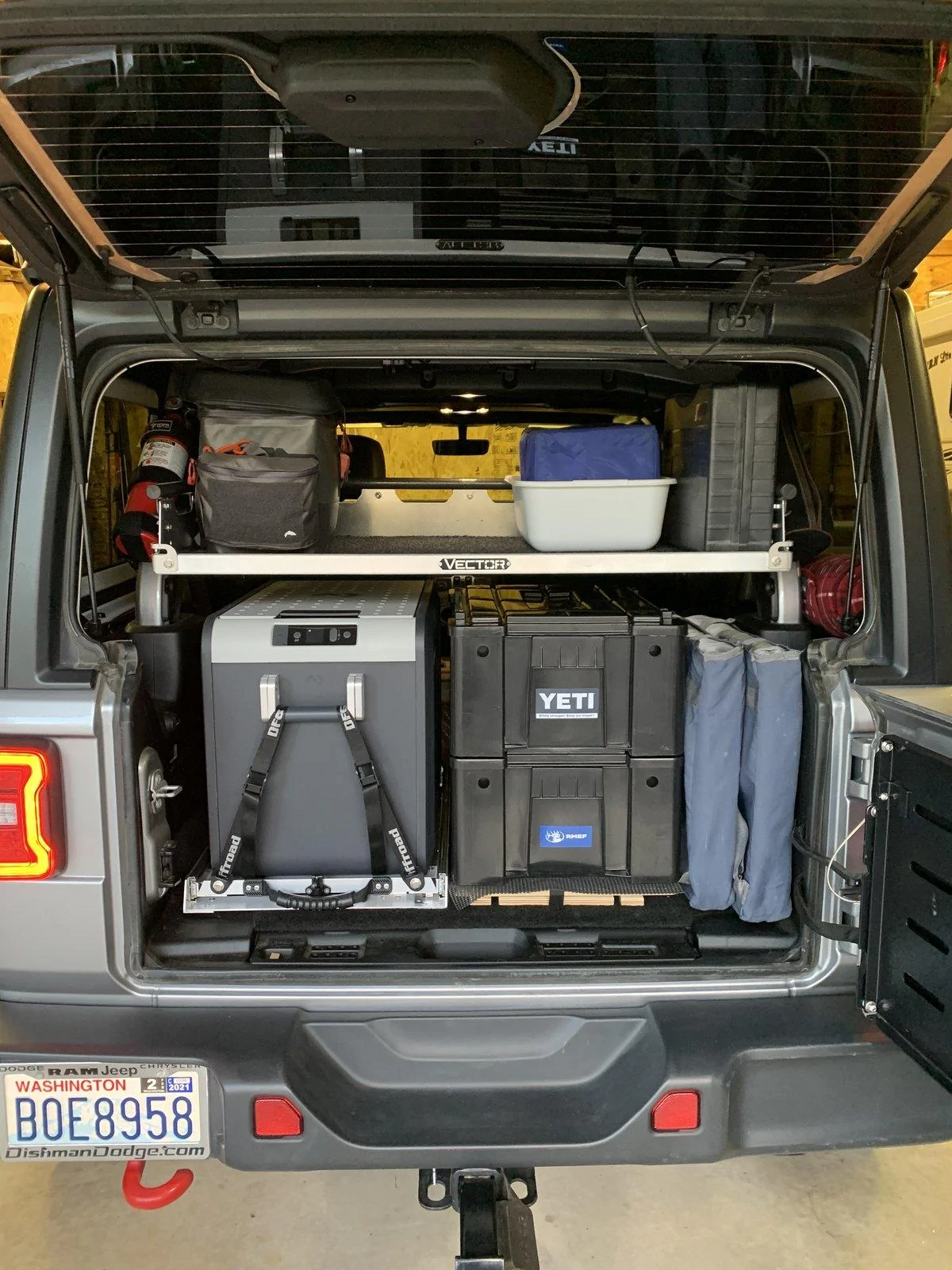

One thing to add. The reason I put the fridge slide on the drivers side was for two reasons. I have a Vector tailgate table, if the fridge was on passenger side, the tailgate table would interfere with slide when folded down. Secondly, I didn’t want to cover my Sub Woofer. The fridge and slide would fit much easier on passenger side if it wasn’t for those two reasons.
Correct, both sides and middle. I kept them in case I sell the Jeep some day.

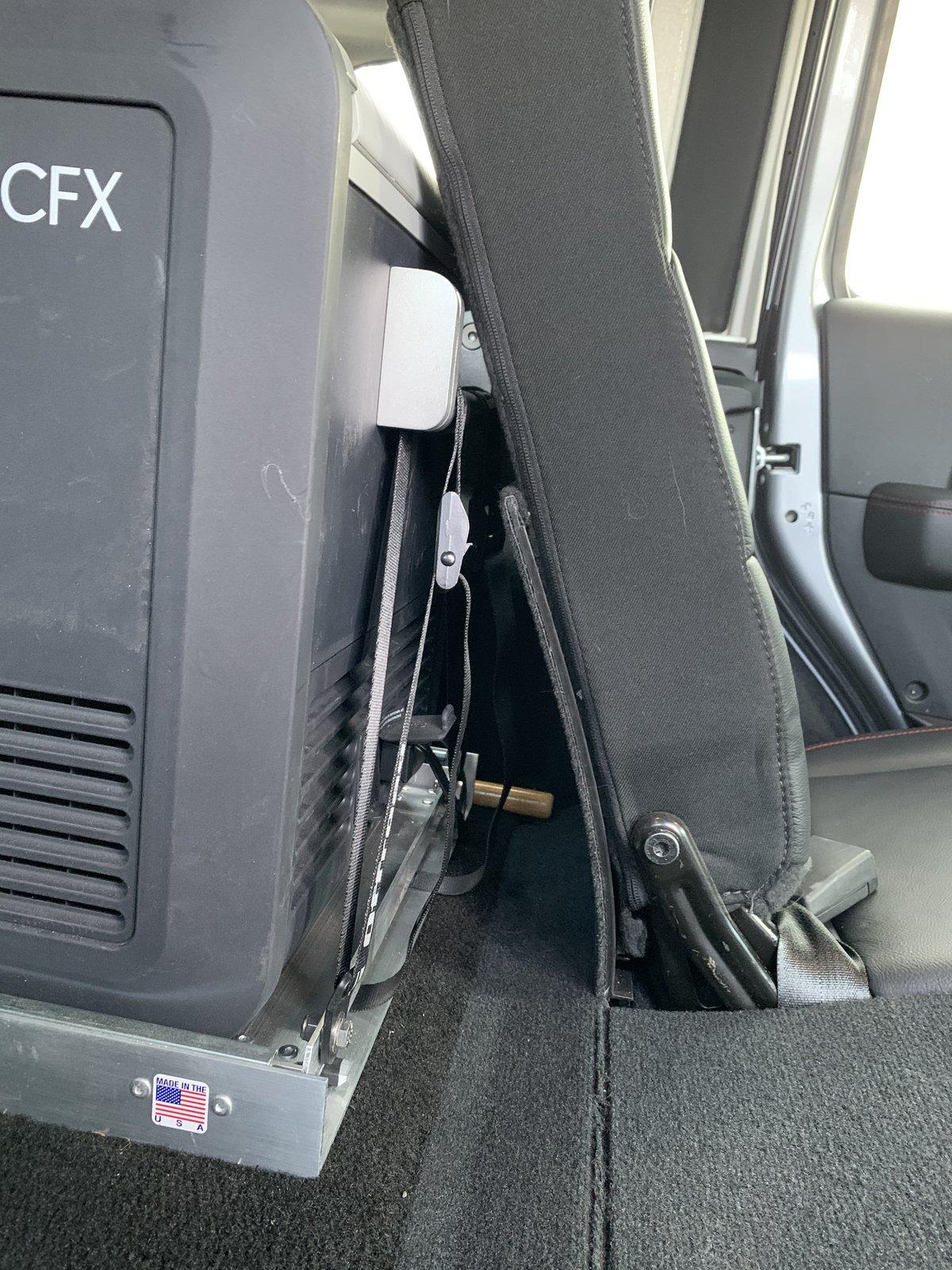

Thanks for the pictures. Do you think a CFX3 55 will fit behind on the drivers side?
Does the DFG slide lock in the slide out position?
Can you mount the fridge to the bottom of the slide with the 4 screws and remove the handles and straps to allow for more clearance?
Do you know how much the slide lifts the fridge up by?
With your wolfpacks in place what did you put behind them towards the back seat?
Also, hard to tell but do you have a seat cover on the back seats?
Thanks
Thanks

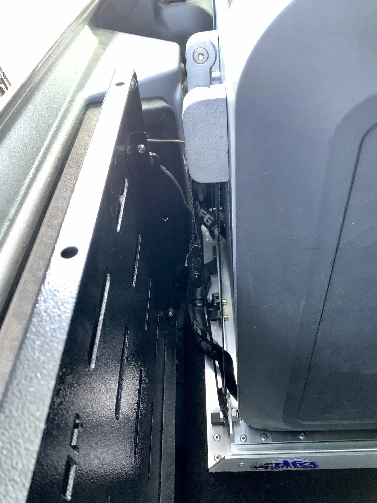

I am pretty sure the 55 would be too big, I think it was taller as well, with the seat slope it would probably hit. I had my Coleman butane stove case in front of Wolf Packs. Love that stove. You would have to drill the slide to mount to screw to fridge. No holes. And yes, the slide locks, there is a small lever on right side that keeps it from sliding forward if parked with front lower than rear. I originally was going to order the Dometic slide, but got tired of waiting for inventory to show up. Dometic kept telling me “next month”. After 3 months i orders the DFG. One nice thing about the straps I really liked was the fact you could take the fridge out of Jeep and bring it into hotel and plug into AC. We stayed in hotel 1 night. It increased height by 5/8” , and no seat cover.
