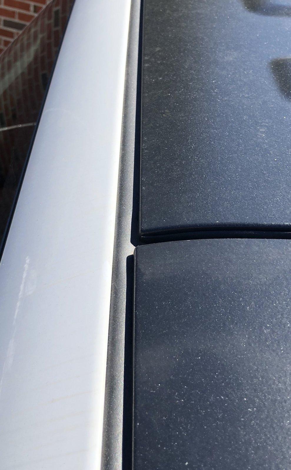

Freedom Top Panels Not Lined Up

This is what the invoice said but the foam was on jeep where freedom tops come together I was told there was a tsb. Will call dealership and ask for details and a proper invoice.
Great, thanks. I will book something once I get the info.

found one video-it showed that there are several adjustment areas that control the freedom top height...loosened a few screws, dropped the bracket...all fixed. love this site.....thank you
I need to see the video. I can’t get my passenger side to close tight enough. The wind noise has increased. The latch that is in the back corner keeps unlatching.
