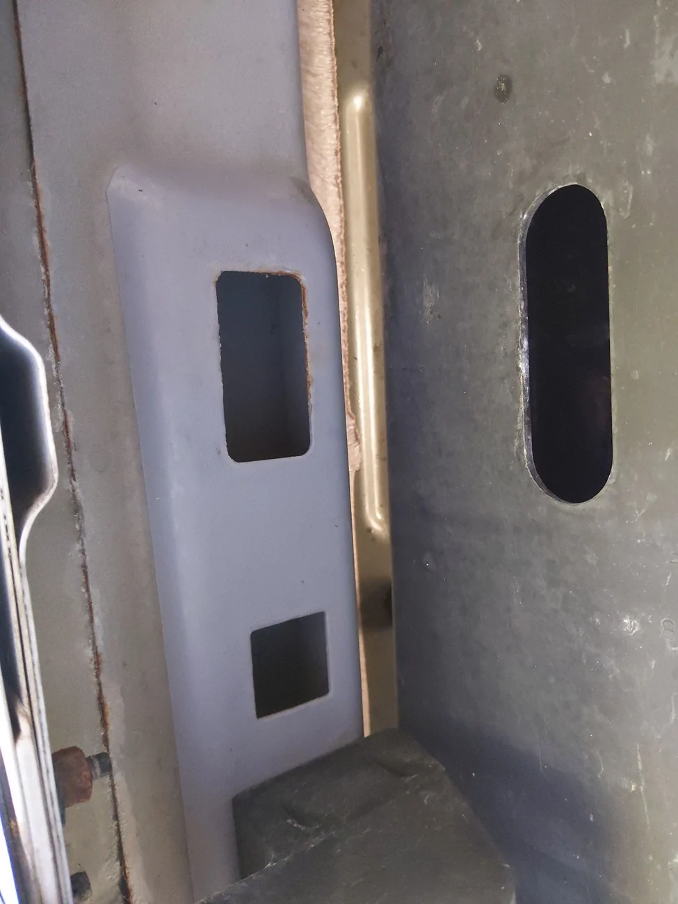

Found some rust starting under the carriage.

Ah ok. I’ll need to get some of that. Thanks again. Is the repair still holding up?
Here's the photo of the repair from the original post 2 years ago.
Jeep Wrangler JL Found some rust starting under the carriage. 1759023645206-a8

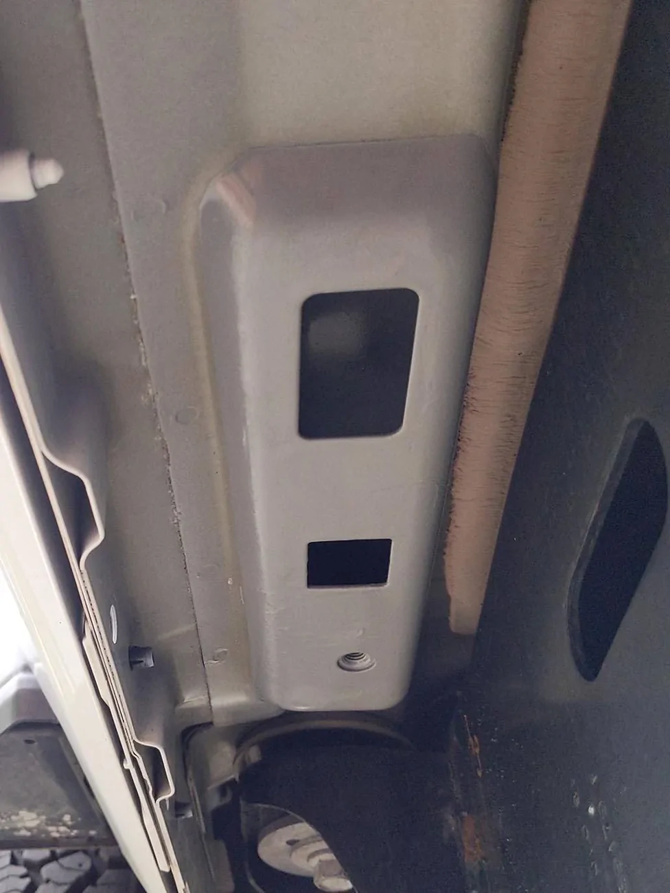

Here's what it looks like now.
Jeep Wrangler JL Found some rust starting under the carriage. jl rocker
Where I fully removed the rust (the square hole) is still good, but where I painted over the factory paint (the rectangular hole) has started to rust.
