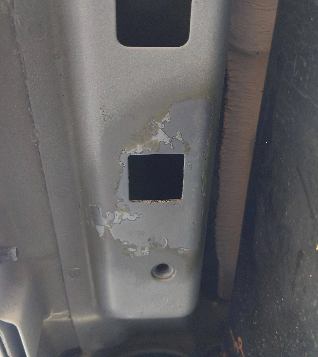

Last year I noticed rust starting on the underside of the rocker and the side step brackets of my 2018 JL.
Jeep Wrangler JL Underbody rust under body rust 1
Jeep Wrangler JL Underbody rust step bracket
I checked my 2020 JT and it was having the same issue. It looks like the thin paint on the inside edges of the square cut outs splits and peels, exposing bare metal.

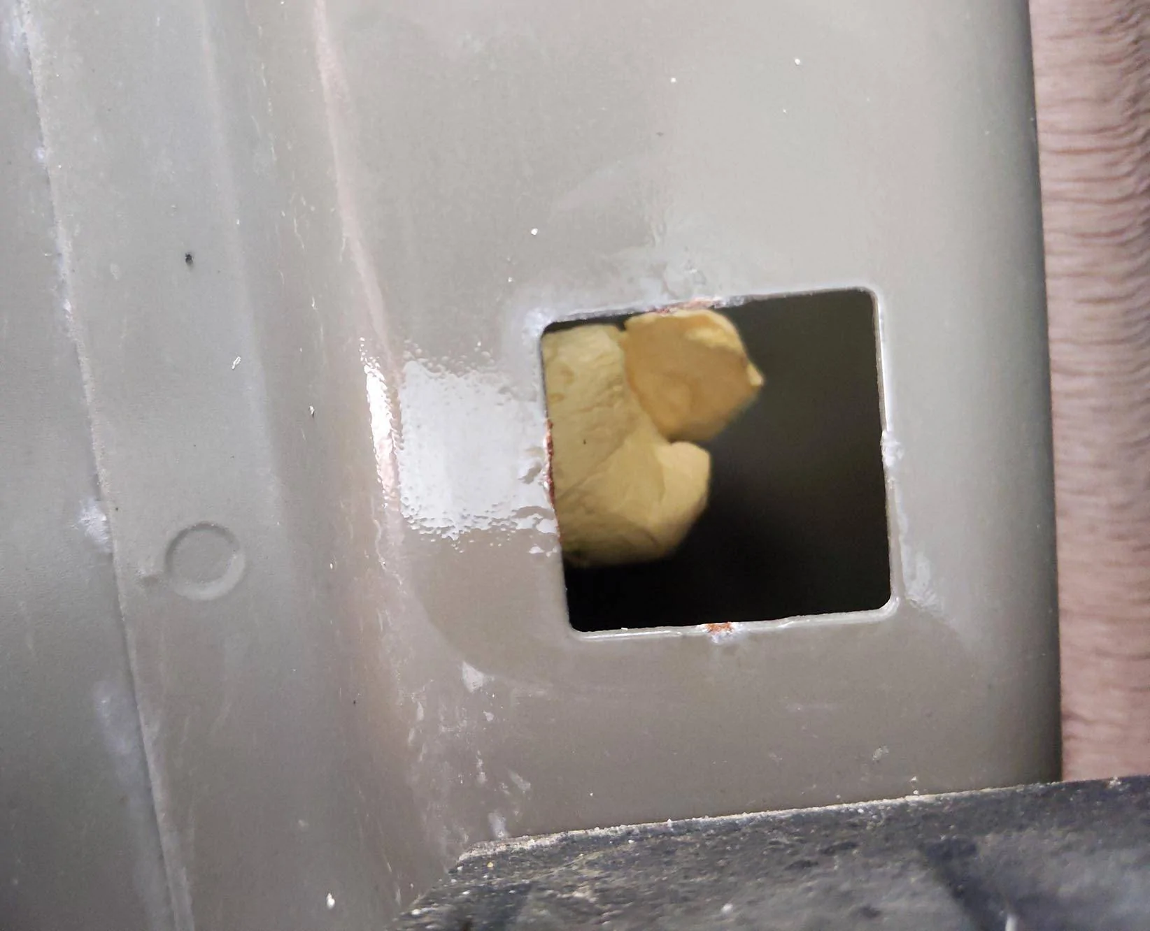

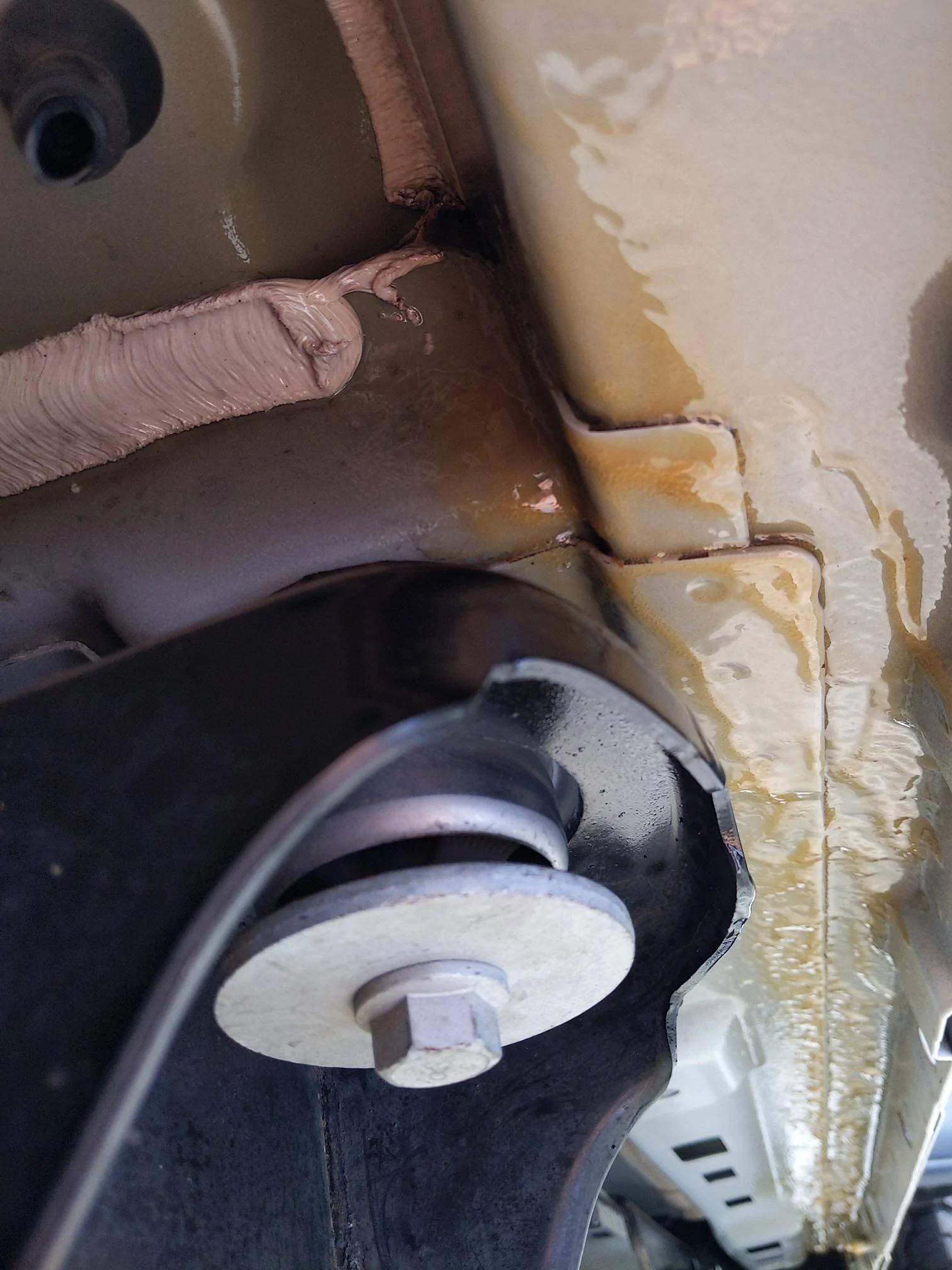

Based on recommendations from local body shop supply stores, I use a product called Phix to treat the surface rust https://ppcbest.com/phix-corrosion-treatment/. It doesn't convert rust like other products, it removes it. After cleaning up the rust I painted it with Satin Coastal Gray Rustoleum.

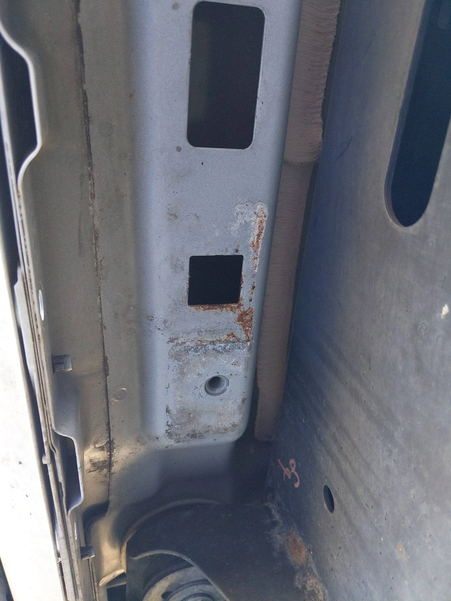

It's been a year and it seems to be holding up.

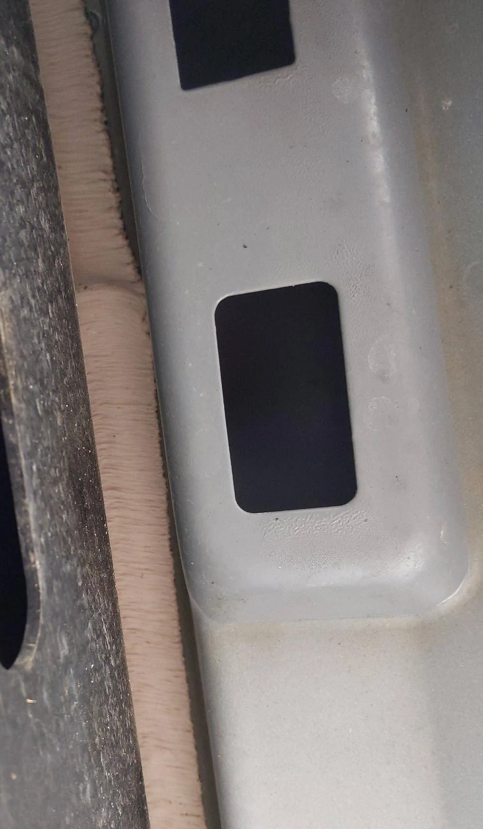

For the step brackets, I just bought and installed new take off steps after some preventative painting of the metal parts of the brackets with a couple coats of Rustoleum.
I was relying on my Sahara side steps for protection from road splatter on the visible surfaces, but after finding this rust I added mud flaps to help protect the underside.

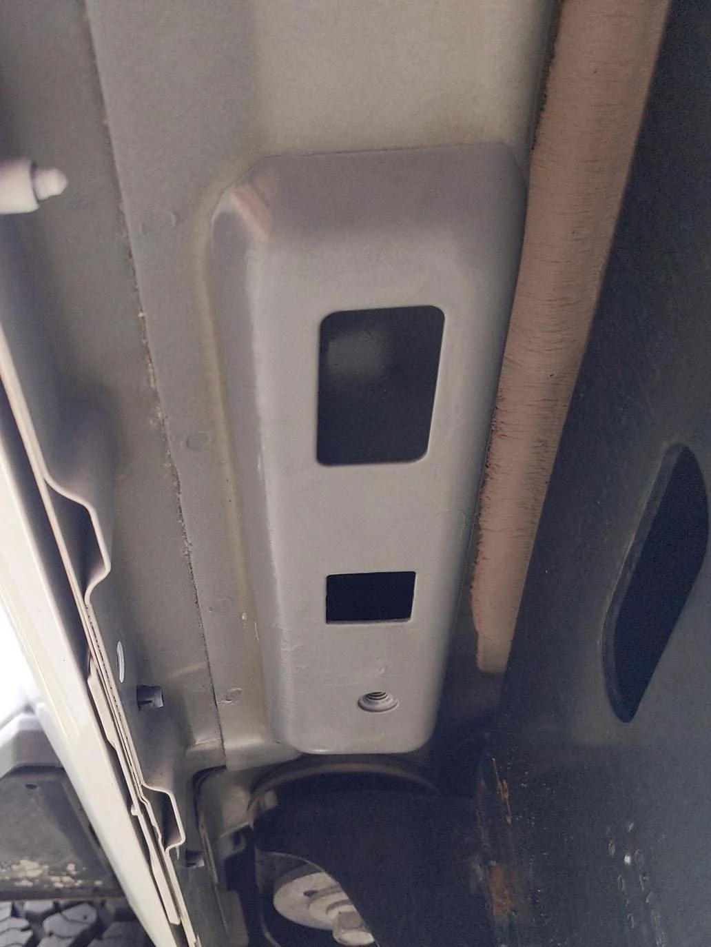

Upon further review, maybe this thread is about treating and preventing rust from the perspective of an untreated 5+ year old JL and an untreated 3+ year old JT.
Knowing what I know now, if I was going to apply some kind of coating to the underside of my new Jeep, I would focus on the underside of the rocker panels. The square cutouts and seam are the only places where I've seen any rusting of the under body sheet metal.
After I spotted the rust on the JL rockers, I decided to treat the seam on JT rockers. I should have put it on the ramps to get more clearance before spraying., I ended up being too close and sprayed it on thicker than I intended.
