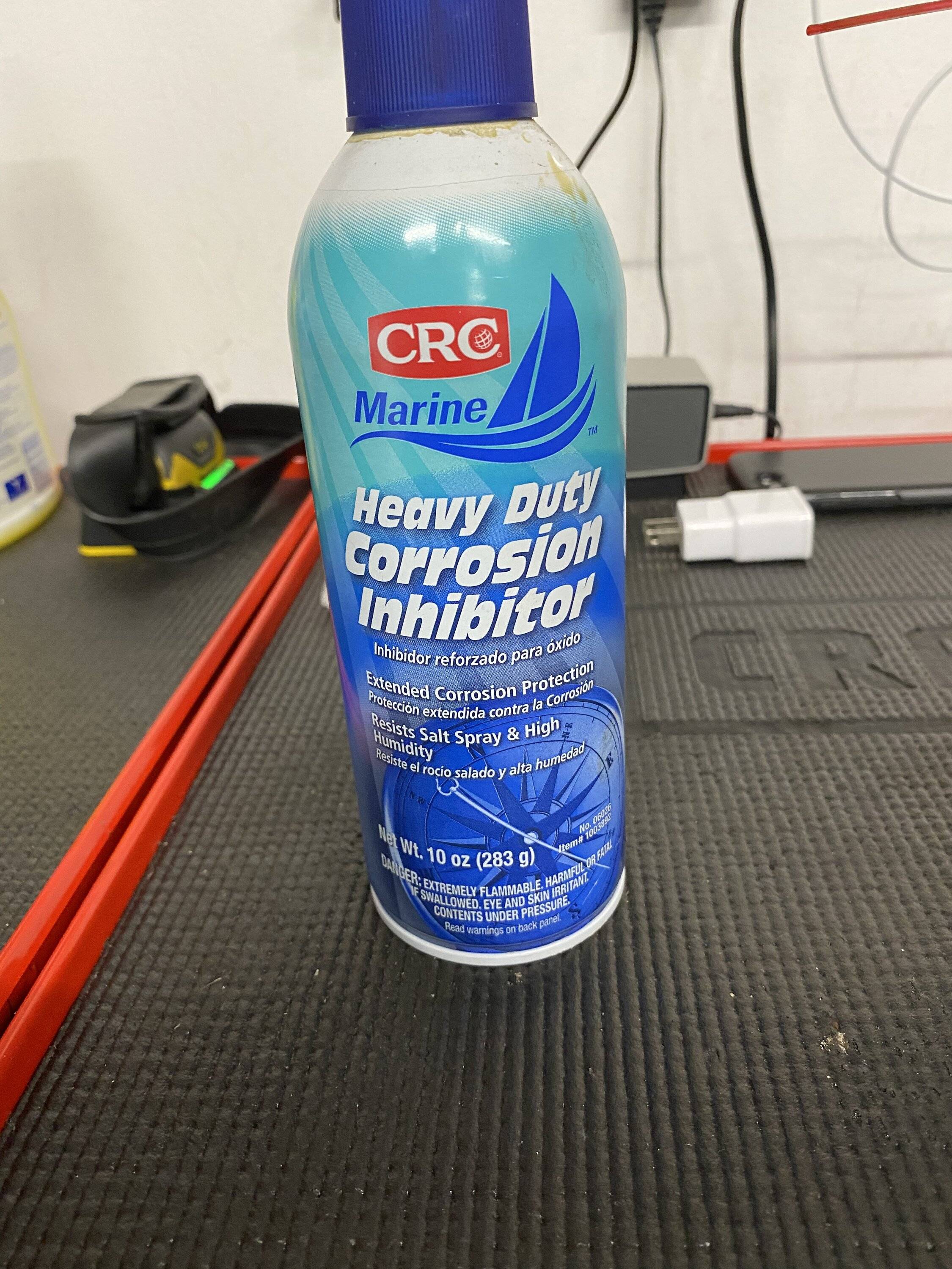

Another great product…
Jeep Wrangler JL Full underbody cleaning/regreasing BBDC423F-0B6D-4ECF-B5D7-3D9E207D613D
