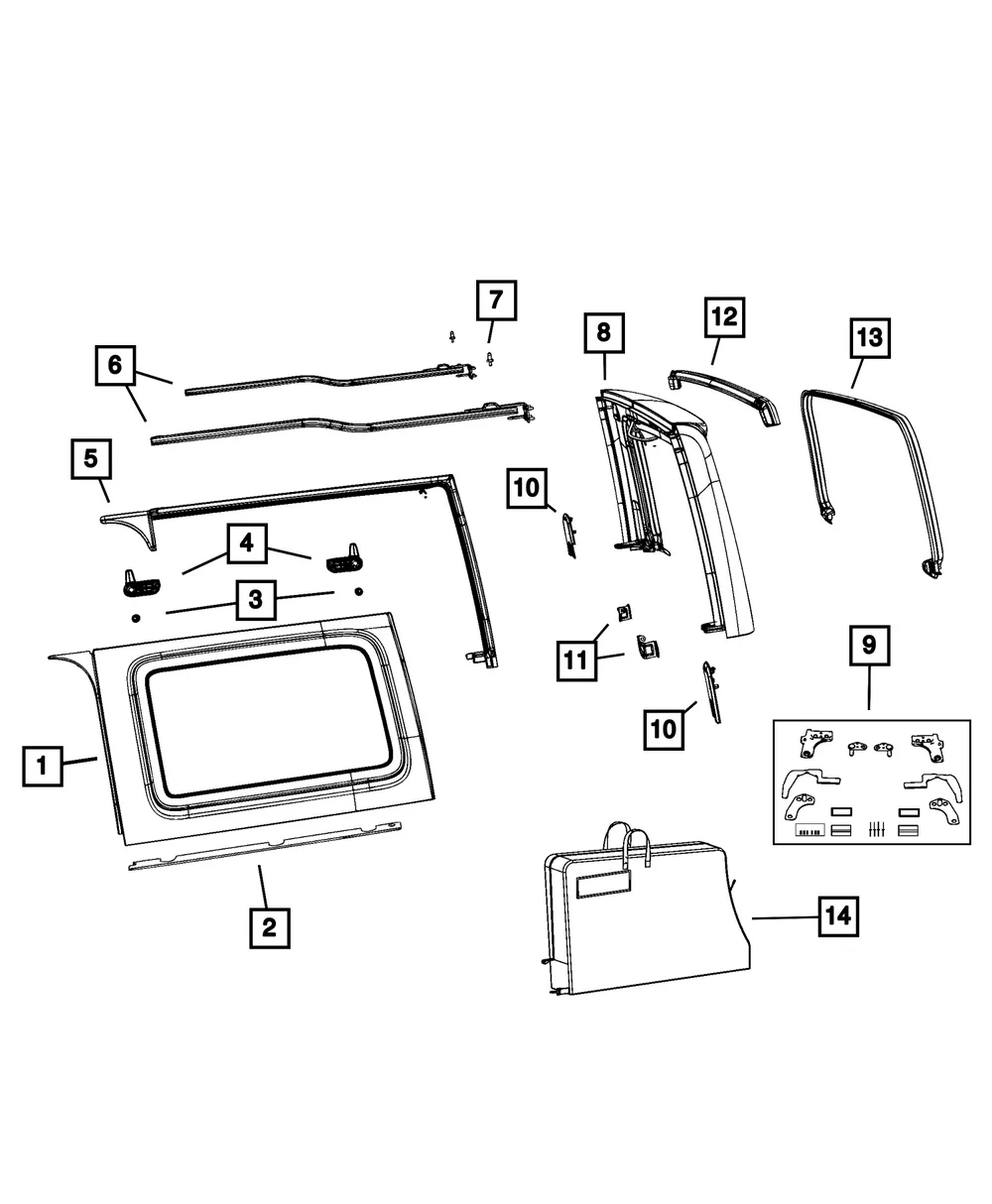

The "Folding Top Rear Panel" is #8 in the diagram.

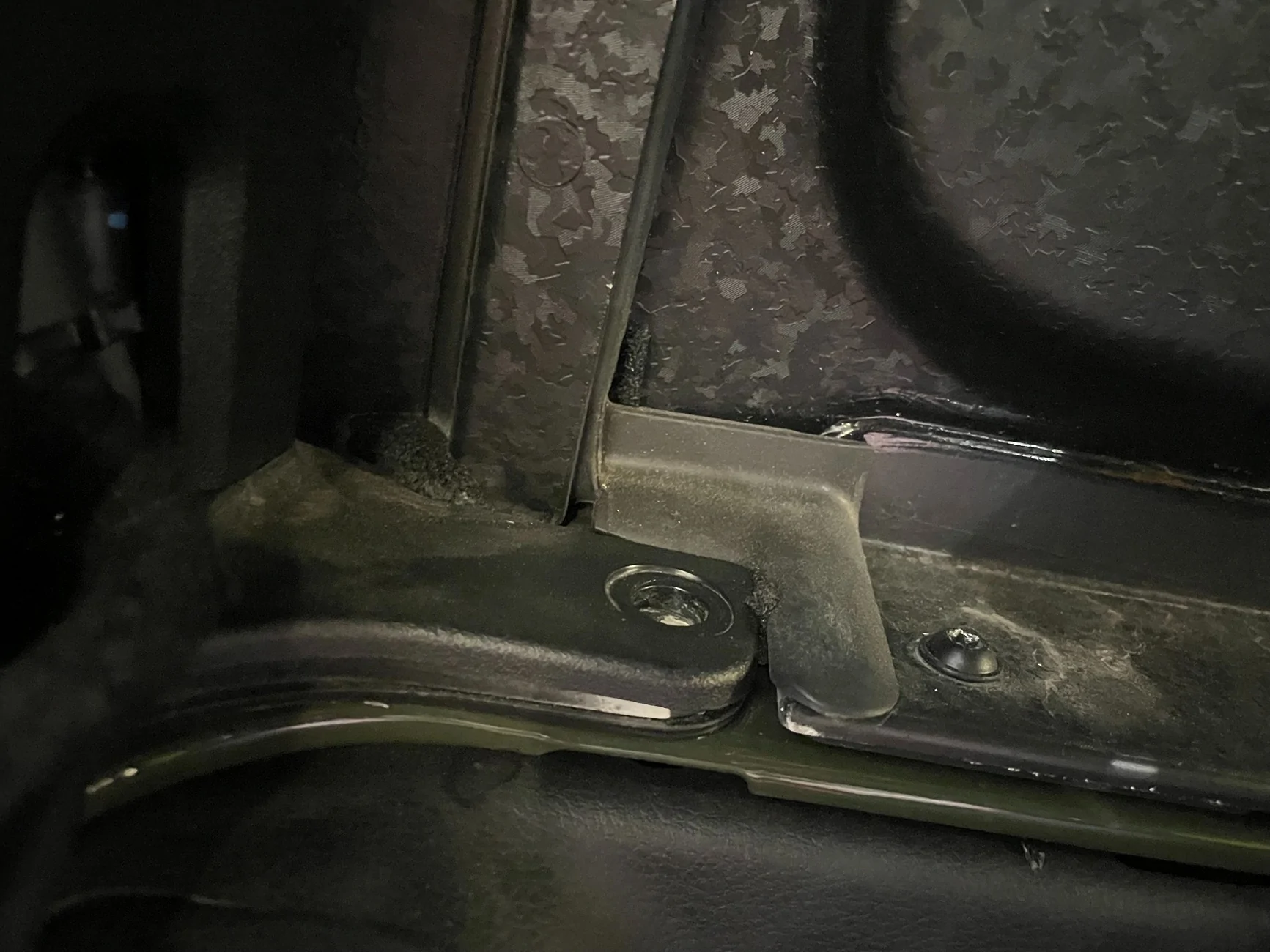

Here's a view of the actual interior and where the bolt connects to the body:

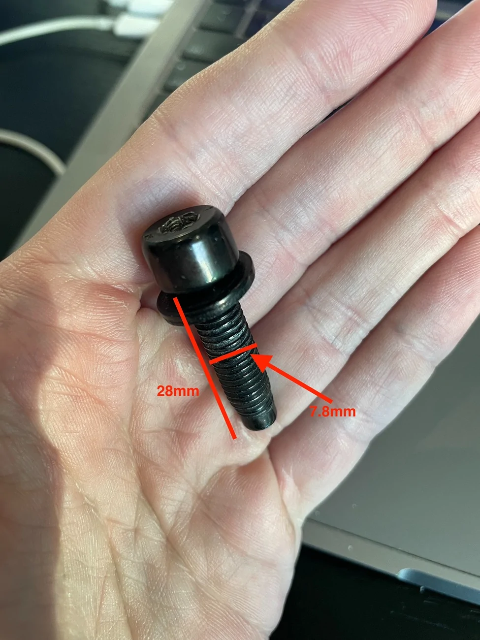

Here's the original bolt:

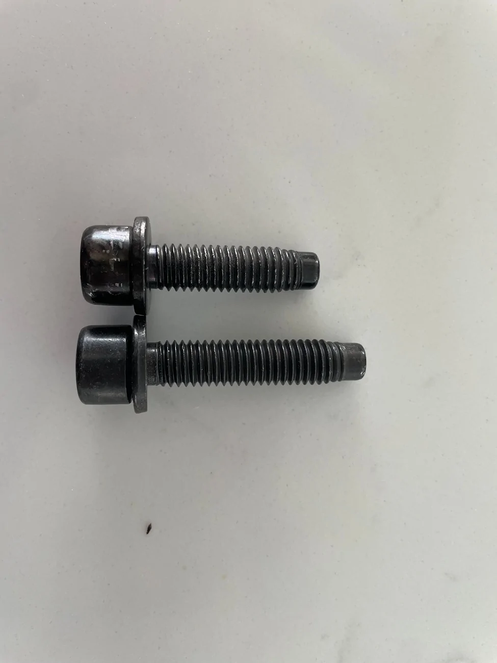

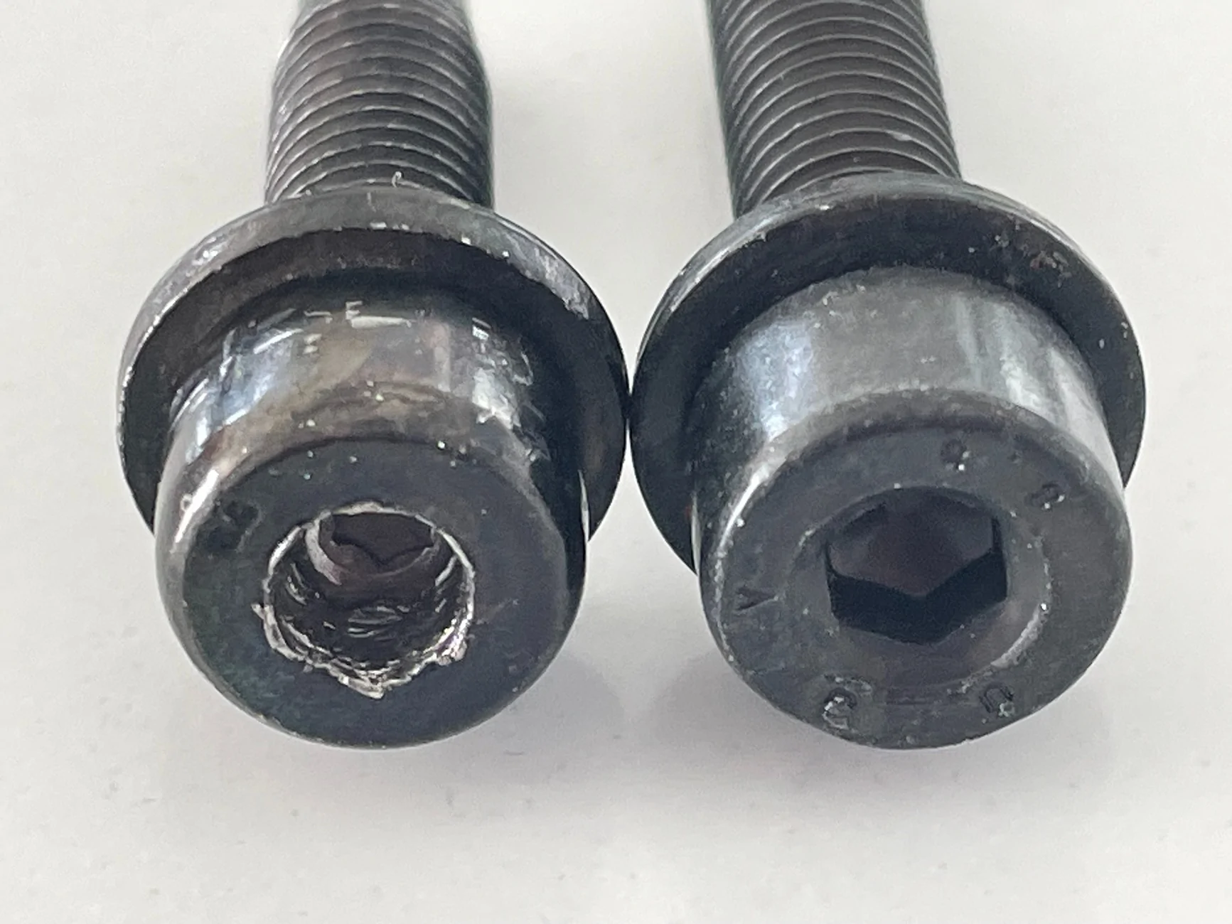

They arrived today. The original bolt is on top. The new one is on bottom and, as you can see, is longer:
Old on left, new on right:
The good news is, there is a void below the bolt, so these new ones work just fine and my rear panel is secure again.
