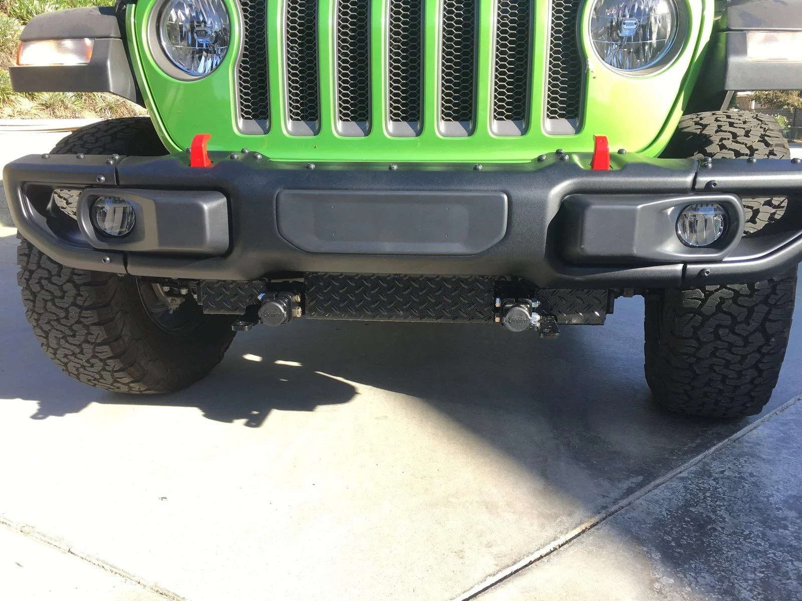

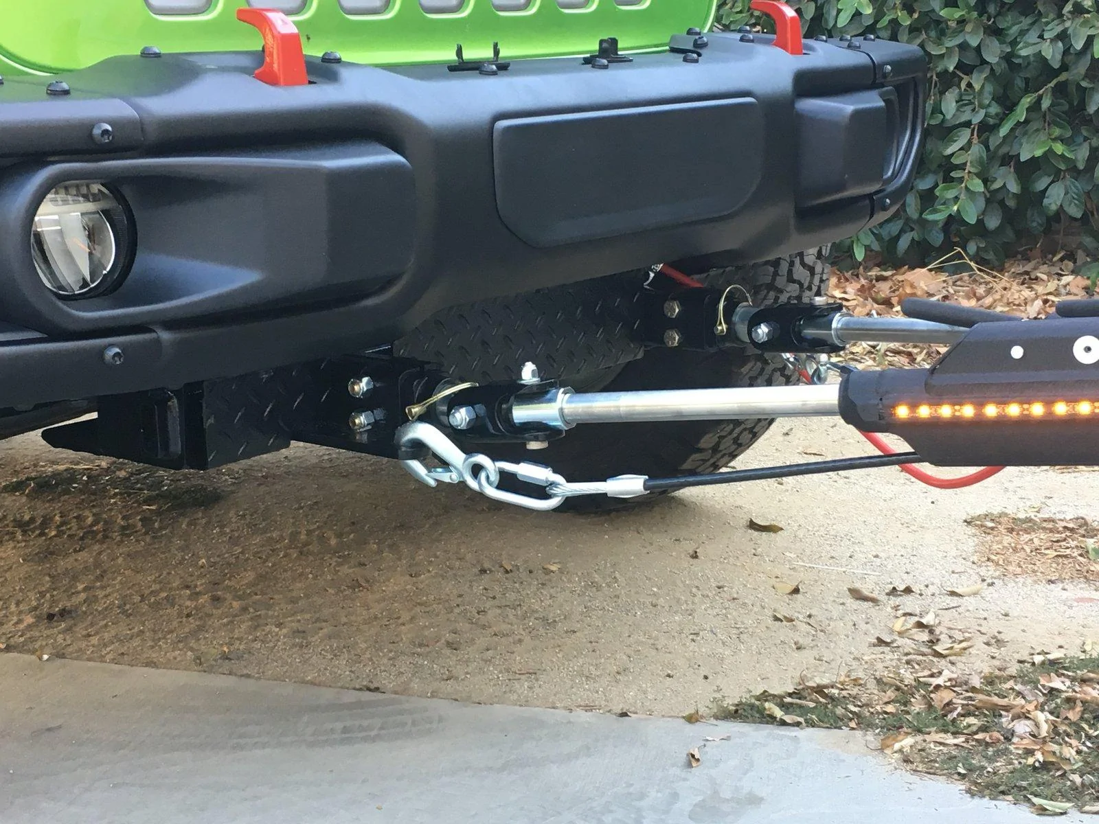

Got any finished pictures of the Demco base plate installed? I assume you bought adapters to make it work with the Roadmaster tow bar? So many options...
I was planning on finishing it up on Saturday. I'll post some picks when I'm done. and yes adaptors. I will post pics of that too

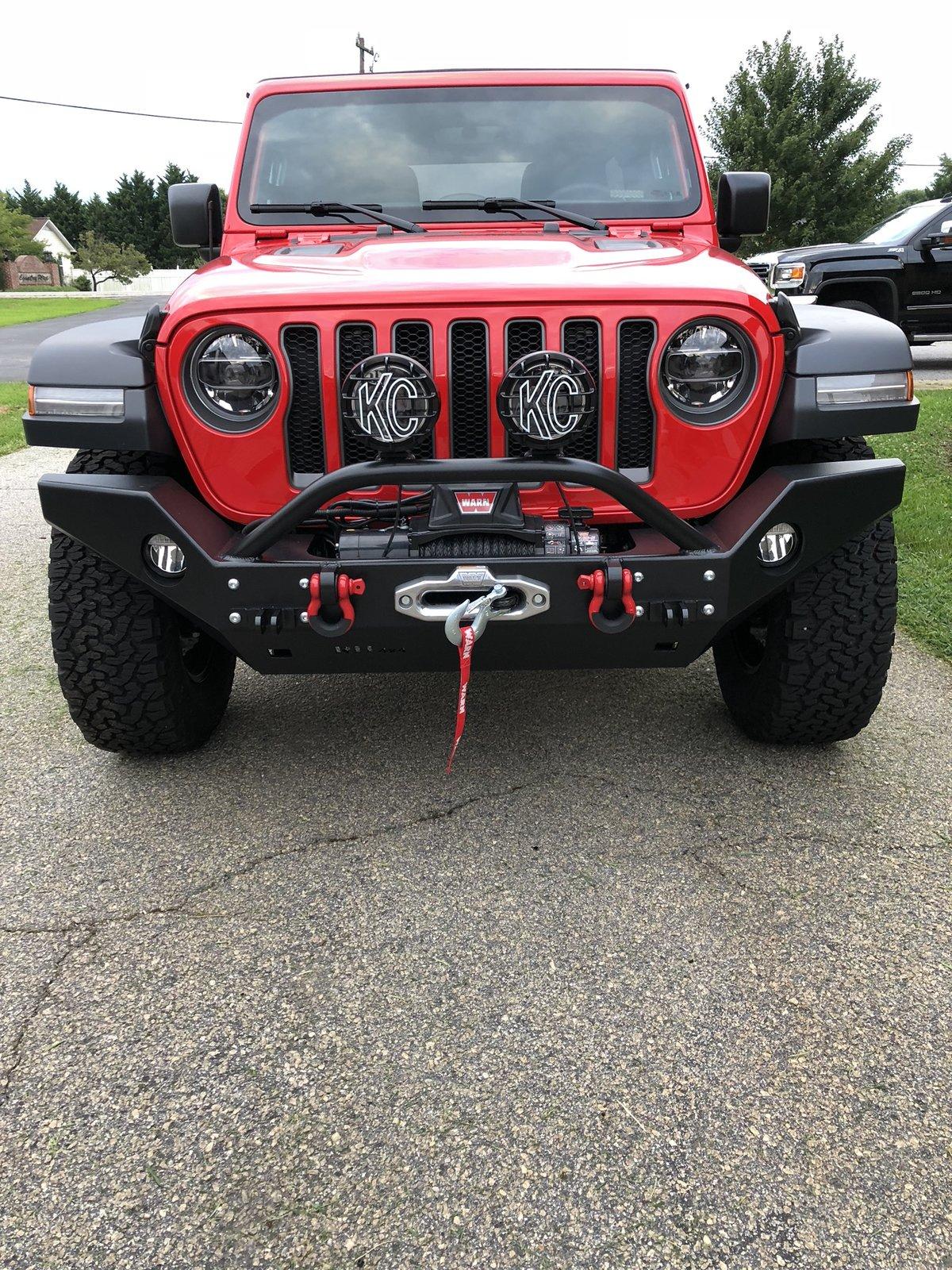

I have the Rock Hard front bumper with tow tabs. I think Blue Ox has a tow plate for the JL. I saw one recently but can’t remember if it had the steel bumper. CoolTech make a very good wire harness that is an easy install.

I went with the same setup as Luco. Couldn't be happier. Only I went with HF magnetic lights because the Jeep lights are blocked by bicycles. BTW, the RockHard bumper was recently deer tested and came through perfectly. Deer not so good.

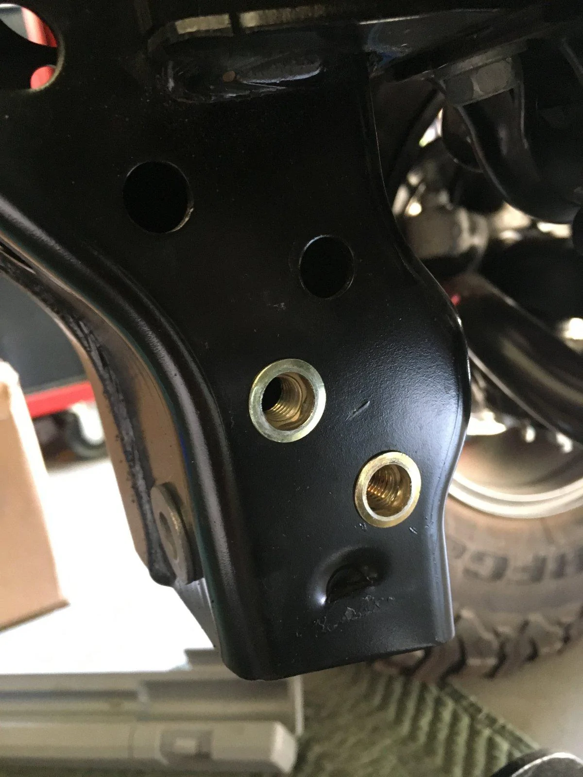

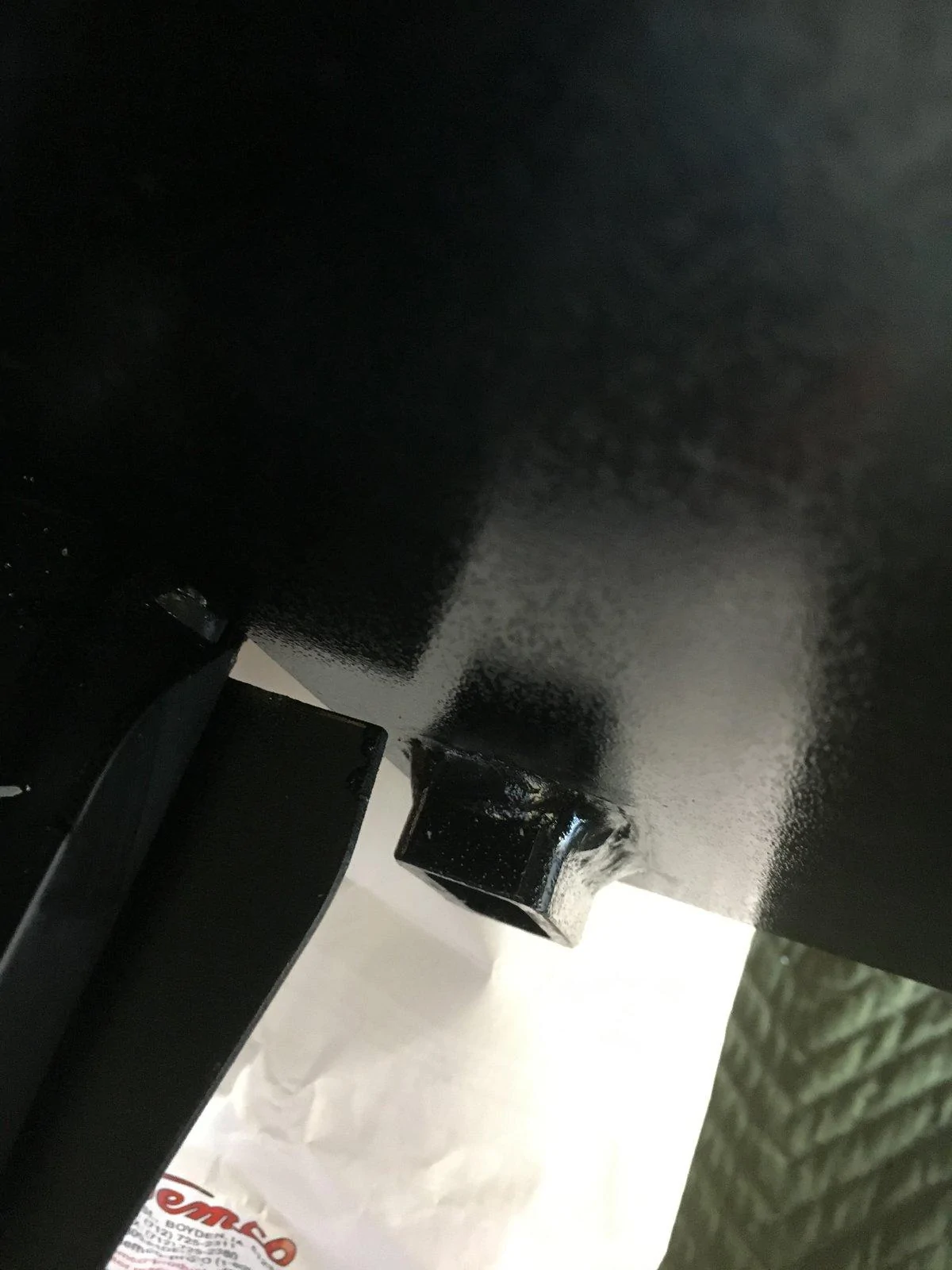

Crap.... I guess it will be another week. My stock set up was with a plastic bumper... I bought the steel skid plate mount bracket (see pic) but my frame doesn't have the nutserts in the frame for the bracket. Now I have to figure out how to get my hands on those and install them first. I going to be real good at taking bumpers off if anyone needs a hand... haha

Well hurry up, I just ordered my Demco base plate :). I decided to go with the Dominator tow bar, RVi3 brake system, and the CoolTech deluxe wiring setup.

Yeah, so You can't buy the "rivet certs" from the dealer. I will order those today online. I bought the RVi3 too.
Broccoli2
Aug 27, 2018
140
156
Santa Clarita
2018 JL, 2011 JK 1946CJ2-A

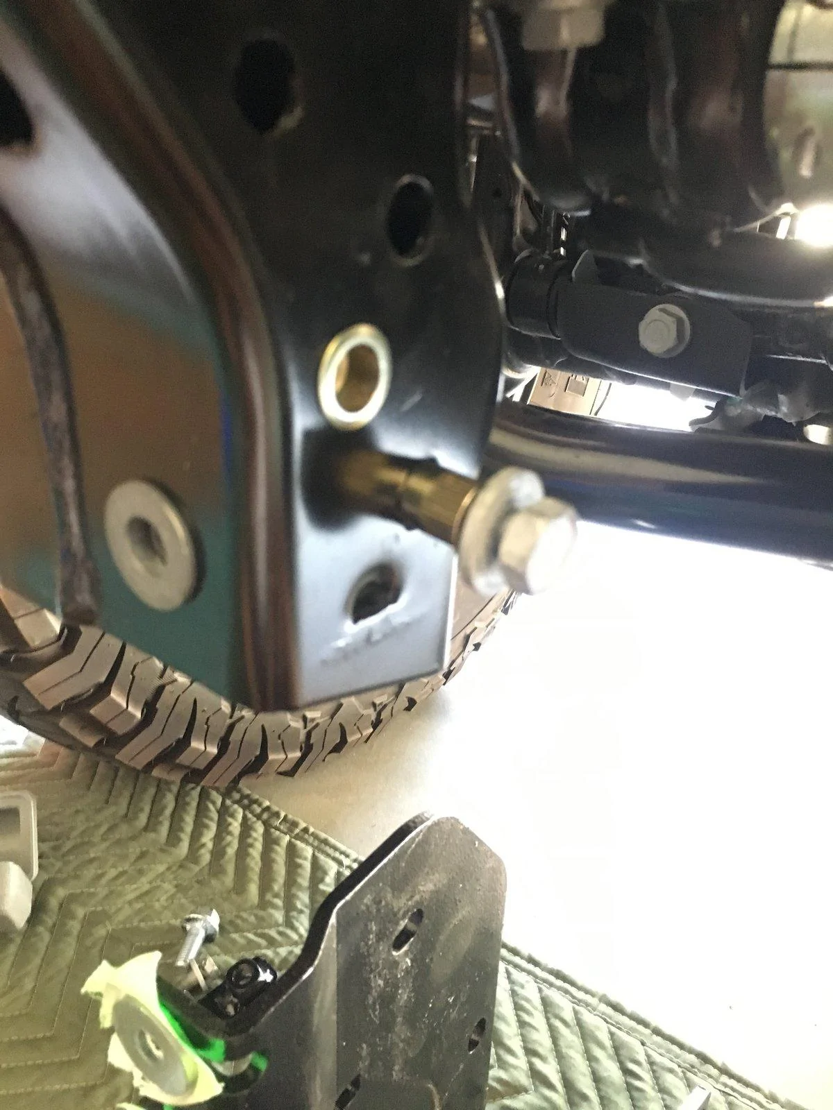

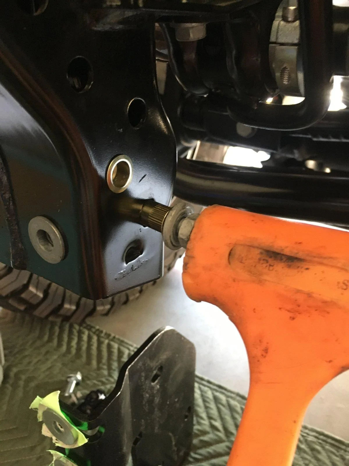

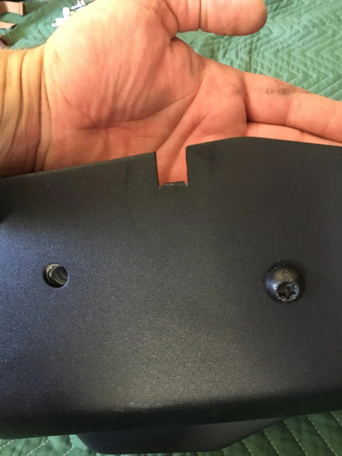

OK, got the nut certs today (rivet certs). I ordered M10x1.50. they fit perfect. I used one of the original bolts and screwed it all the way in to the nut cert and tapped it with a hammer. I included a picture of 2 nut certs, one that is collapsed and one that is not for those that don't know how they work. Easy install up until the supplied skid plate from Demco. If you lay it on the ground in front of you with the part with the cut outs that attach to the bumper towards you and up. Both outer mount points were not even close to lining up with the holes. I had to take it back off and persuade it with a large rubber mallet. They both needed to go "in" and the lip needed to be flattened out. It is possible this happed during shipping, but both were exactly the same, of). You can slide the bumper on a bit to mark where you need to cut. I had to cut the bumper twice as the directions didn't really say.. I attached the wrong pic, the cut with my hand behind it is too short. The reference is, the skin is aluminum, on the inside of the bumper there is a steal support. I cut about an 1/8 into the steal support. (You will understand when you do it)
