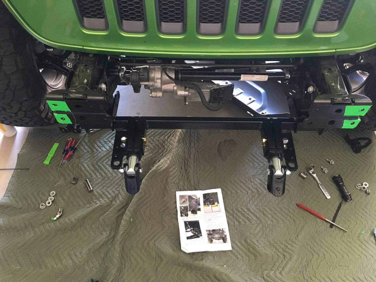

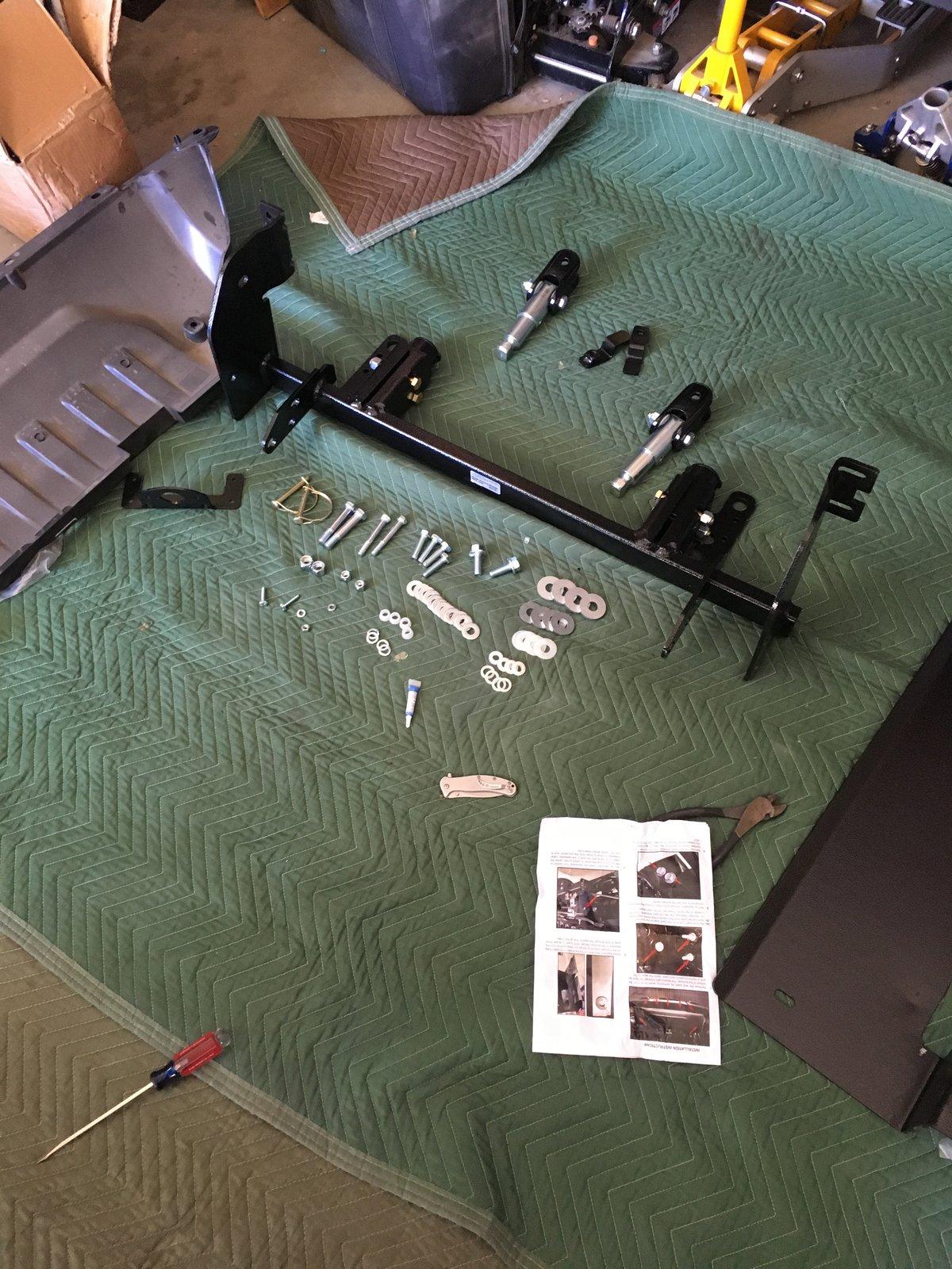

I am in the process of putting the demco on. My Rubicon came with the plastic bumper. i have bought a Stock Steel bumper so that the Demco Skid plate works. The reason I went with the Demco is so I can have the steel bumper with a winch. No other Baseplate works with a winch on a stock bumper. ie.. The demco mounts to the outside of the frame rails all the others mount to the inside. I also had to buy the Stock Metal skid plate mounts as the Demco skid plate mount to the stock Steel skid mounting spot. I have to swing by the dealer on the way home and get the parts so I can finish it up... Oh, I went with the Roadmaster Night Hawk all Terrain tow bar

I have a Rubicon with steel bumpers. The blu ox adapter fits on the outside of the frame. I installed both a blu ox adapter and a warn winch plate at the same time. I did have to modify the skid plate to fit around the adapter.
Wow... I was told it mounted on the inside... oh well. I guess you always have to do your own research
