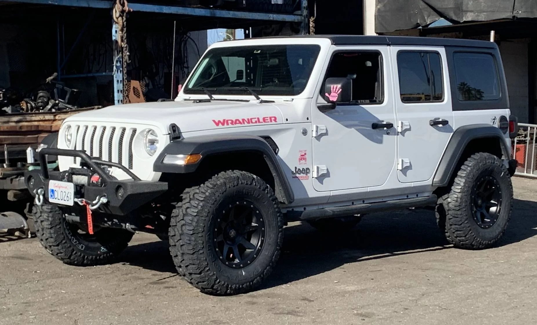

I drove around on 37s with just a 2.5” spacer in the front for a while. It’s doable, but I honestly think you’ll want a little more lift. My wife’s JLU has a 2” lift all the way around on 35s and that seems to fit the bill perfectly. I wouldn’t add any more tire to hers at this height.
