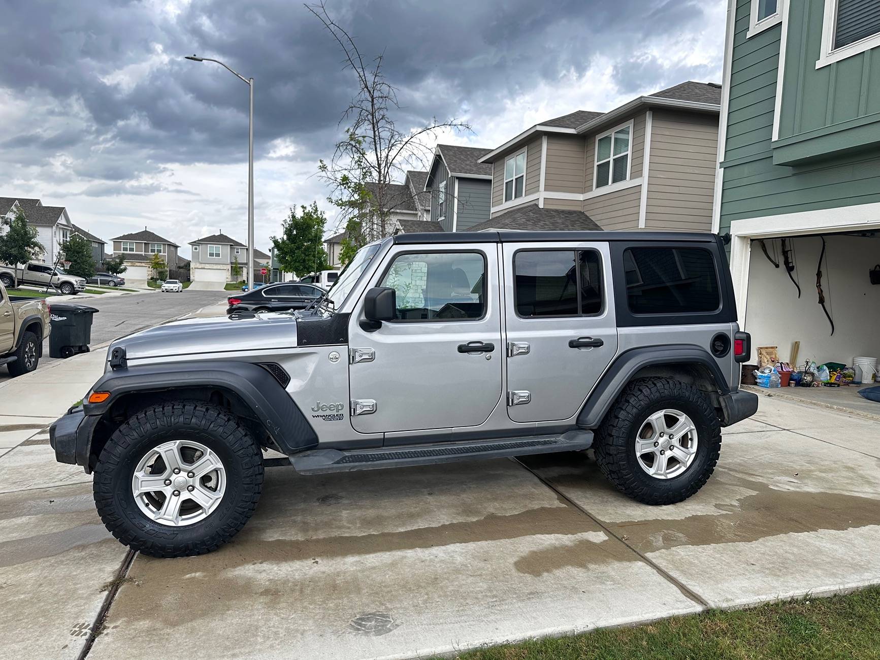

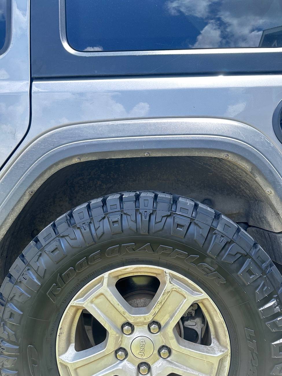

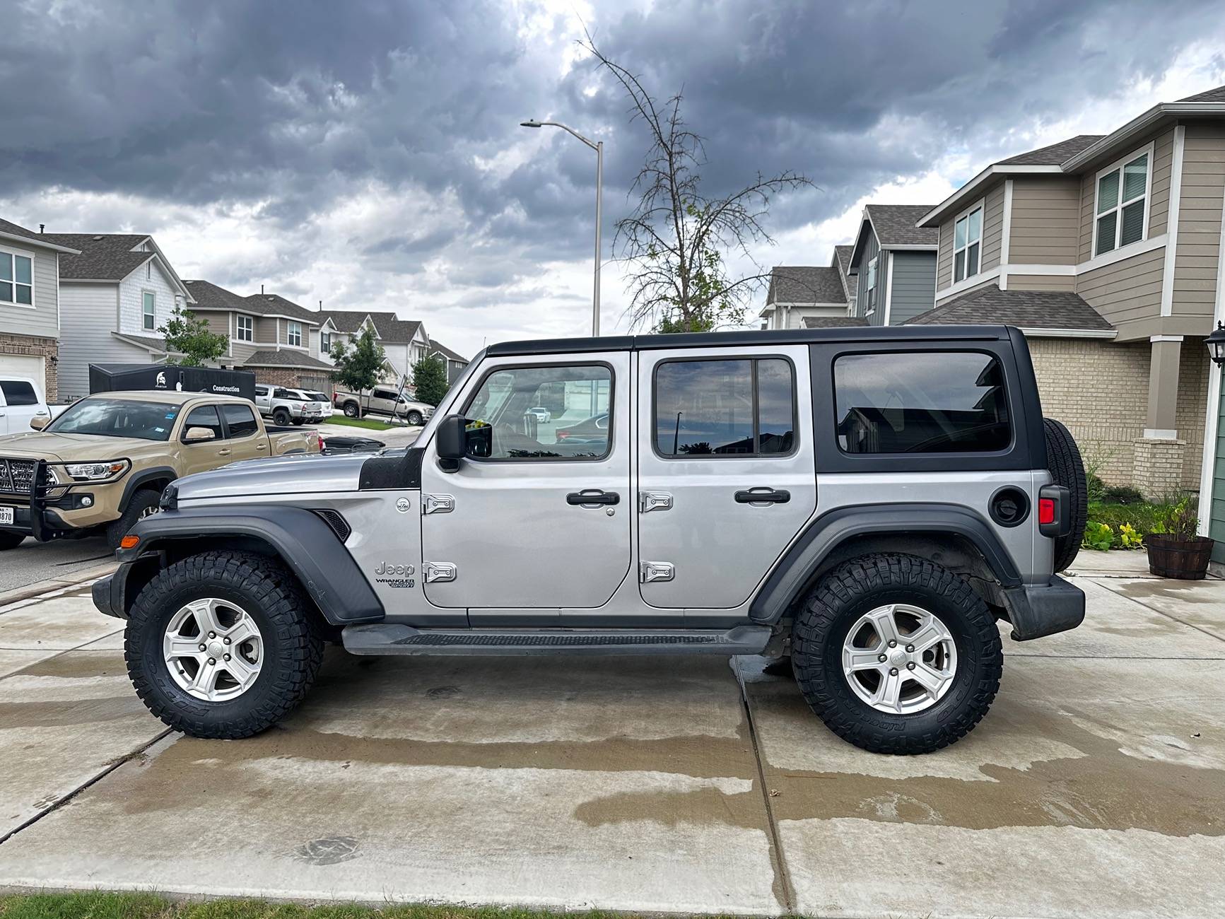

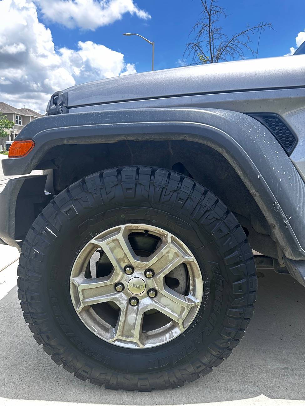

I’m new here and I just threw on bigger tires as a first step on the build. Wanting to do a lift next. My plan is occasional light off-roading with the family and maybe camping. Doing a lot of highway miles for work as well.
I went with the 285/75/17 Nitto Ridge Grapplers on the stock wheels. I’m currently back and forth with a 2.5 vs 3.5 inch lift. Would like to hear what everyone has to say and pictures are definitely helpful!

Just do Rubicon Take offs. you will gain about an inch to 1.5 inches of lift for your sport. This is what I did and its plenty. Id only upgrade taller if I was going larger tires and before I do that, I would re-gear, get the right kit to help with caster and probably new drive shafts to be safe. 2.5 inches you probably wont need drive shafts, but do the lift right. Your Daily work commute will thank you. Till then RUBI take offs is my suggestion. After that if you think you need more at least you dont have much invested to start
