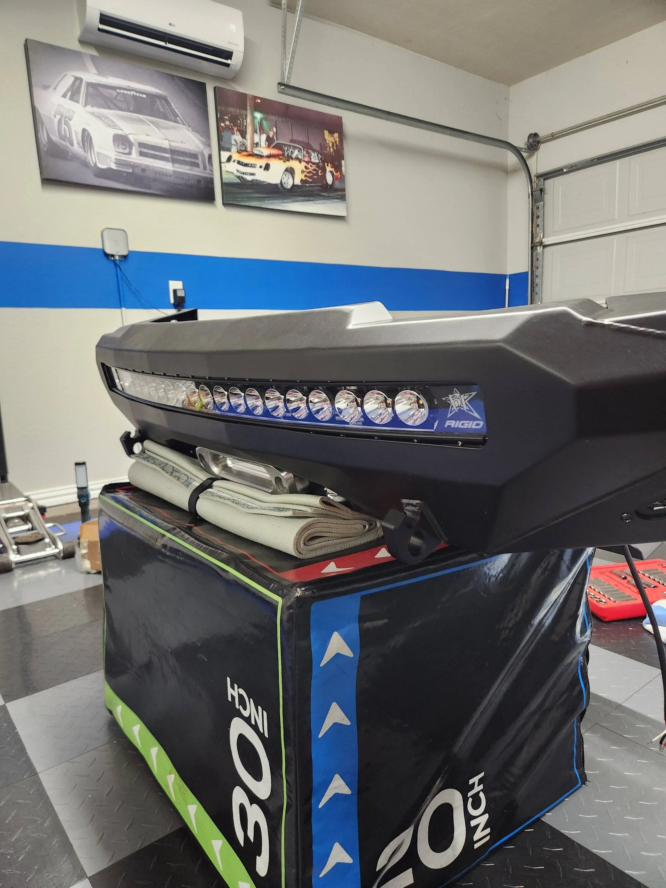

I just did the winch and winch kit and ARB compressor on our new Rubicon last weekend. All in all, it went pretty smoothly.

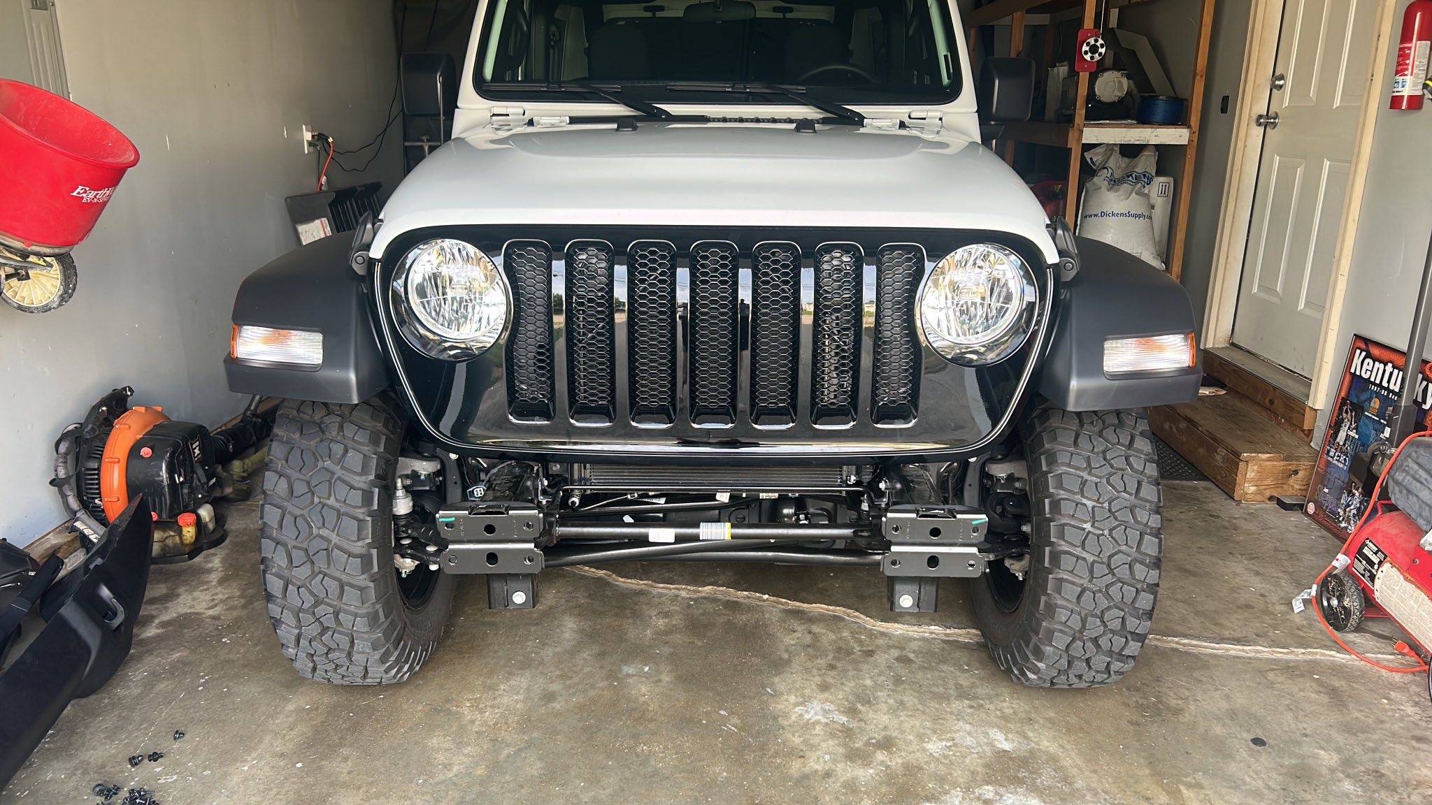

First mod (bumper replacement) going on today!
The bumper and winch will be here today, but I’m prepped for installation!
Will update with follow up/progression pictures!
Don't be like me and get stuck if the hook bolts don't align with the plates at the end of the frame rails... you can loosen the the plates loosening the the bolts them to the sides of the rails and then reposition the plates while you put the new bumper on
Just remember to tighten them down once you're done!

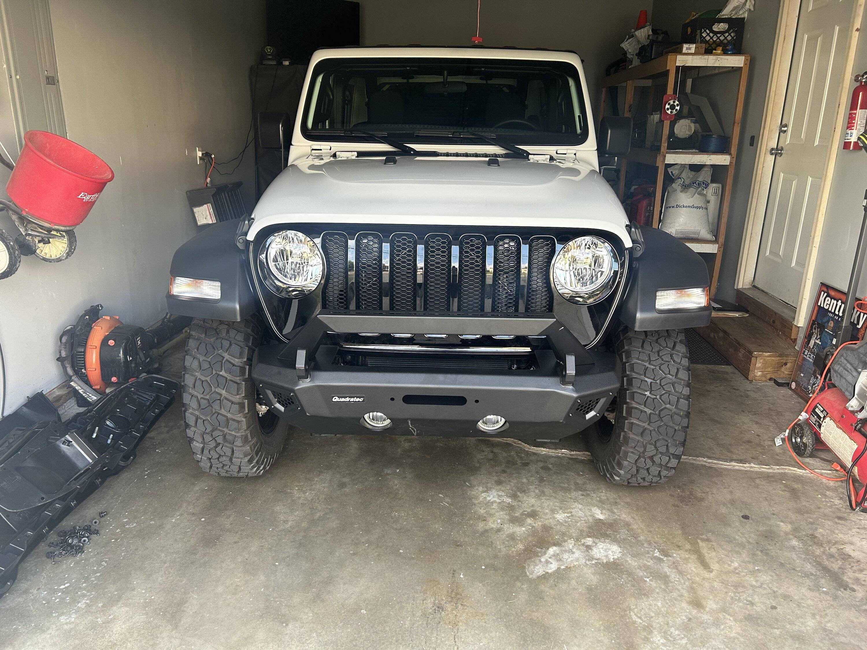

Finally got it on.
I love the look.
I didn’t have any help and it slipped off the jack leaving a scratch on the front but I think I can clean that off. Also a Nick on the overrider.
No big deal.

Finally got it on.
I love the look.
No big deal.
Good job... I know the pains of swapping out the OEM bumper for an aftermarket with winch. Hopefully the winch install won't be as big a headache as mine was. Also if it was me, I would try to lose that Quadratec logo.

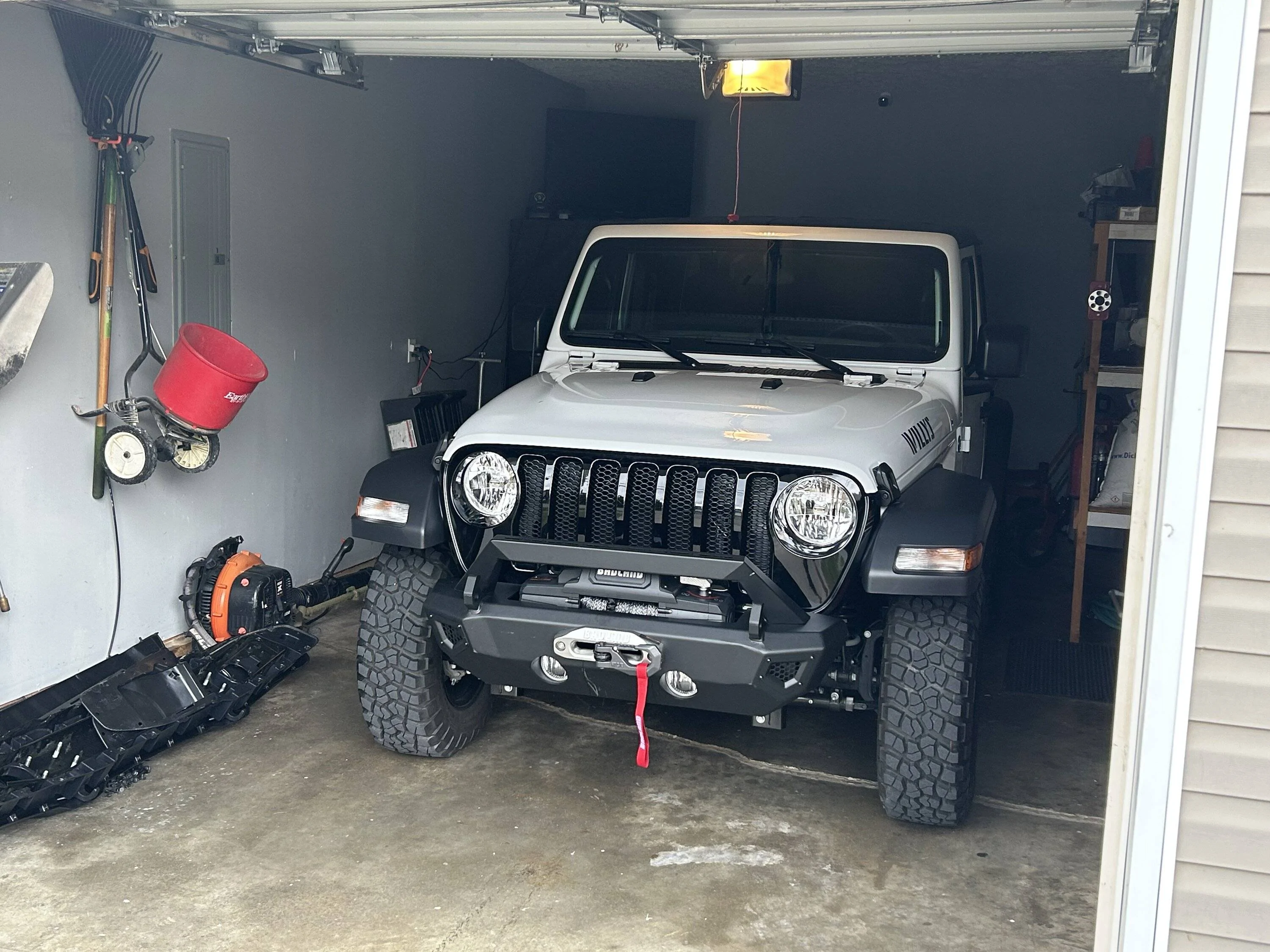

I can't believe I posted the finished product in the wrong thread lmao
Anyway, here it is!
