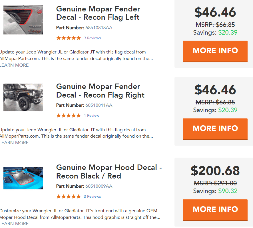

It's great all of you have the confidence to install yourself. You're also probably right - that it's incredibly easy. I don't know what non-OEM prices are but the OEM prices played into my decision. Even having to reorder a single fender decal plus shipping was close to $100 so in my opinion - worth it.

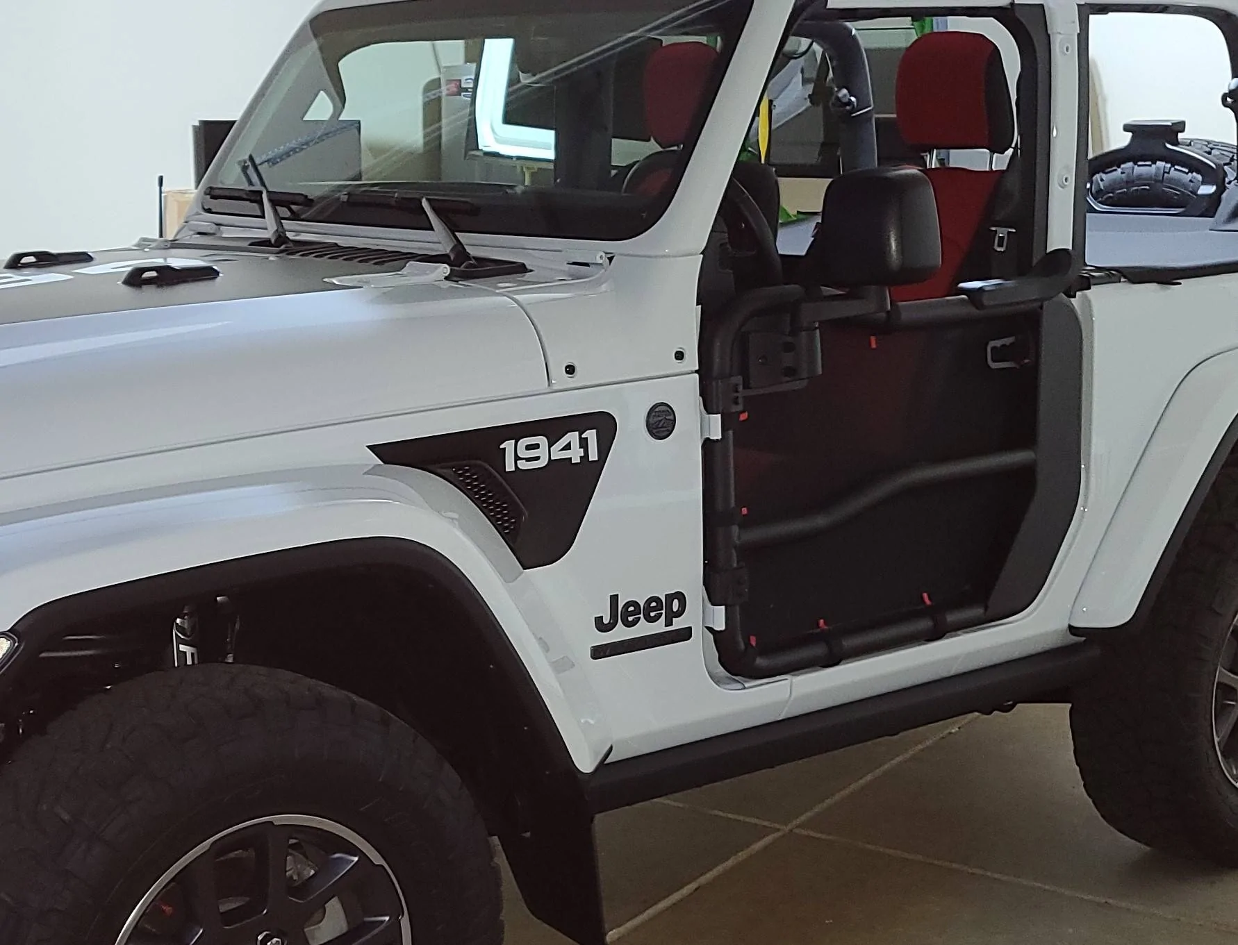

I bought a set and wasn’t sure if I wanted them. So I just cleaned the area and put them on like a sticker. I didn’t use my heat gun or spray. They still look great after a year and went on in two minutes. I will spend more time on the next round, but don’t be intimidated, it’s really easy. Now the hood I won’t do!

Pretty easy install and the only thing you can hurt is the decal. Just clean the area good with alcohol and be patient as you install it. Even if you have some small bubbles, I discovered they disappear as the area expands and shrinks with the temperature.
Jeep Wrangler JL Fender Vent decal 1941 Vent

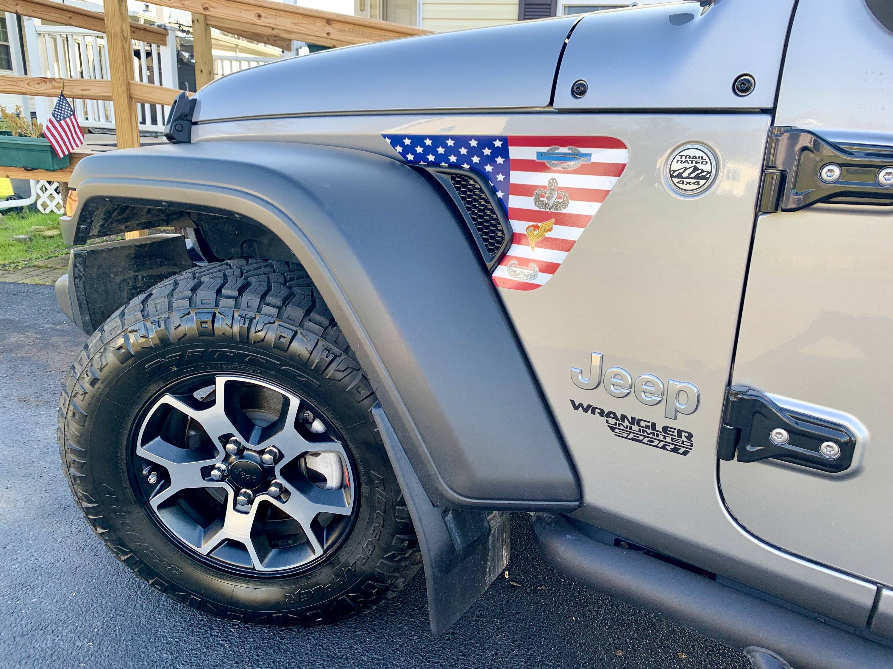

I got mine from Underthesuninserts.com had them customized to add some of my Army Badges. Easy to install, recommend the wet compared to the dry application. Wet application: spray a generous amount of soapy water, place decal, slide decal around to the exact position, Squeegeeing out any bubbles, then leave alone and let dry.

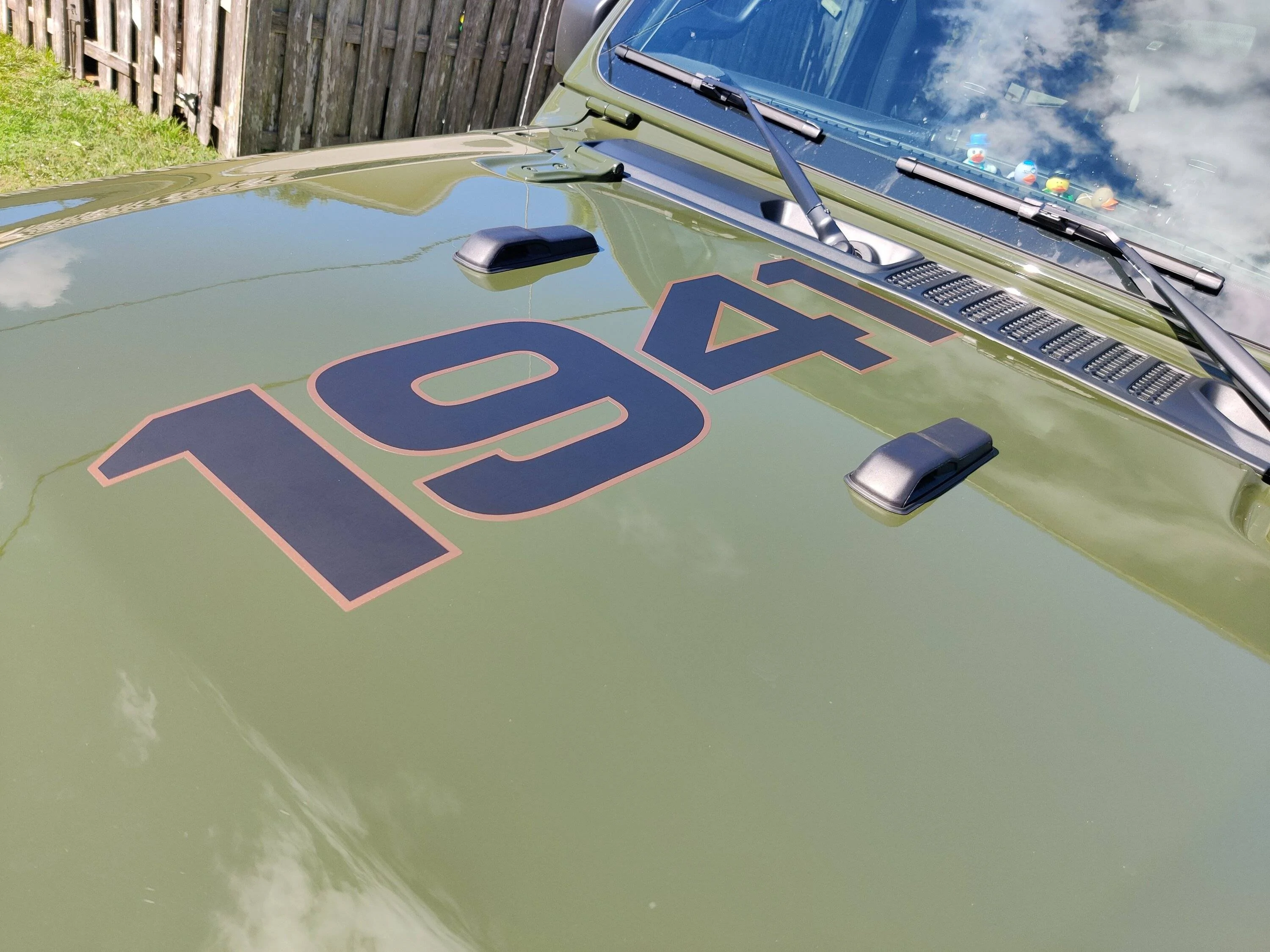

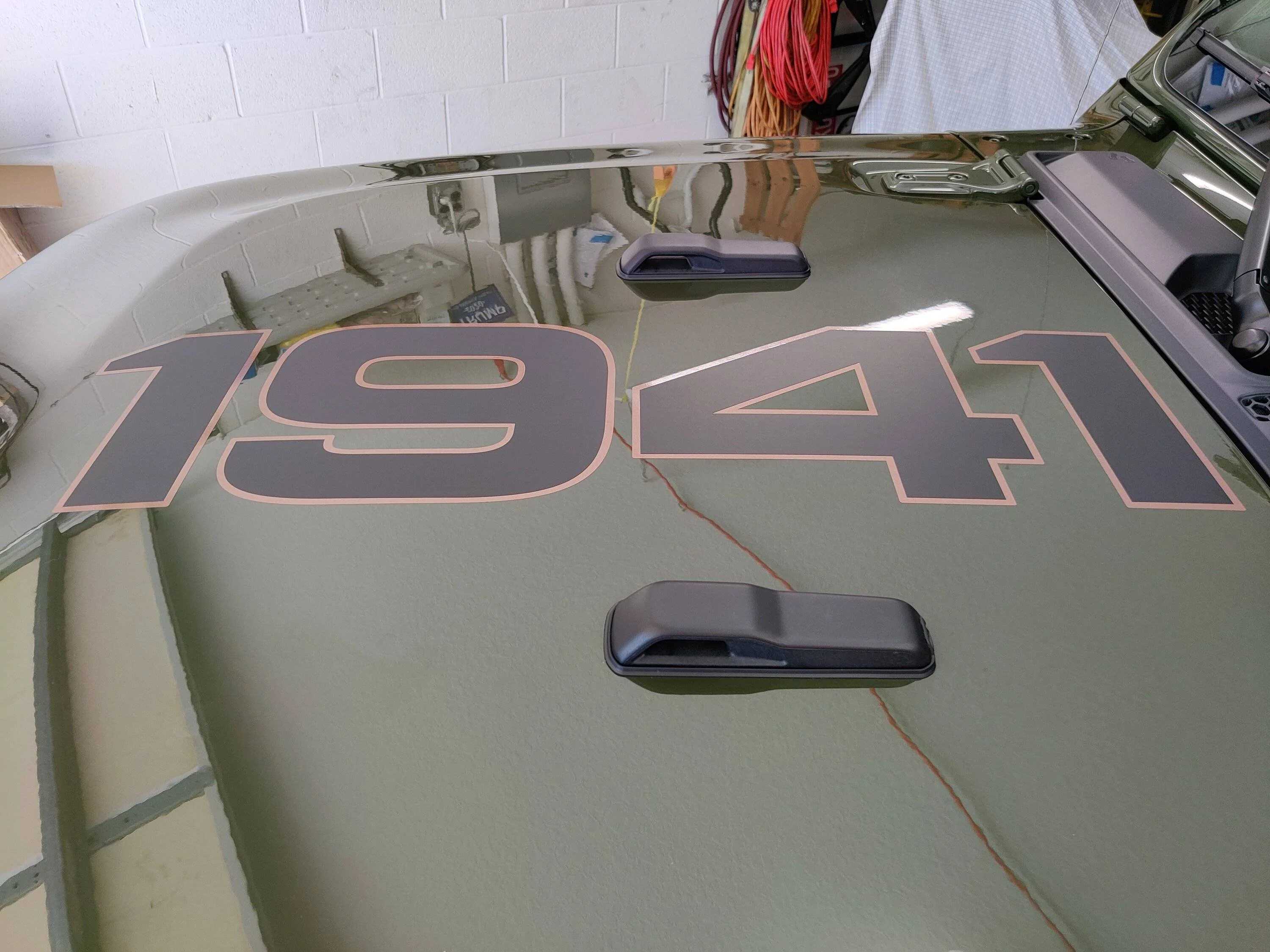

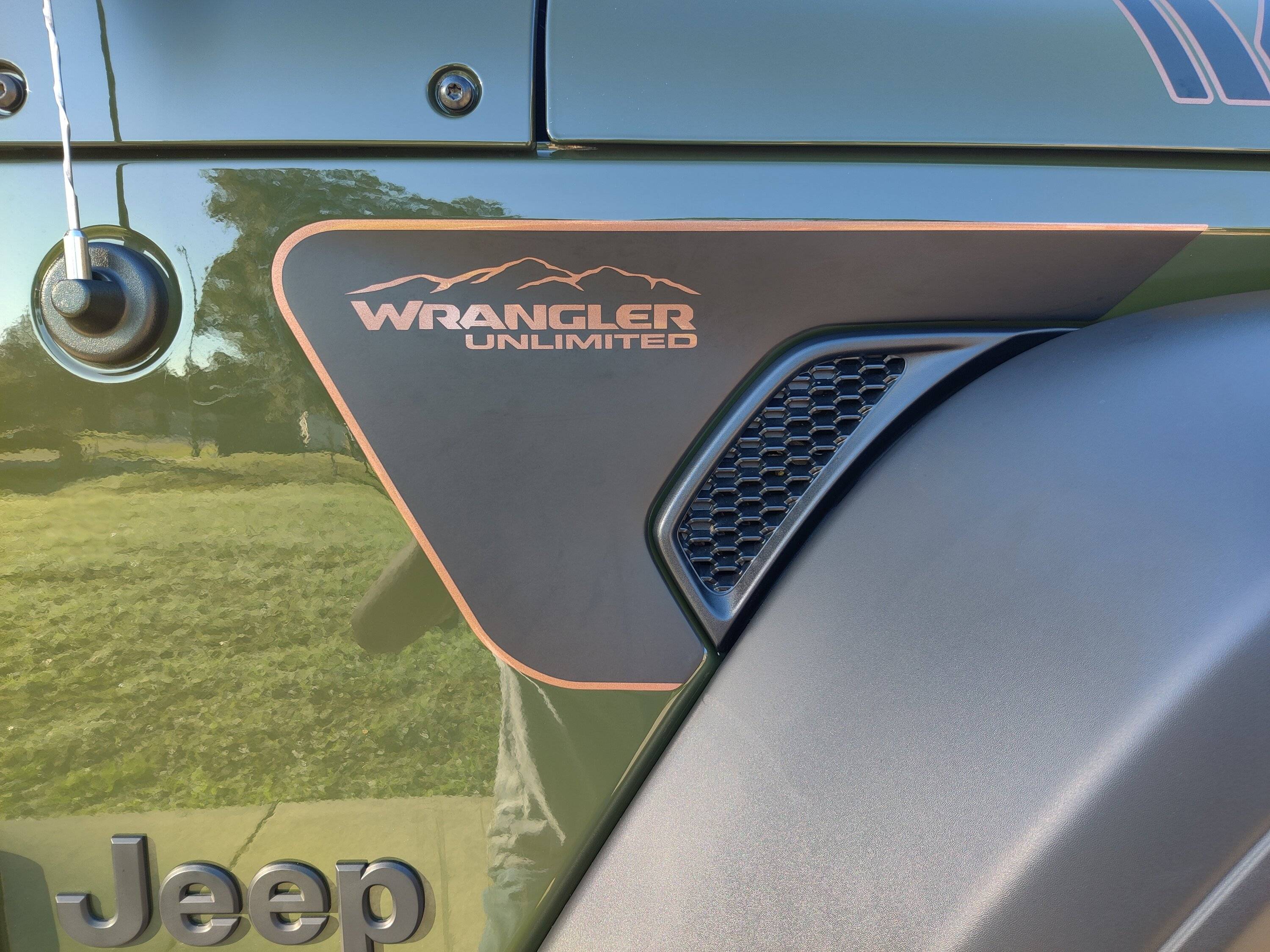

I got all mine from pixel decals. The owner is great and has lots of knowledge about his business. First time ever doing it myself except a couple small stickers.
The hood decal and Willys sticker I did dry. The fender decals I did wet. Unbelievably easy, came out perfect.
