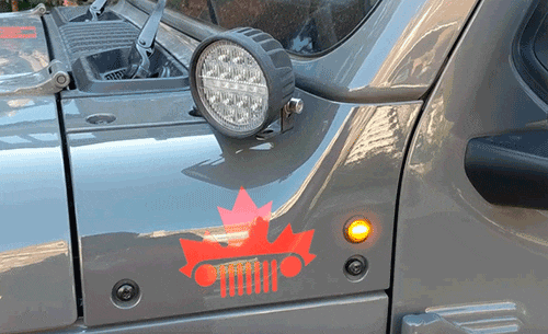

I thought about doing something very similar before I took delivery, but I changed my mind after I saw how little room there was behind that vent. I also considered adding something to the fender, but I went with a cowl-mounted turn signal instead.
I actually really like that. Is that just a 3/4" LED marker light? Any issues with install?
Install was easy on the driver side with access to the wires going to the left fender flare, but the passenger side was very difficult to reach down beside the battery. Electrical diagrams are all in the resource section.
[/QUOTE
Great clean look. Any write up on the install? Where did you tap in? etc.
