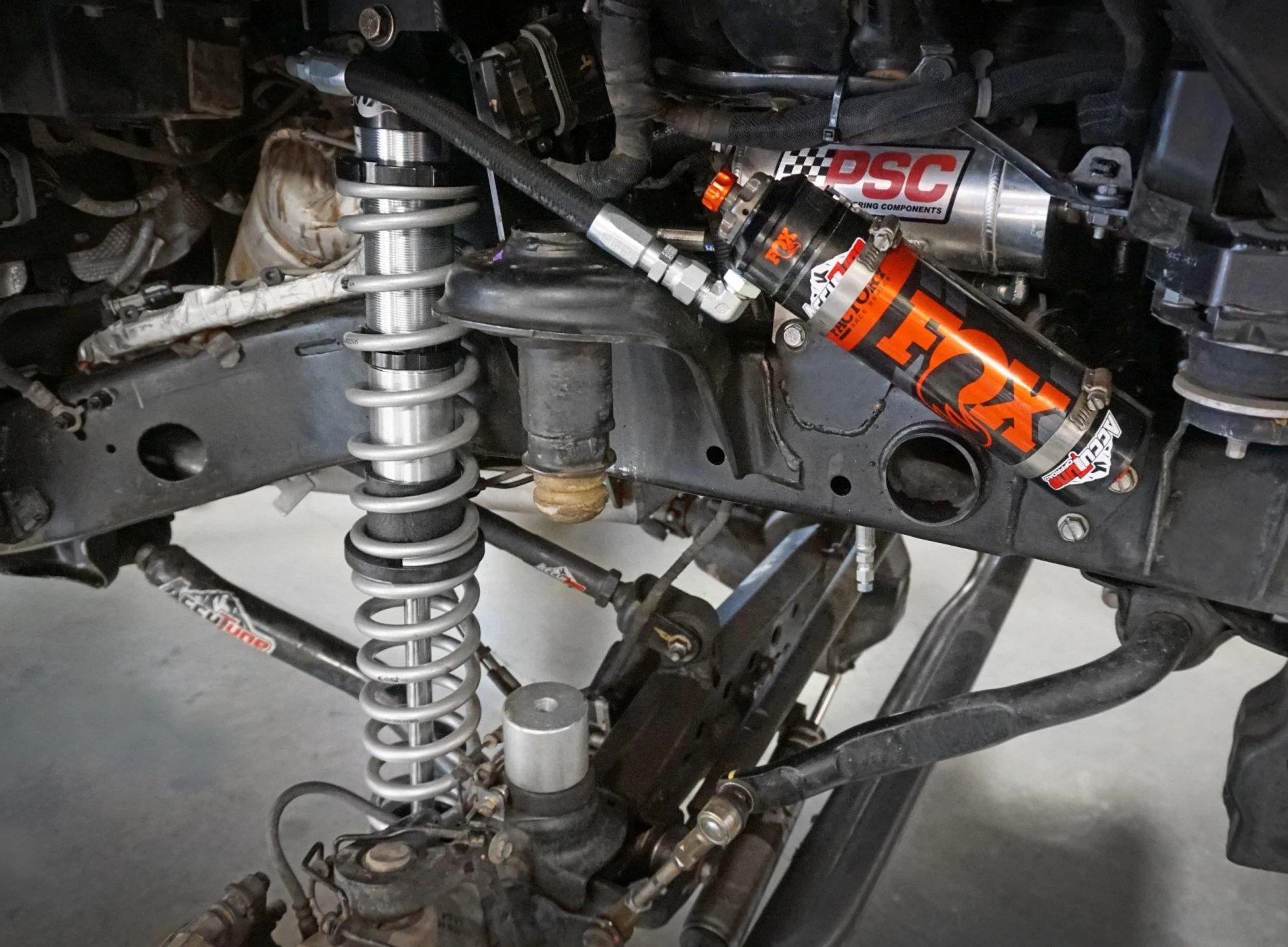

So will see... I hope they can be modified to work with my Accutune 2.5 Fox Coilovers going on the Jeep. I order the ones with the cut for 2.5 remote reseviors in hopes of them clearing with little modification.

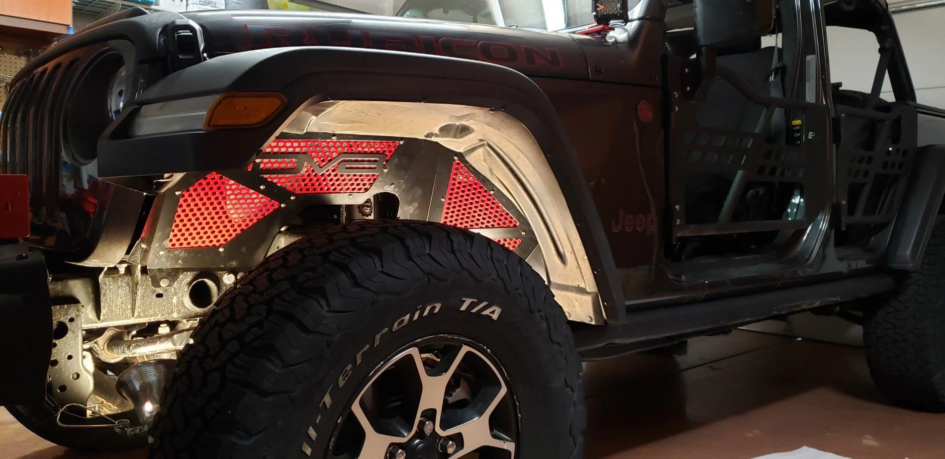

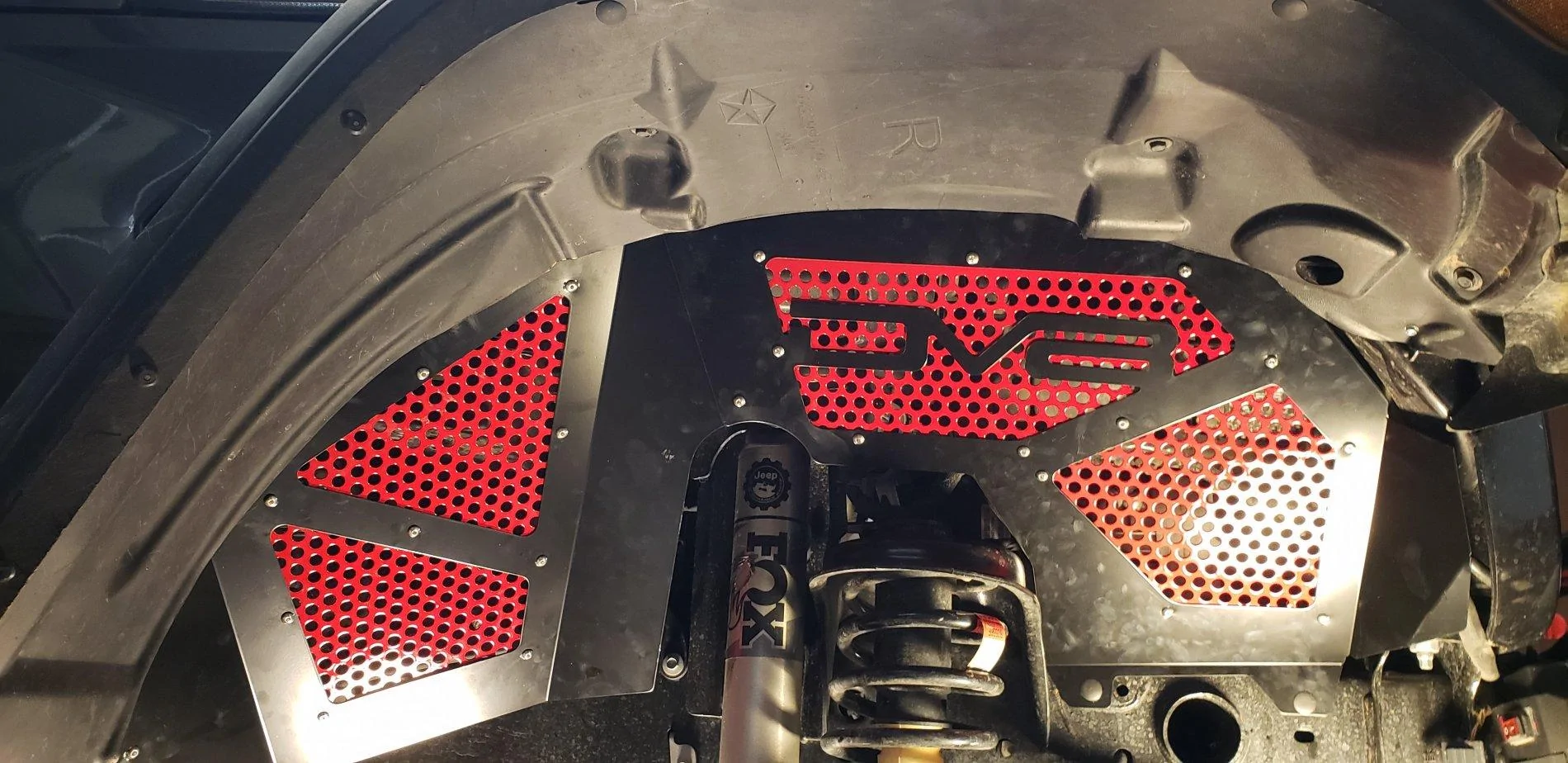

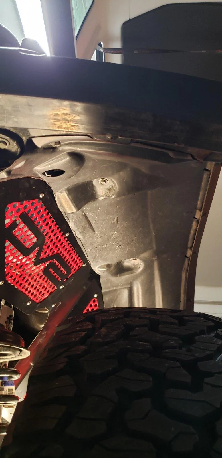

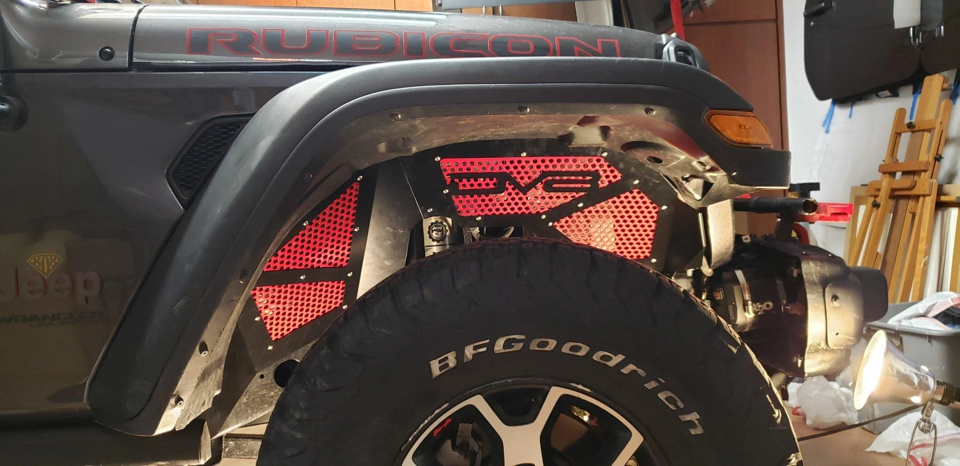

DV8 on my 2020 JLURubicon 2.0T. Takes about an hour to put in. Perfect fit. There are no directions so I made a YouTube video that I will post on my AZRubicon channel showing how to do it.
DO Not throw out or trash out the plastic fenders. You can trim them to fit the top nicely and all screws OEM work.
I decided to paint my inserts red. Four coats of Rust-oleum red, let them cure for 12 hours. Looks fantastic.
There are bolts that came in the package that have nothing to do with the install. Will call DV8 to see what's up.

DV8 on my 2020 JLURubicon. Takes about an hour to out in. Perfect fit. There are no directions so I made a YouTube video that I will post on my AZRubicon channel showing how to do it.
Just to be clear, did you install the DV8 fender liners on a diesel?
