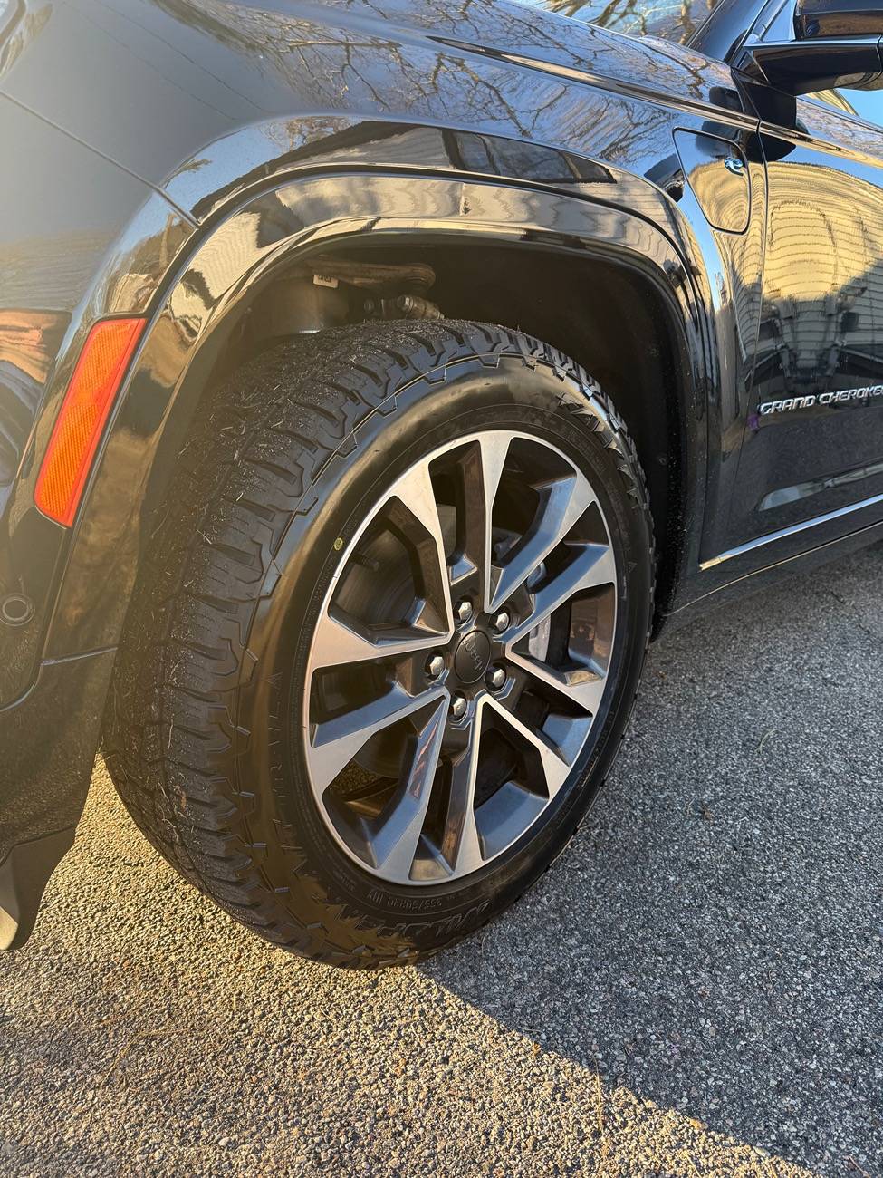

Hey guys! I searched but didn’t see much
my wife’s grand Cherokee overland 4xe has these tires on them and was wondering if anyone has aired down for same/beach driving? If so what pressure ?
If not- any recommendations ?
cheers!

Air down to 20 psi, you’ll be fine. Ran my GC through the dunes of OBX and was great.

2020 Ram 1500 same tires you mentioned aired down to 20psi on outer banks soft sand beach and didn’t get stuck. They are on 20 inch wheels so not great on sand but did the trick. Have same tires on 2018 Wrangler Rubicon aired down to 18psi but they are 17 inch wheels so a big difference. The Wrangler obviously did much better. Wrangler was just in 4X4, no lockers on. Truck had 4X4 and rear locked for the really soft stuff. Truck probably about 800 to 1K heavier.
