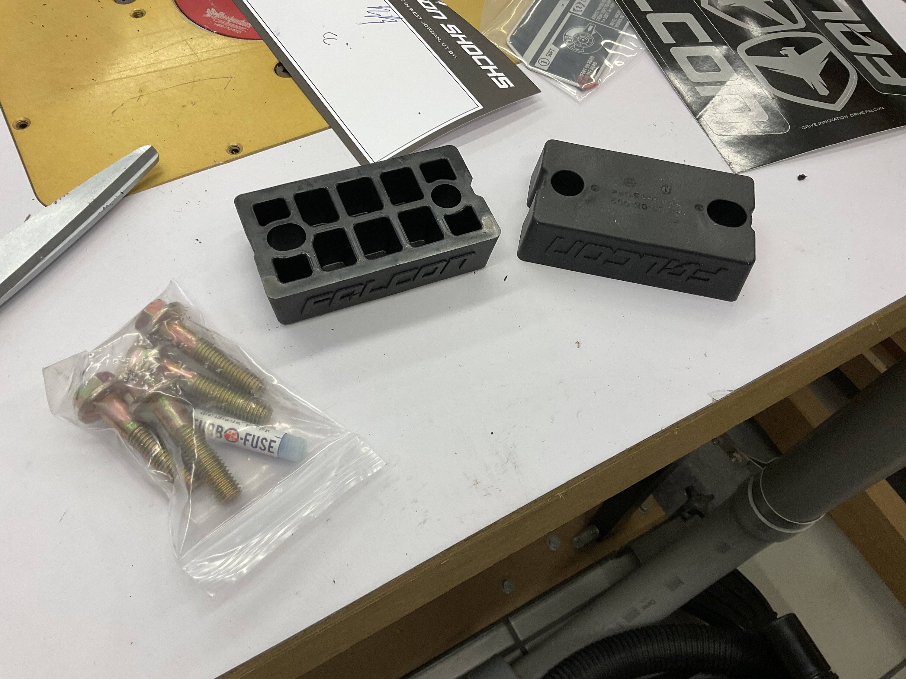

Just replaced the leaking shocks in my 2020 2dr Rubicon with Falcon adjustable 3.3's
The Jeep suspension is almost stock BUT DOES HAVE:
35" Tires
1/2" spacer in the rear to get rid of the squat look.
Install went great.
The new shocks did come with a rear sway bar spacer.
I'm thinking the spacer might be included if the shocks are being installed on a lifted vehicle since they are the suggested model for Jeeps with a 0"-1 1/2" lift.
Is this necessary if my Jeep doesn't have a lift?
I don't see any noticeable clearance issues, but then again I haven't flexed the thing out to verify.
Thoughts?
Thanks in advance!

Those shocks have a lot of down travel and if you droop it all the way out the sway bar may hit the shock. Won’t hurt anything to put them in.
