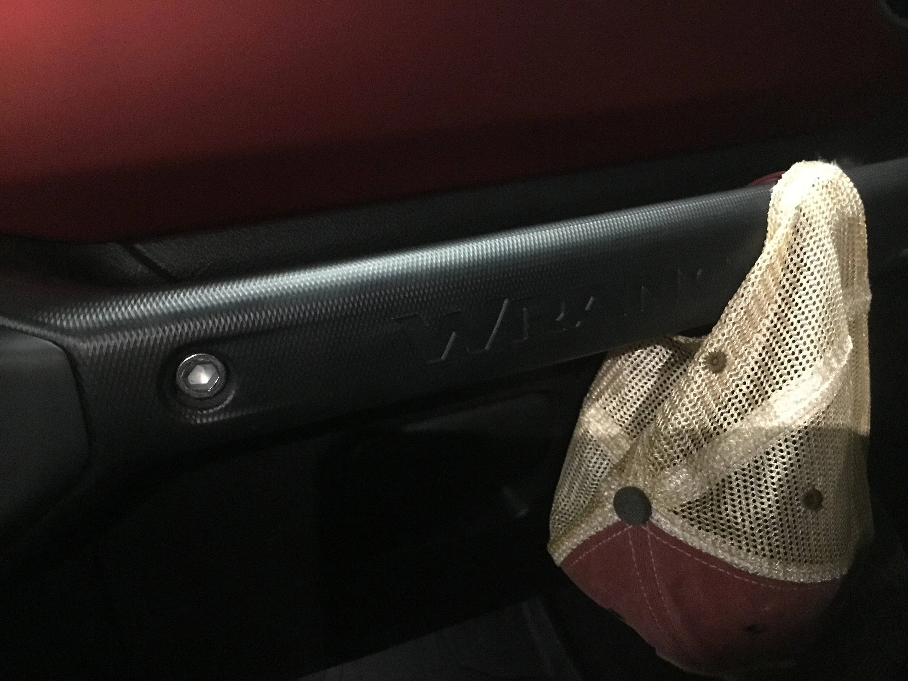

I’ve tried to mount bulletpoint and ram mounts using the exposed silver allen bolts. Mine seem to be decoronly. They only thread into the rubberized material of the handle and won’t tighten down. Both products purchased were specifically designed for this location. Can anyone verify if these are I dead fake/decorative? I was really hoping to use these as mounting points.

18JLUR and the left bolt works with the ball mount, needs some loctite or I need passengers to stop messing with it. Never tried the right side.

Iirc, the thread pitch is weird and you need to apply force to insert a ball mount..
EDIT: Also looks like the cheaper Bulletproof ball isn't a good fit and might not fully tighten down versus the CMM ball..

I have the CMM ball as well and neither one threads into any metal.

Even while applying force/pressure like in the first video?
Yes it’s like they didn’t put anything threaded behind it. Even the factory one doesn’t really thread in to anything
Hmm, really not sure then. Hopefully it's not stripped out. The first video I posted mentioned a black "grommet" sometimes coming out with the factory bolt, which is actually plastic from the countersunk hole. Think he said it was only reported on some early JTs, but maybe something like that would keep the bolt/ball from fully screwing in?
Don't plan on taking my own bolts out until I actually decide if that's where I'm mounting a ball.. and now I'm a little afraid to even fuck with it.
The CMM mount in the upper grab handle on the A pillar seems like a safe bet (probably a different part), since there should be threaded clips behind the covers iirc, but I'm really not a fan of having phone/tablet screens visible to other drivers. Seems like an easy way to get pulled over for distracted driving.
Any chance of getting a camera in there? This is really odd. I've done this on 4 of them, and they all have worked like plain old bolts do.
