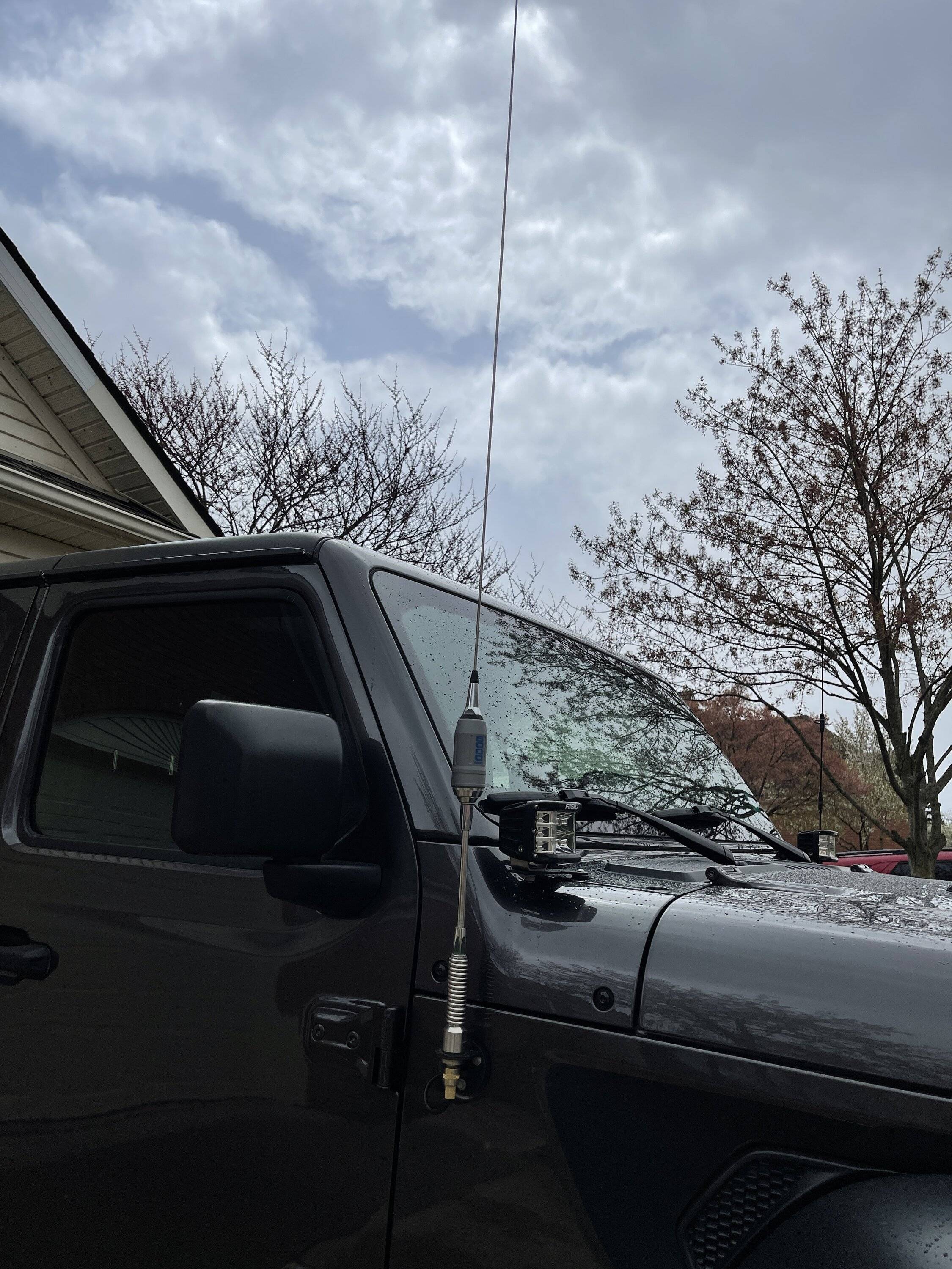

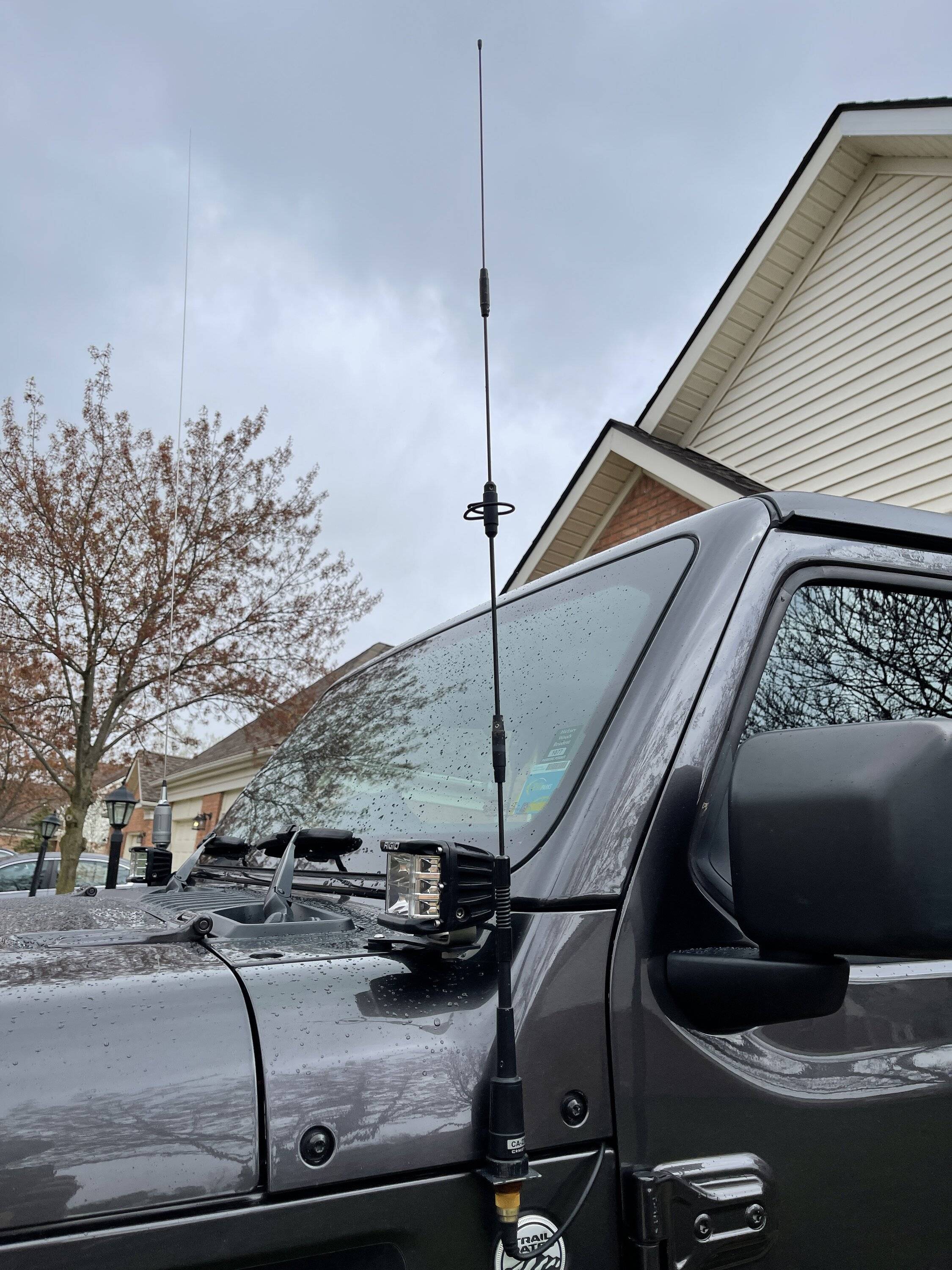

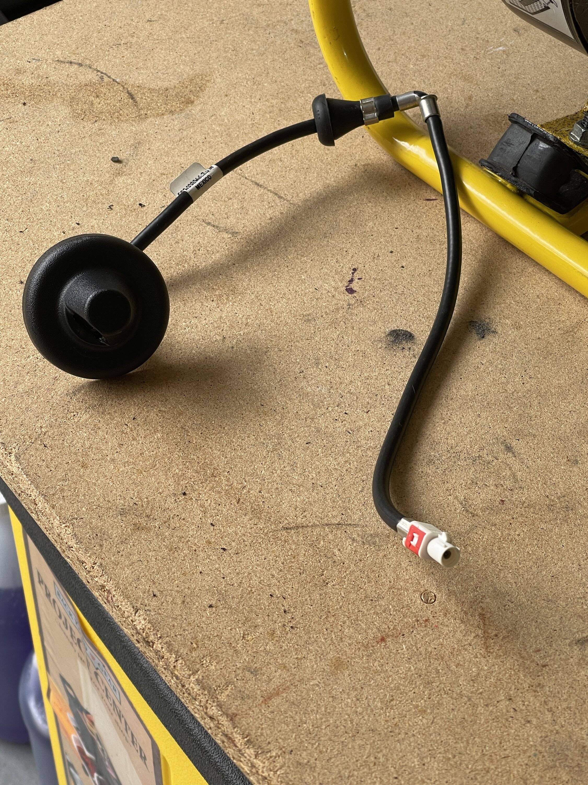

I dug into it to wire up the AM/FM antenna. The threaded coax connector I was remembering was something I added early on when I converted the factory antenna location into a 10m antenna. The factory connector is actually a Z-type connector. I had some Z leads laying around so I was able to convert the Z to a PL-259 to feed a firestik acting as an AM/FM receive only antenna. Significant improvement in noise reduction and reception over the cheap stick on 4” dipole I was using before on top of the sound bar.

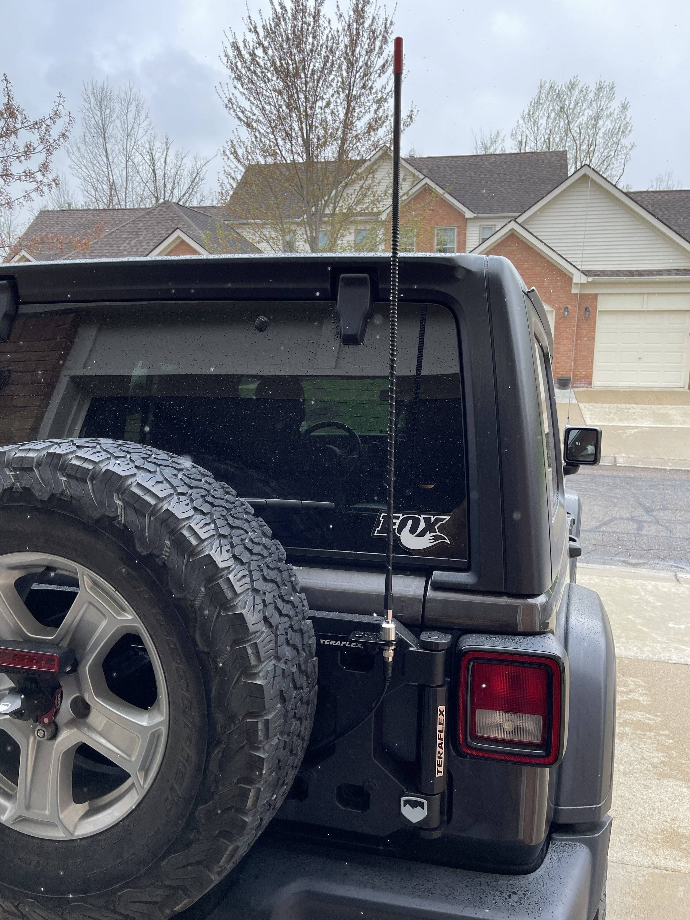

And if anyone was wondering who I’m running a firestik on the tailgate for terrestrial radio, it’s because I’m out of space up front with my HF and UHF/VHF antennas.
