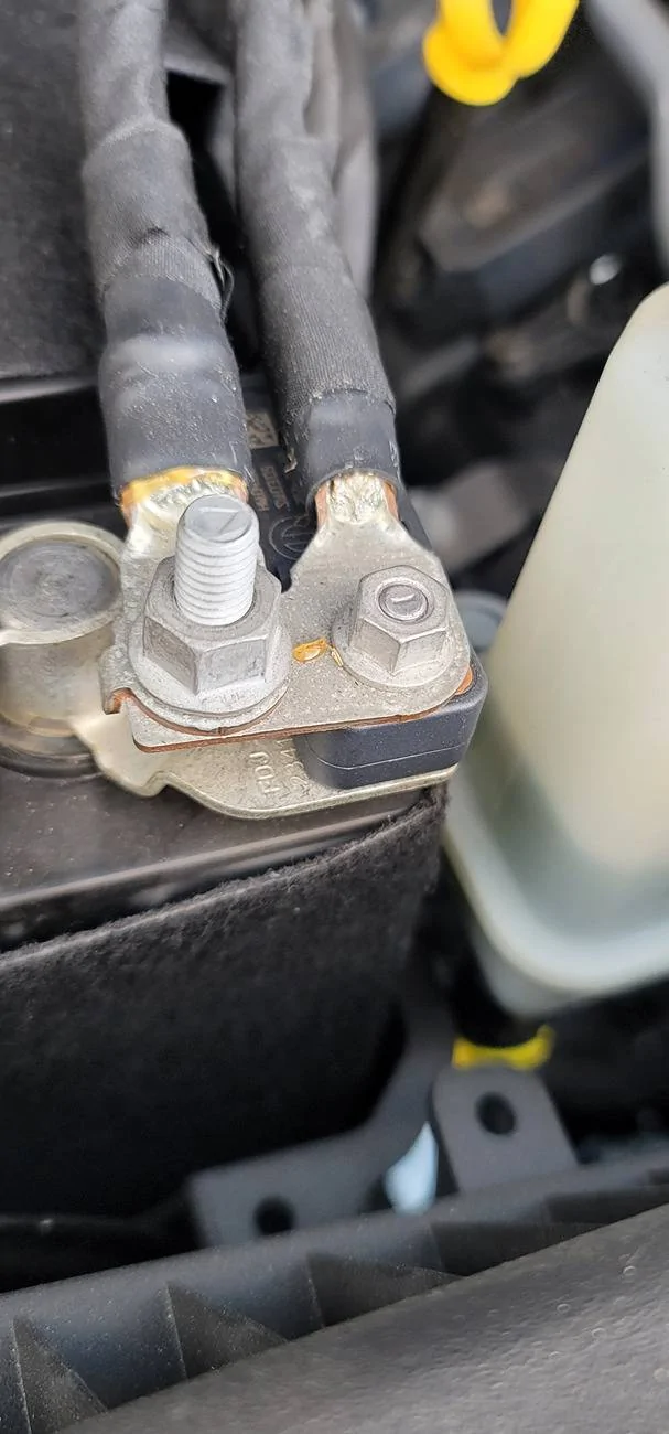

I was preparing to disconnect the negative terminal for the S/S battery and found that the thing is all one piece. F42 is pulled, but what is the trick to separating off the pony battery negative? The two bolts appear to be different sizes, so swapping the large cable into the existing combiner plate appears a non starter (excuse the pun).

The blue highlighted being the body ground, correct?

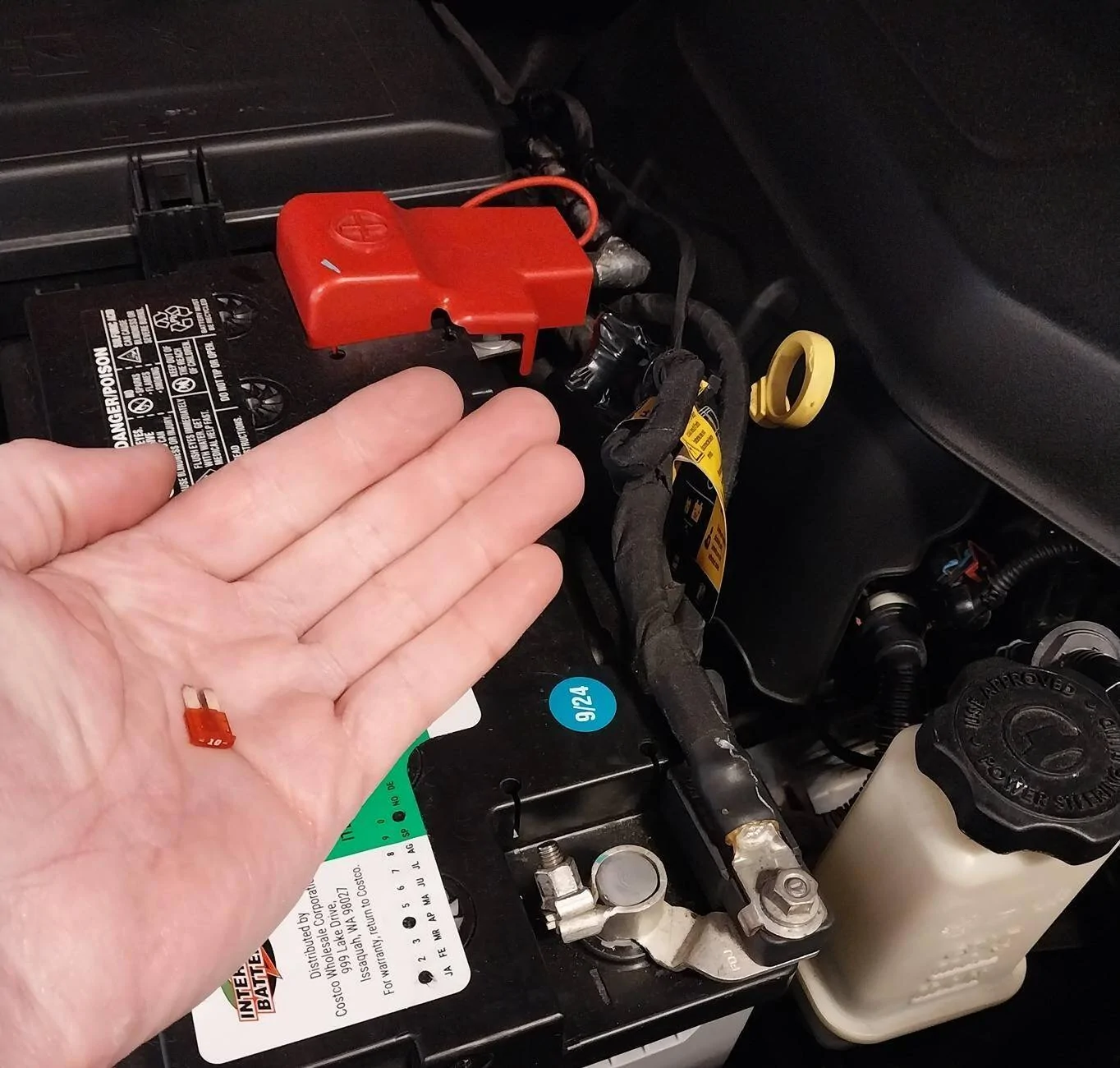

This is what my ESS battery isolation looks like. Yes, the retained, thicker Negative cable represents the primary ground connection for the vehicle. Note also the retention of the Intelligent Battery Sensor.

Apparently the body ground cable will successfully mount to the negative terminal from what I am seeing here. That is what was concerning me. Thanks to you all for the pictures and links.
