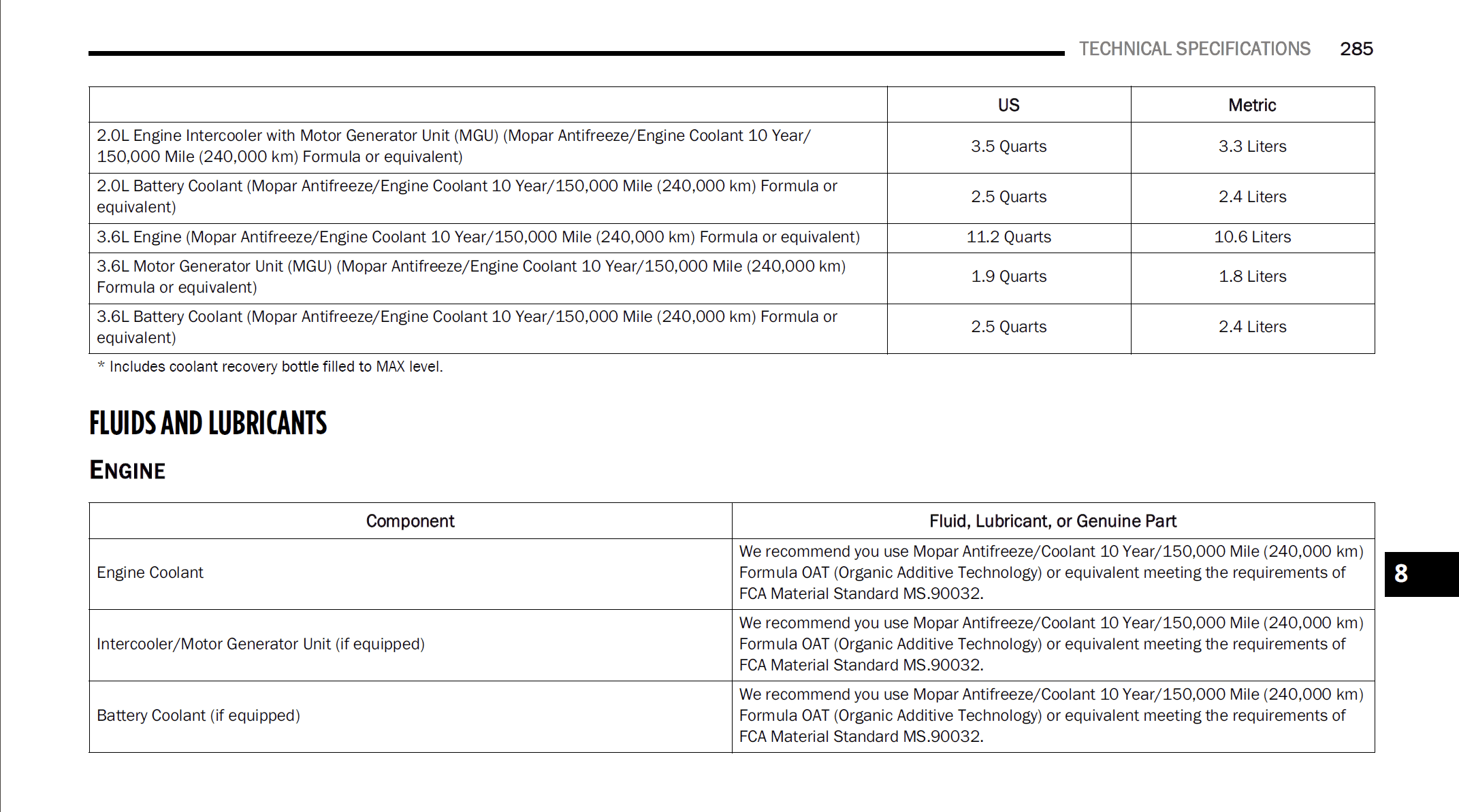

I have really low level on number 7 which is ( power pack unit ) I don’t know which fluid I should add in it I couldn’t find any information anywhere even in the manual it’s self it’s getting really annoying and confusing man ??‍♂??‍♂
Maybe you should go to a mechanic or dealer if you can't figure it out. You'll also want to figure out where it's leaking. But in my owner's manual, it's on page 285:
Jeep Wrangler JL eTorque system maintenance 1693065558856
