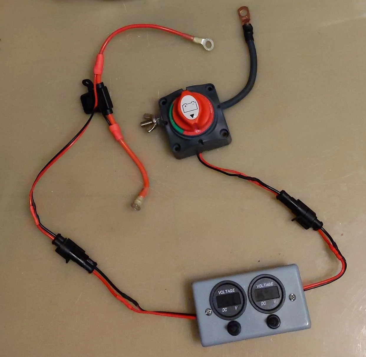

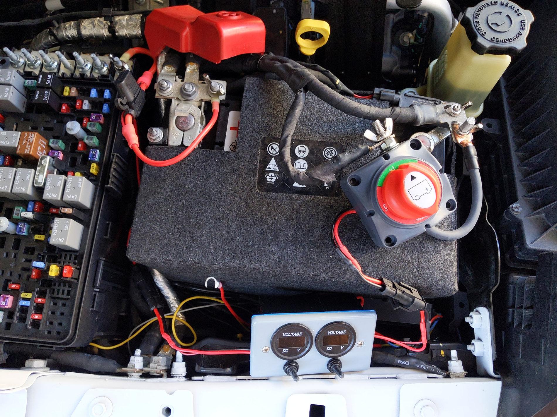

Here's the latest version with updated installed pics. Added switches for the gauges and connectors to facilitate future modifications.
Jeep Wrangler JL ESS Dual Battery Management bmp gauges v2a
Installed
Jeep Wrangler JL ESS Dual Battery Management bmp vs install
Monitoring separate battery voltage.
Jeep Wrangler JL ESS Dual Battery Management bmp v2 seperated
Charging main battery.
Jeep Wrangler JL ESS Dual Battery Management bmp v2 main
Charging aux battery - I left the charger's positive clamp on the main battery positive terminal and just moved the charger's negative cable to the aux battery negative cable.
Jeep Wrangler JL ESS Dual Battery Management bmp v2 aux
Installed
