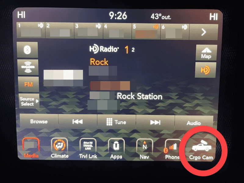

What I ended up doing is assigning the trail cam to one of the uConnect's dedicated button slots. Sure, I'd rather have a clean solution that comes up automatically. But for now, when I want to bring up that front camera view to help with my front parking, it's just a single button press away.
This is actually really smart.
Do you mind sharing what was involved in setting that up / connecting it?

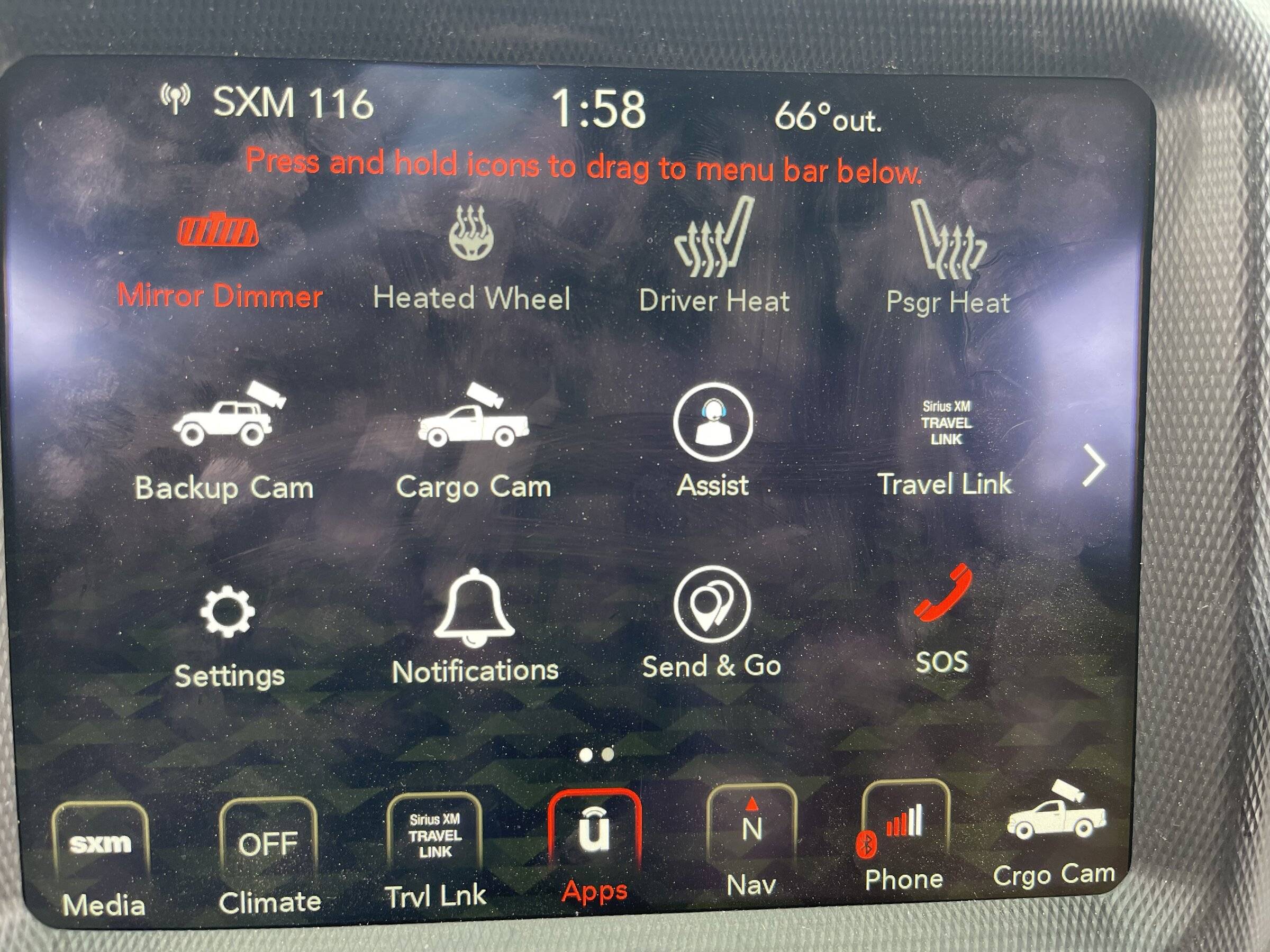

I'm surprised to say that they actually have on-screen instructions!
The only catch is you need to begin by pulling up your uConnect Radio apps screen.
Jeep Wrangler JL Enabling Front Trail Cam at Certain Proximity / Speed? 1652669764894
MOVING A uCONNECT APP INTO THE PERSISTENT MENU BAR:
1.
Go into Apps on your uConnect Radio.
2. Find the application you want to use (Cargo Cam, Backup Cam, Trail Cam, etc)..
3. Put your finger on that app icon and HOLD your finger down on it. DO NOT RELEASE.
4. Wait a second. The icon should start being kind of 'floaty' and able to move around.
5. Keep your finger on the screen and drag the icon down to whichever menu button slot you want it at.
6. Release your finger.
The application that you dragged should be available from that point forward no matter what screen your uConnect (8.4") radio is on.
