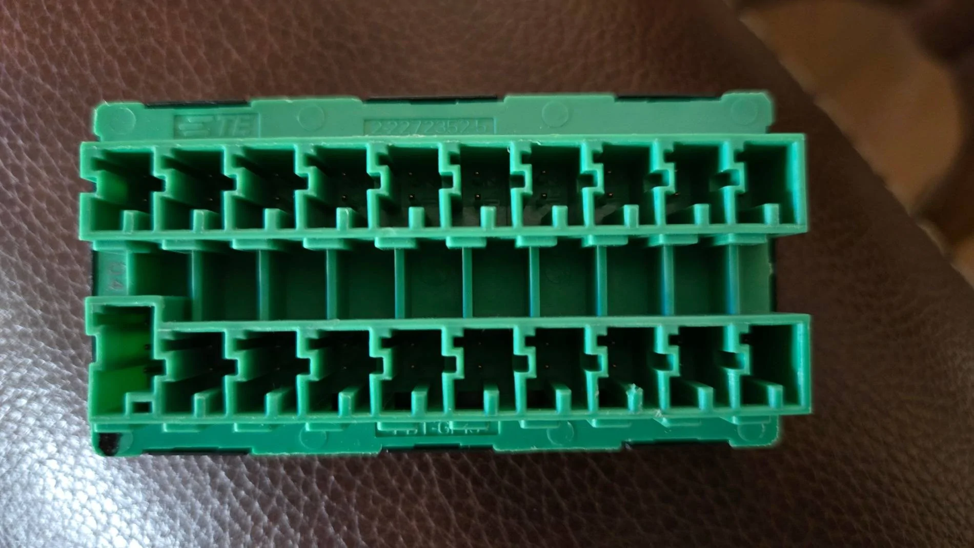

Sounds like the common CANbus connector block behind the glove box? Anyone check that yet?
Tried to add a picture but no-can-do for some reason
That's another common indicator with the connector block might be bad. It's a $10 part (probably an $80 part at the dealer). It can be replaced in about 5 minutes. It's possible it's not the problem but much cheaper and faster than the ABS to check.

Is there an easy way to look at it without using a voltage meter to see if it’s bad? I’ve got a white and a green connector I’m just going to order both and replace them. The circuits on the back look good (says the I’m no electrician man)!!!
Sometimes it's as easy as just pushing the connectors in fully. Sometimes the block might require replacing (voltmeter won't help here). Other time the problem is elsewhere. These used to be a dime a dozen on eBay but they are nowhere to be found today (except the dealer). I wonder if Stellantis bought all the available stock for replacements?
