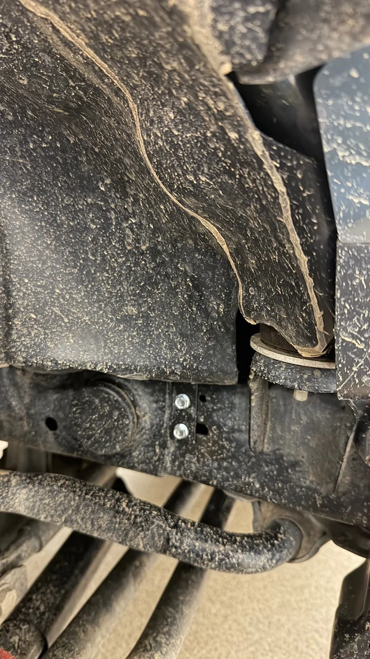

Your electric pump is working overtime, gets hot, and it is the cause of the warning. If it continues to be a problem, then you will need to install a fan.
This is what I did and problem solved. See attached. Credit is due to another member on this forum. Unfortunately I don’t remember who it was.

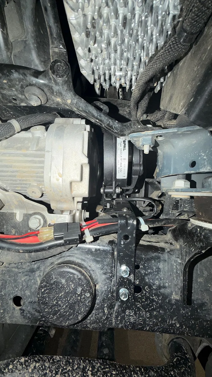

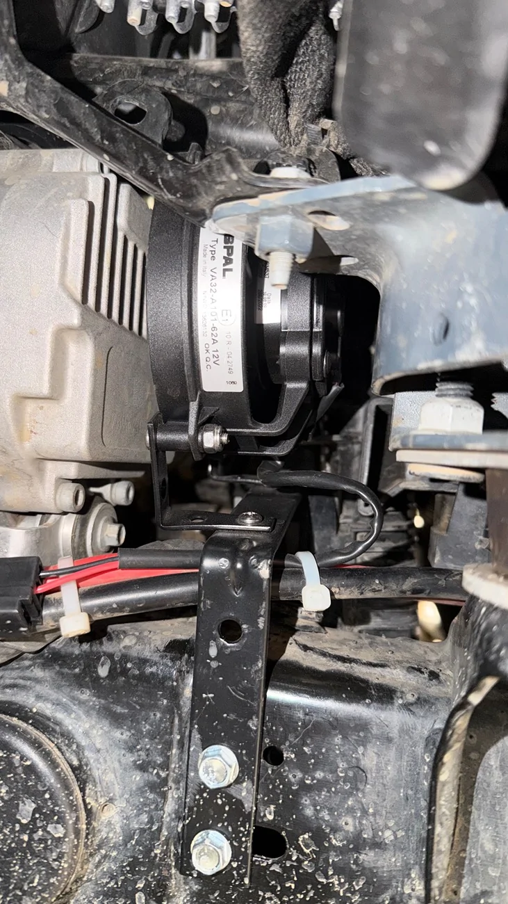

Here are some pix of the fan after install. Be aware that the wiring is installed backwards on purpose so the airflow is correct. You can see the backwards connection in the last pic.
