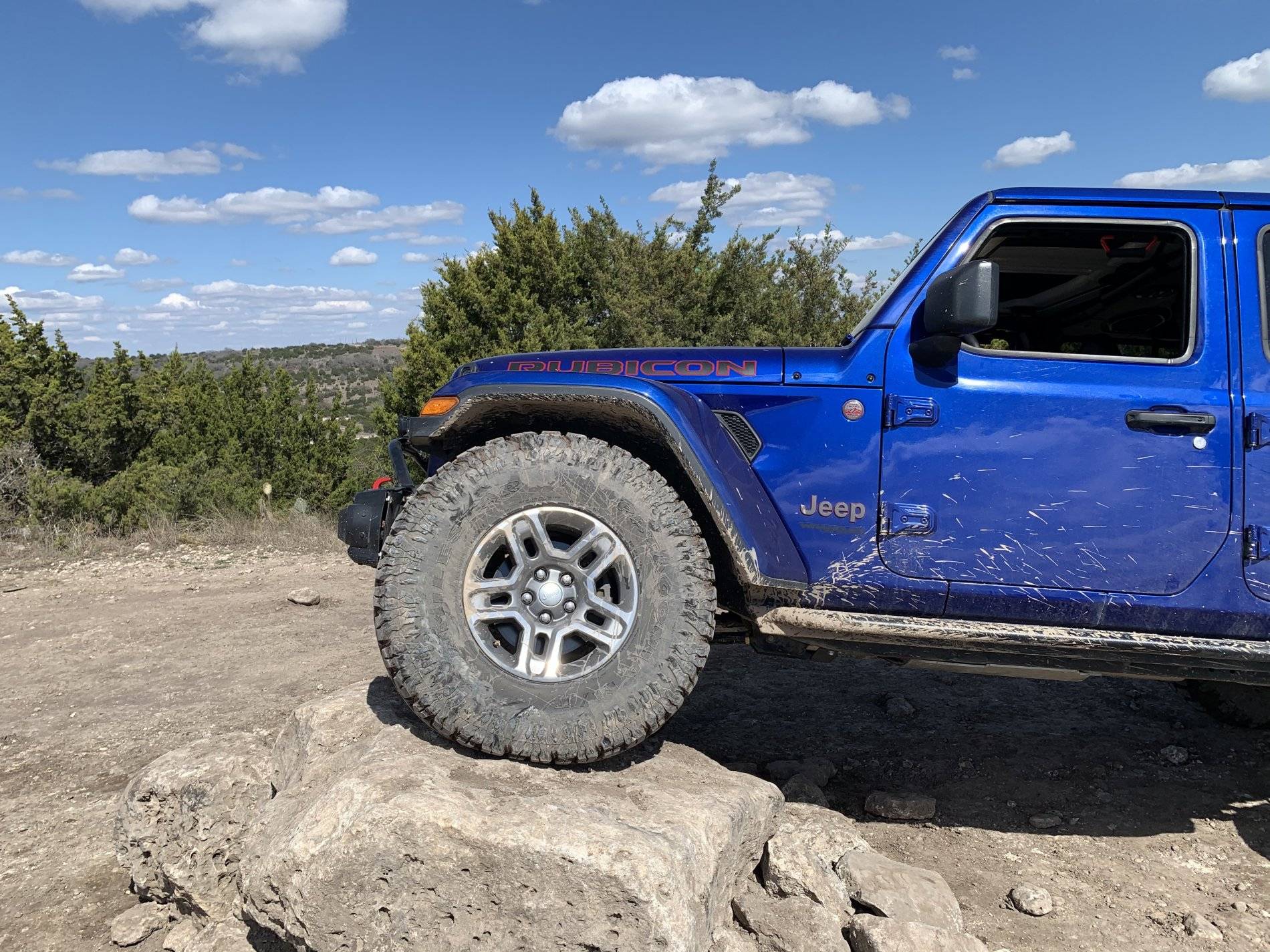

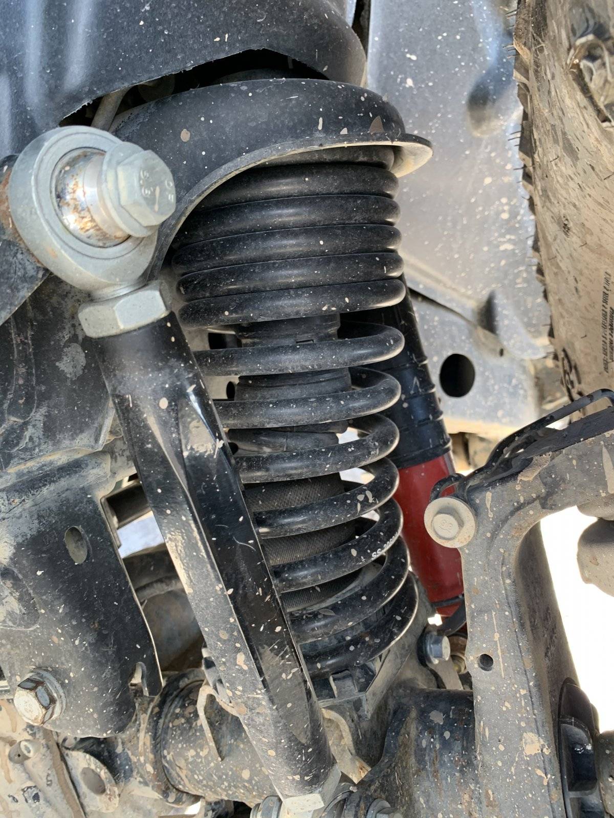

Each corner of the suspension has a bump stop to limit the amount of up travel, or “wheel stuff”, of the wheel assembly. That’s all they do. Without them, or if they’re not the proper height, you could roll over a boulder or other obstacle and your wheel and associated suspension parts would be pushed upward until they hit your fender or body or frame.
