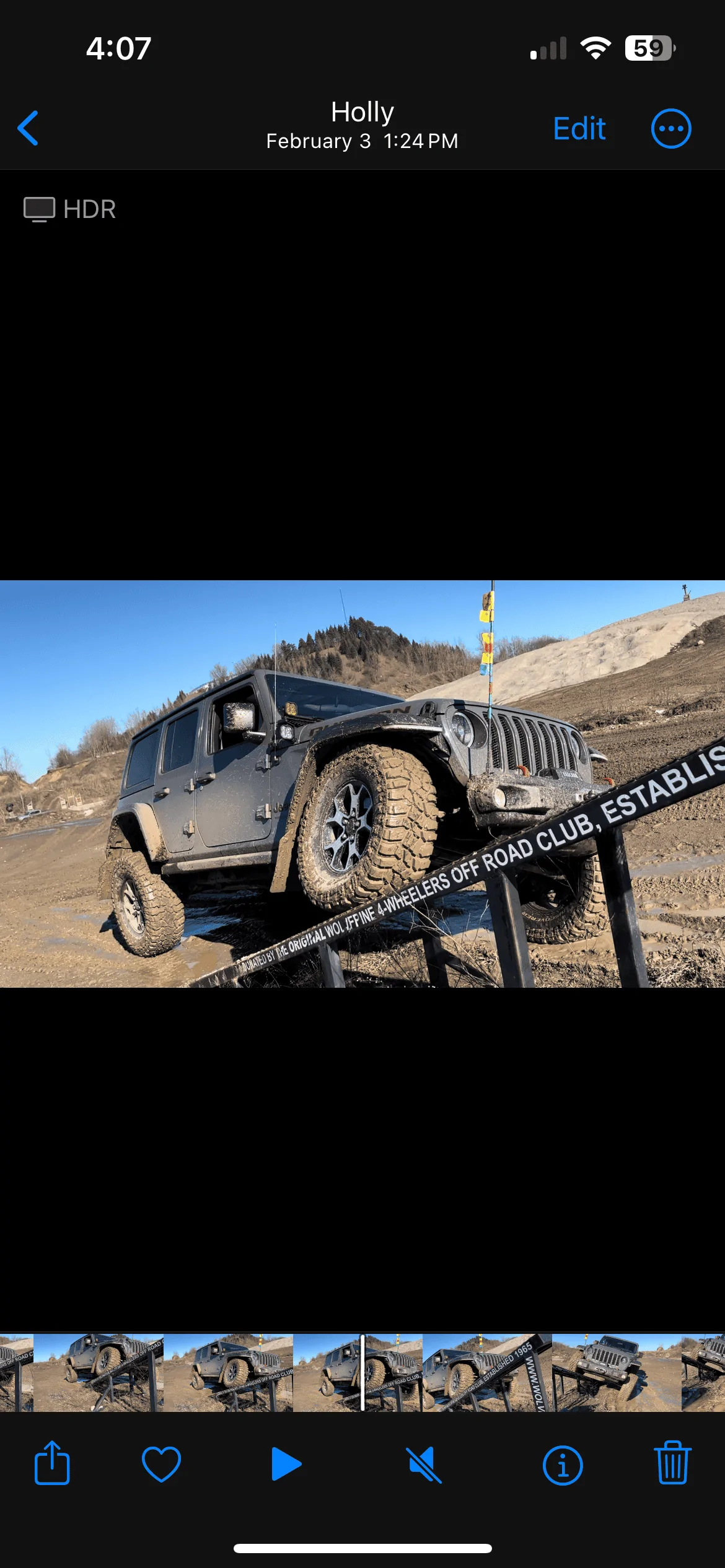

TLDR: but from what I did gather I can tell you I’m running 315/70/17 on stock rims and suspension.
I notice no rubbing and I’ve flexed it out pretty well.
I did not re gear just updated the computer with j scan.
I lost about 2-3mpg other than that everything feels the same!

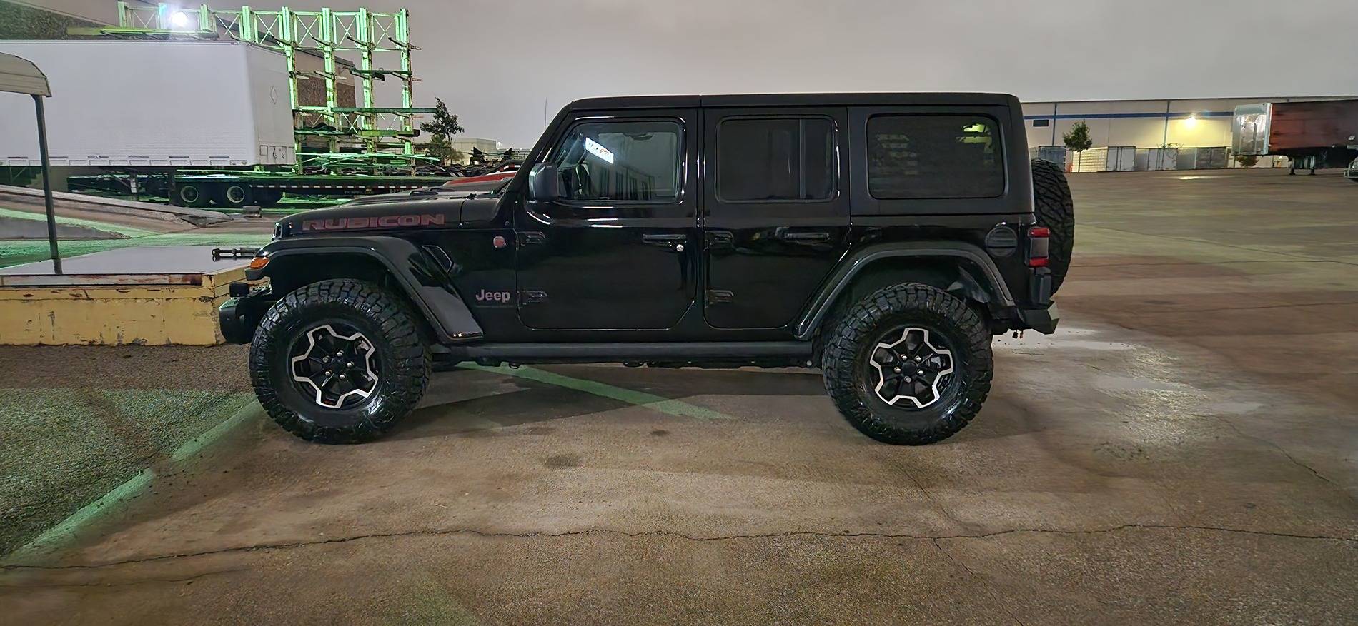

I have a 23 JLRUD. I have a rubicon express 2.5 lift and fox shocks 37” tires with Icon DOT legal beadlocks. I think they are 3.5” backspace. That diesel didn’t care about those 37s. I live in California and just a 1700 mile round trip to Idaho my Jeep was packed full of gear and I got 26.6mpg and the transmission was in 8th gear going up hill. I would build your Jeep and worry about gears last. There’s not much to gain going from 3.73 to 4.10 especially if you plan on running 35s. I forgot to mention that I have heavy bumpers, winch and skid plates. That diesel and 8 speed is the best combo Jeep ever put in a wrangler
Thats good to know. Good to know it can handle it just fine. Thanks!
Did you recalibrate your speedo with 37's? If so, how off was it and what did you use?

I think it was reading about 10 mph slow. I used the tazer mini to recalibrate and disable the ESS. These Rubicon’s with the high line fenders don’t need much lift. I drove mine for a week on 37’s and no lift. Like I said I have 2.5” lift and it doesn’t rub. I don’t like how they wonder around on the highway so I didn’t go crazy with my lift I could set my caster at 8 deg and a Hellwig rear sway bar and mine is one finger on the wheel at 80 mph all day. I’ll try to figure out how to send you a picture of mine

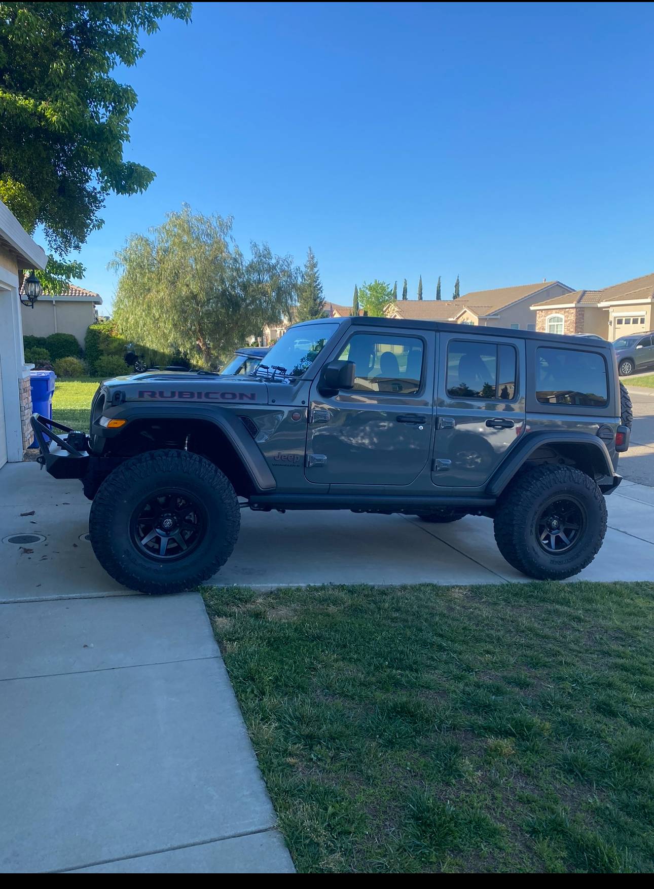

Speedo mis-calibration is always a percentage, in general you can use the diameter change as a guideline:
33 -> 37 = 37/33 = 1.12, so 12% off. You'll be going 28 when it shows 25 and 78 when it shows 70.
JScan or Tazer are common ways to correct the data point in the computer to recalibrate. You also want to lower your TPMS trigger as you'll normally run less air pressure in the larger tires.

I've been wondering this for a minute myself. 🤔
The weight of the EcoDiesel isn't enough to actually matter.
-2021 Jeep Wrangler Unlimited Rubicon curb weight: 4,160 lbs
-2021 Jeep Wrangler Unlimited Rubicon EcoDiesel curb weight: 4,449 lbs
300 lbs isn't enough of a difference to matter. I mean if it did, I wouldn't have been able to upgrade to my old steel front bumper, and winch over the factory plastic one I had before. I will say, it did create a slightly positive rake, but something I end up fixing with coil spacers. 🤷‍♂️ BIG WHOOP!
So I ask, is there anything other than 300 extra pounds up front that would actually stop someone from installing a non-diesel lift on their EcoDiesel Wrangler?
If the only difference would be upgraded coils in the front, it wouldn't massively open the amount of options out there for EcoDiesel Wranglers!!
I've got the Rubi steel bumper and the Badland Apex 12S winch up front as well, after swapping out the crappy plastic bumper, so yea, I've got a bit of the positive rake as well. I just added 35s, to stock suspension, and it's ok. I'm considering the Teraflex STI 1.5" spacer lift for $300, but that's not really gonna add anything to the flex, just picks it up a bit. It should (according to their website) fix the rake.
