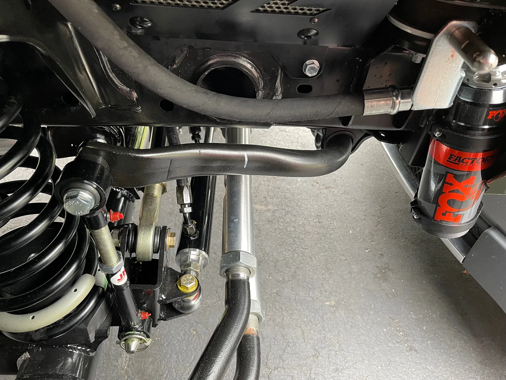

Nothing beats not laying in the dirt or mud after a long day of wheeling, trying to shove a QD on to it's lower mount while fumbling with the pin (that you will drop just out of reach at least once). Apex autoLYNX for the win. Have had mine for several years now and they are quick, easy and utterly bulletproof.
Jeep Wrangler JL Easiest quick disconnects to disconnect? 20240105_132952
As far as overkill, here's my philosophy;
Spend money on your rig where it makes either the vehicle better, your life easier or both.
Mine is not a high end rig by any means. It's a humble 2 door sport s. But when modding, I always try to go at least one level higher components then it really needs. Both for performance and - more importantly - longevity/durablility.
Cry once, spend once.
It's why I put replaced the ball joints with Metalcloak's instead of stock or even the slightly less expensive Dynatracs. For an extra $200, I know I have, imo, the best design and something that will outlast my rig.
Peace of mind is a wonderful thing.
