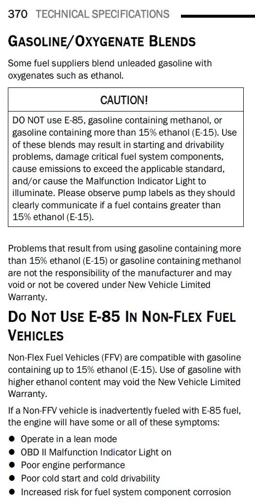

Dealer said they'll run codes but are a month away from service appointments.
I'd be very careful about taking it to the dealer for that. It states very plainly in the owner's manual that any issues caused by running E85 are not covered by the manufacturer (probably incl. diagnostics) and that it may void your warranty. As @GMONEY said, keep diluting it down with premium (or pump it out) and hopefully the lean/limp mode codes should clear themselves. Drive like a grandma in the meantime.
