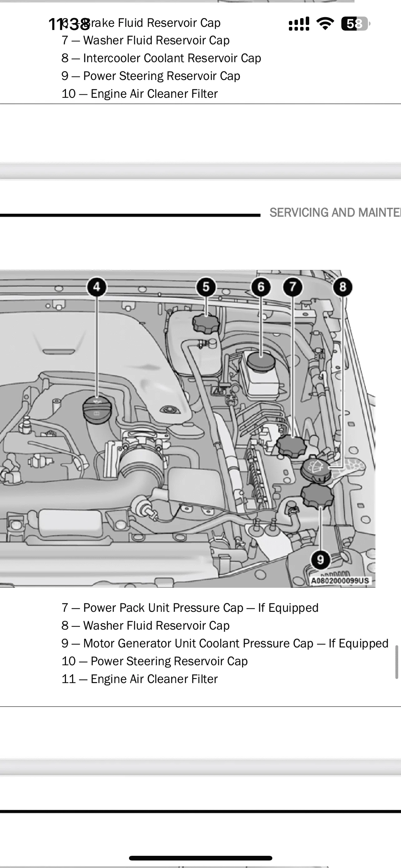

Number 7 in the pic

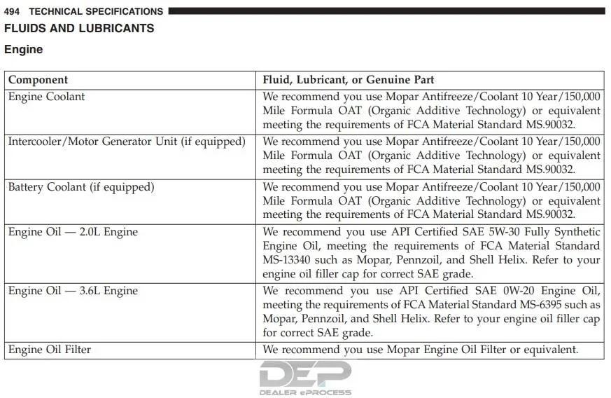

I'm almost certain that both the MGU and PPU use the exact same Mopar OAT MS.90032 antifreeze coolant. On page #493 and 494 of the 2018 Wrangler owner's manual (with both 2.0T eTorque and 3.6L eTorque specs) it distinctly lists "battery coolant" separately from the MGU coolant. Since the generator/MGU is listed and no other batteries on the vehicle are liquid-cooled, the power pack unit (PPU) should be the battery mentioned here.
The OEM part number for the coolant should be 68163849AB for 10-year 50/50 premixed.

Okaay i see , so you mean 5 & 7 & 9 all of them are using the same coolant fluid I guess?

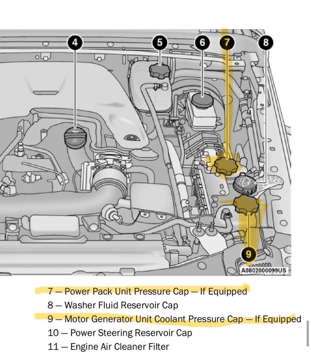

Has anyone had trouble getting the caps off #7 and #9 (see pic) to add more fluid? Ive tried pushing and turning and all it does is click.

There is a small slot on each black caps. Align the slot to another slot underneath. Then put a flat head screw driver into slot, turn the cap
